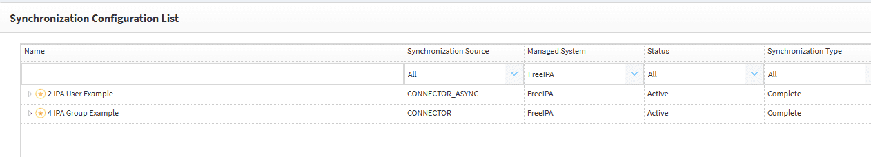

When performing synchronization via connector, one might see the different synchronization sources for connectors synchronization configuration, like shown in the screenshot below.
Connectors configuration list
