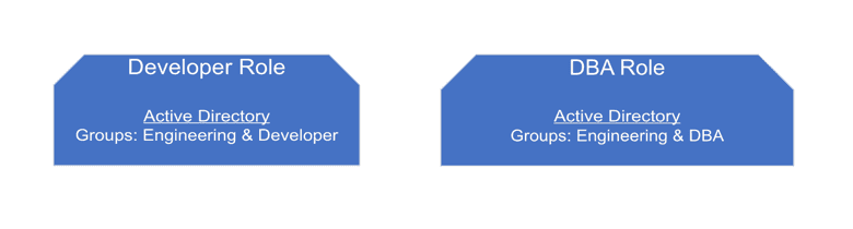

From the example above, we can see commonality between users in the same type of job, but we also see some variations which in this case are the result of location and specialization. There are some obvious roles that we can extract from this simple example. The most obvious roles are shown in the diagram below.

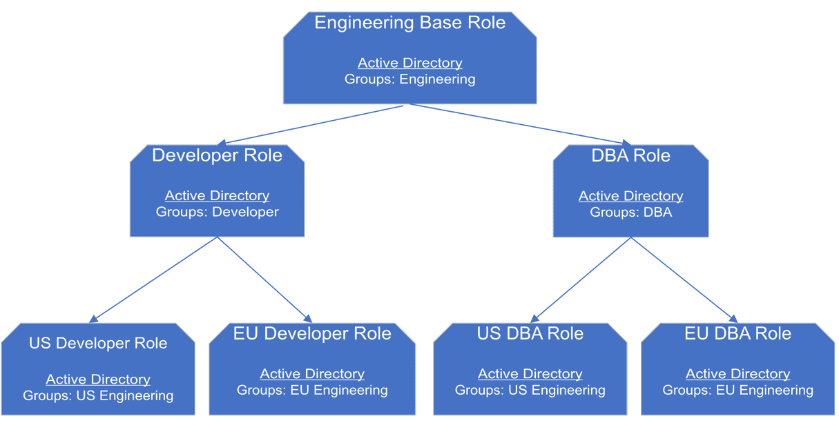

Role design based on inheritance
The diagram below approaches role design using inheritance.
While we have greater coverage than in our first iteration, several parameters are still not included in this design. Further, we are starting to see the number of roles starting to grow quickly.

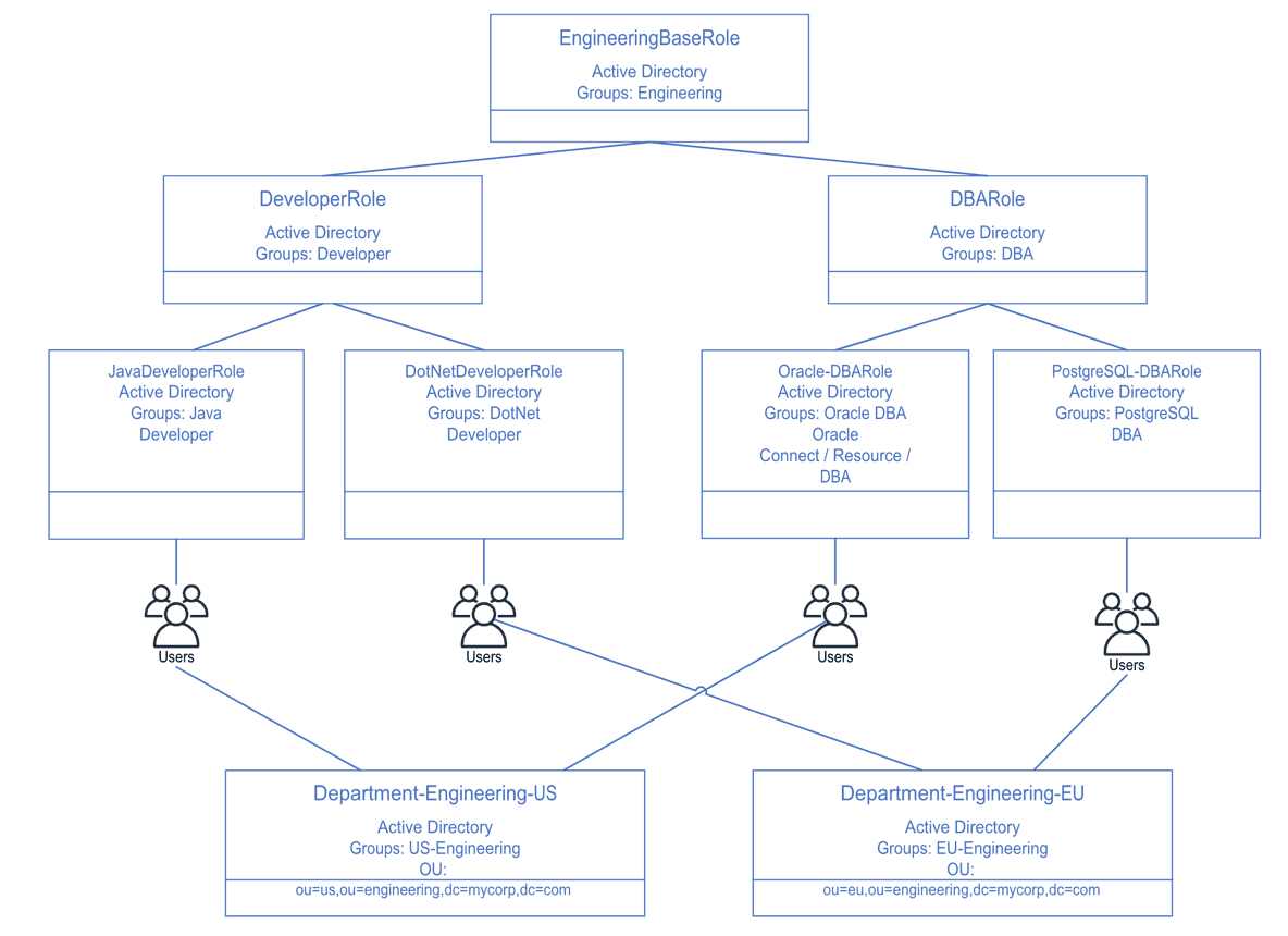

Hybrid role design
Since OpenIAM supports users having more than one role, a hybrid role design which leverages location and job function may prove to be more flexible than an inheritance only design. Since some of the access in our example is based on location, we can introduce an organization object into our design as shown below.
The role model above introduces two department (organization) objects which are used to define entitlements which are associated with location. These two objects remove four (4) roles that were defined in our second iteration of the model. Moving the location part of the design to another model allows introducing job specific roles such as Java Developer or Oracle DBA without having to account for the location. In doing so, we avoid a potential role explosion problem.
