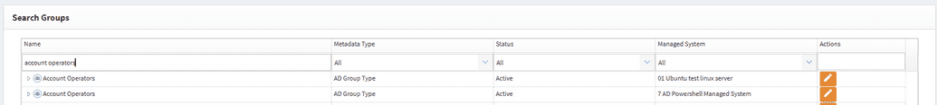

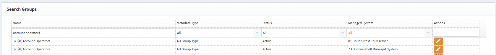

Synchronizing objects with non-unique names
There may be cases where you need to synchronize objects that have the same name, but belong to different managed systems. A common example of this scenario is synchronizing groups that share identical names.
If synchronization is configured to match solely by name, the system will not be able to distinguish between the two groups and synchronization will fail. This is because, as of now, the synchronization engine does not support matching based on multiple fields directly.
To address this, you should use linked attributes, such as a combination of name and managed system, where the managed system acts as a unique identifier.

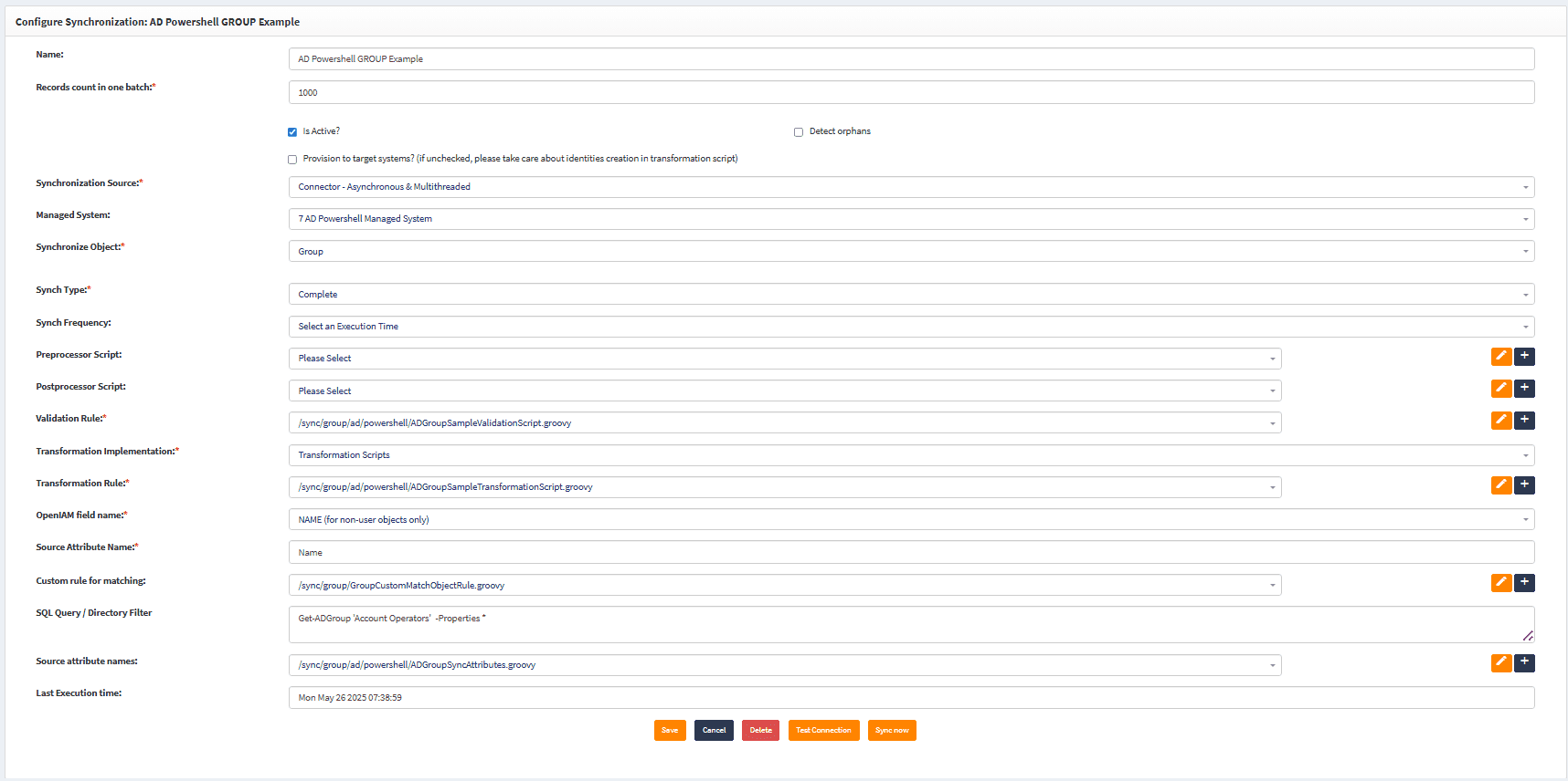

There is a custom matching script is provided to solve this issue - /sync/group/GroupCustomMatchObjectRule.groovy.
This script includes detailed comments explaining how it works. Specifically, it enables you to match group objects by their name in combination with their associated managed system, ensuring uniqueness.
To use this script select it from the list of available scripts in the Custom rule for matching field while configuring synchronization, as shown below. The code for it is also given below.
