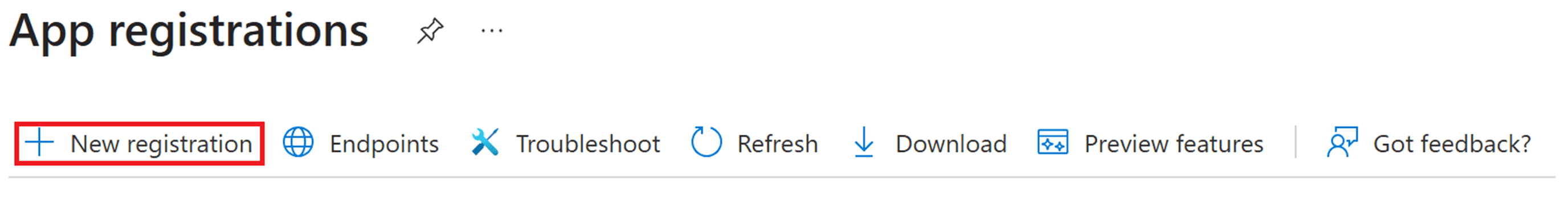

  1. Go to the Entra ID (Azure) portal and select App registrations.
App registration icon

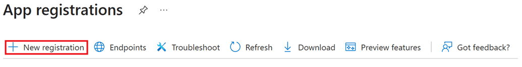

  1. Select New registration.
New registration

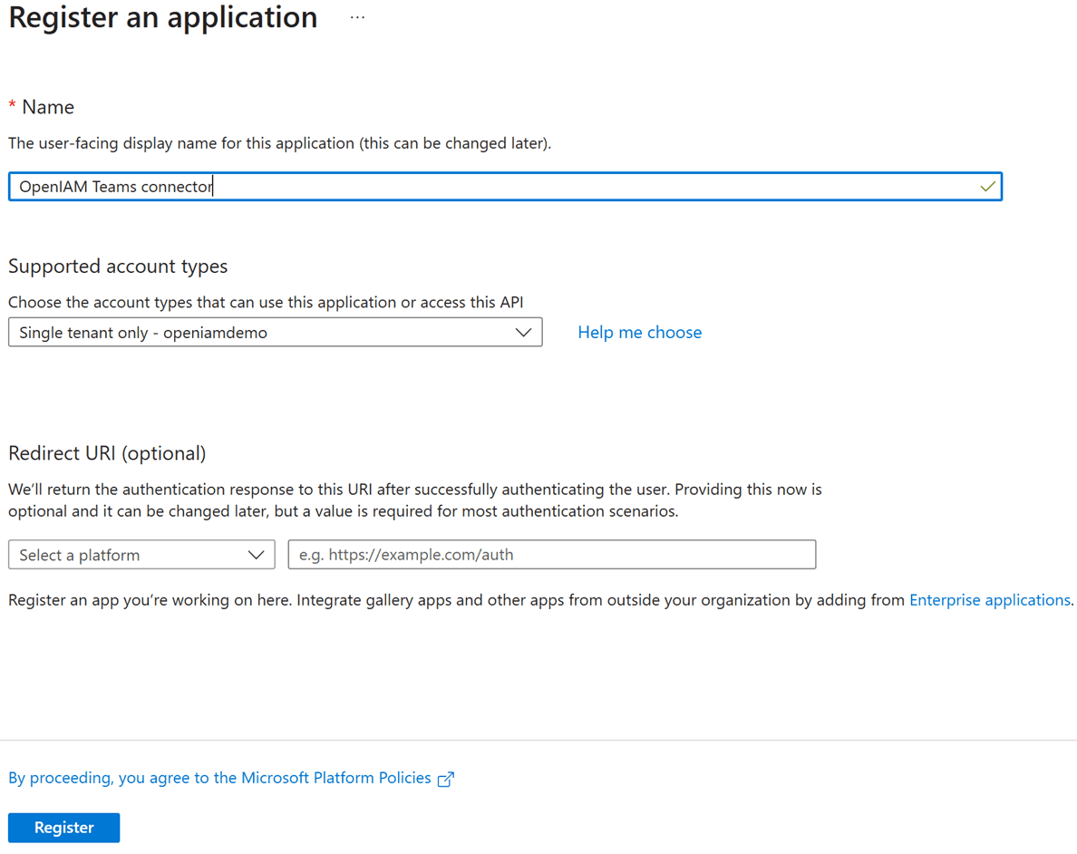

  1. Enter a name for the application and click Register.
New app registration

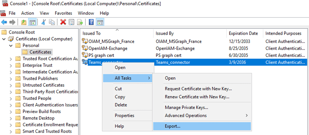

  1. Export the generated certificate without the private key from the certificate store using the MMC console.
Certificate Certificate 2

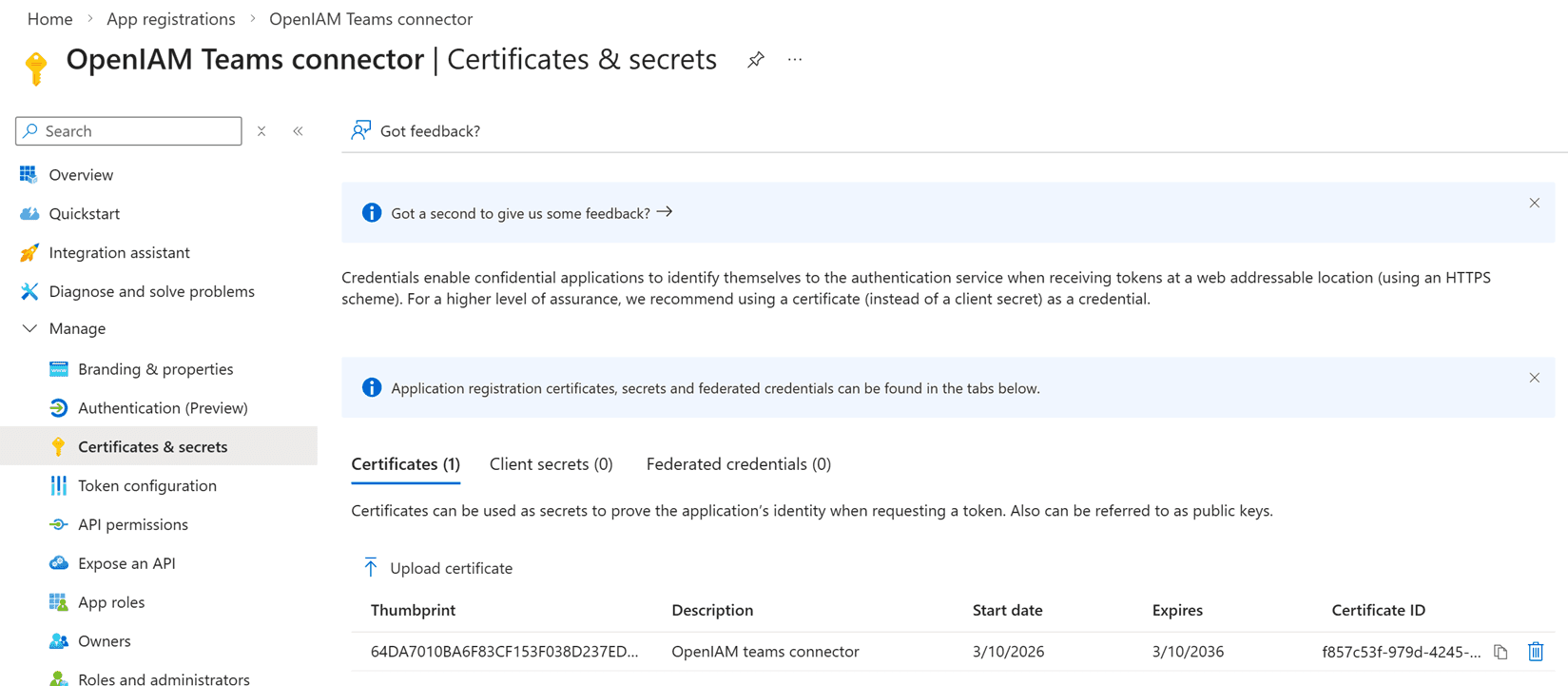

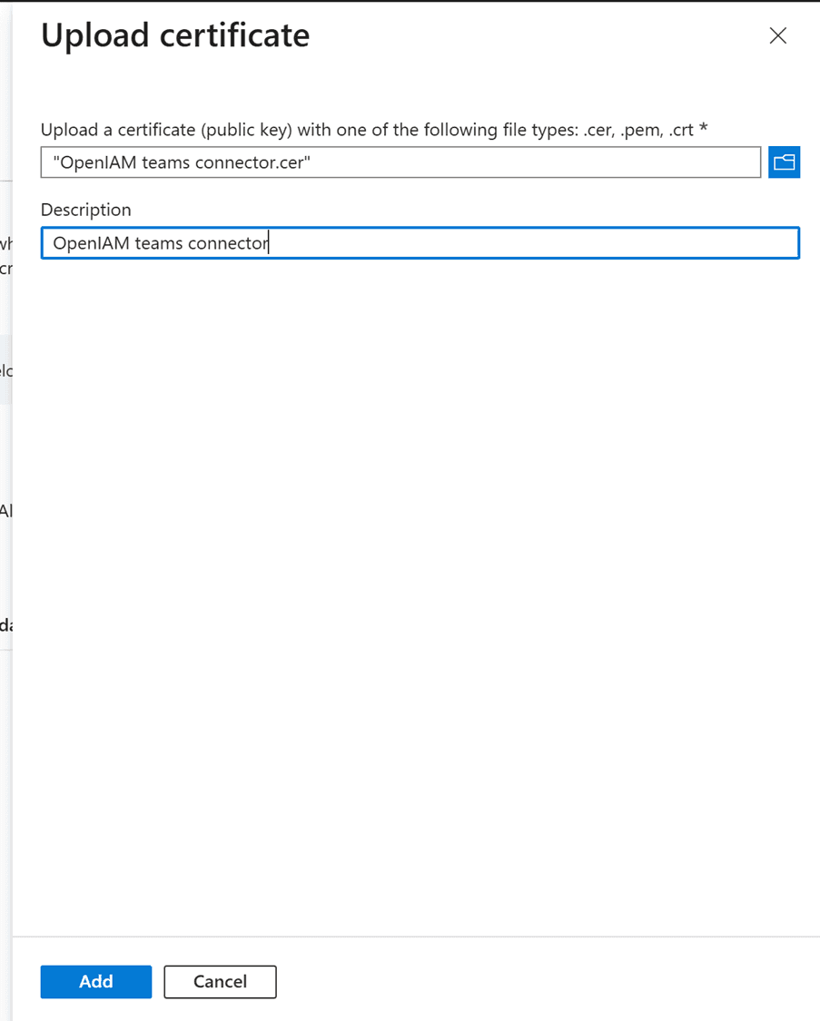

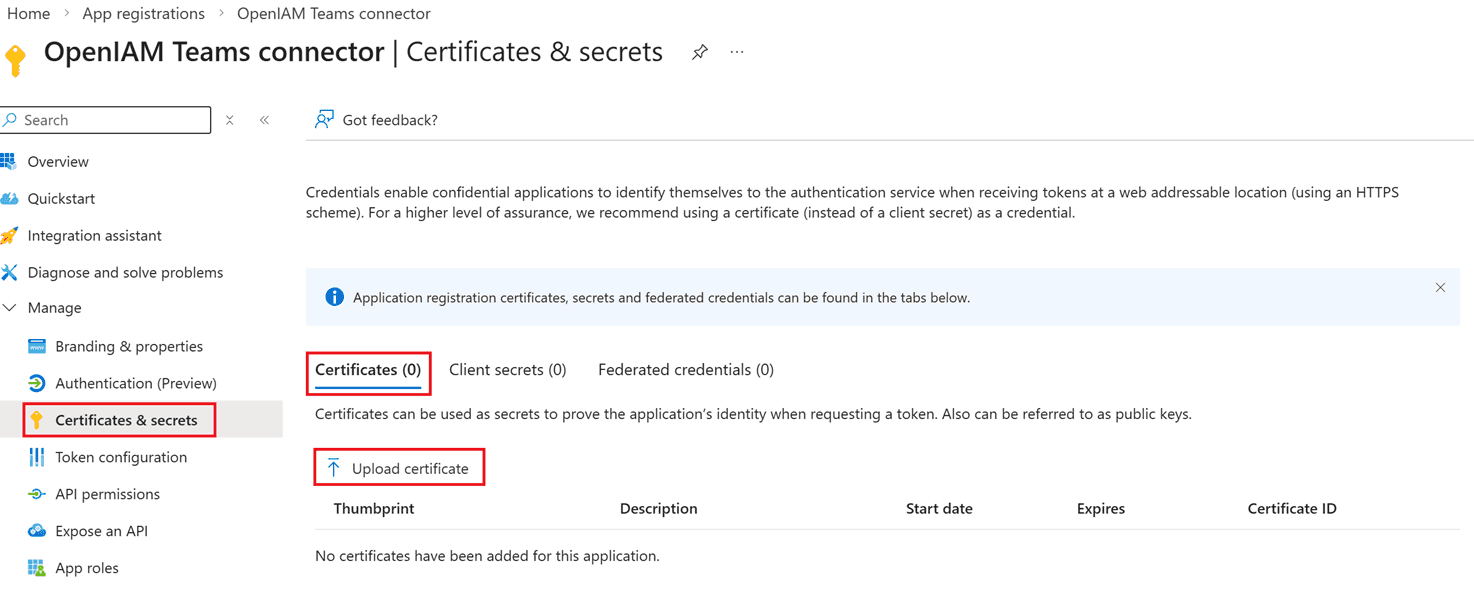

  1. Return to the created application in the Entra ID (Azure) portal and select Certificates & Secrets.
    Open the Certificates tab and click Upload certificate. Choose the exported certificate from MMC and upload it.
Certificate 3 Certificate 4 Certificate 5

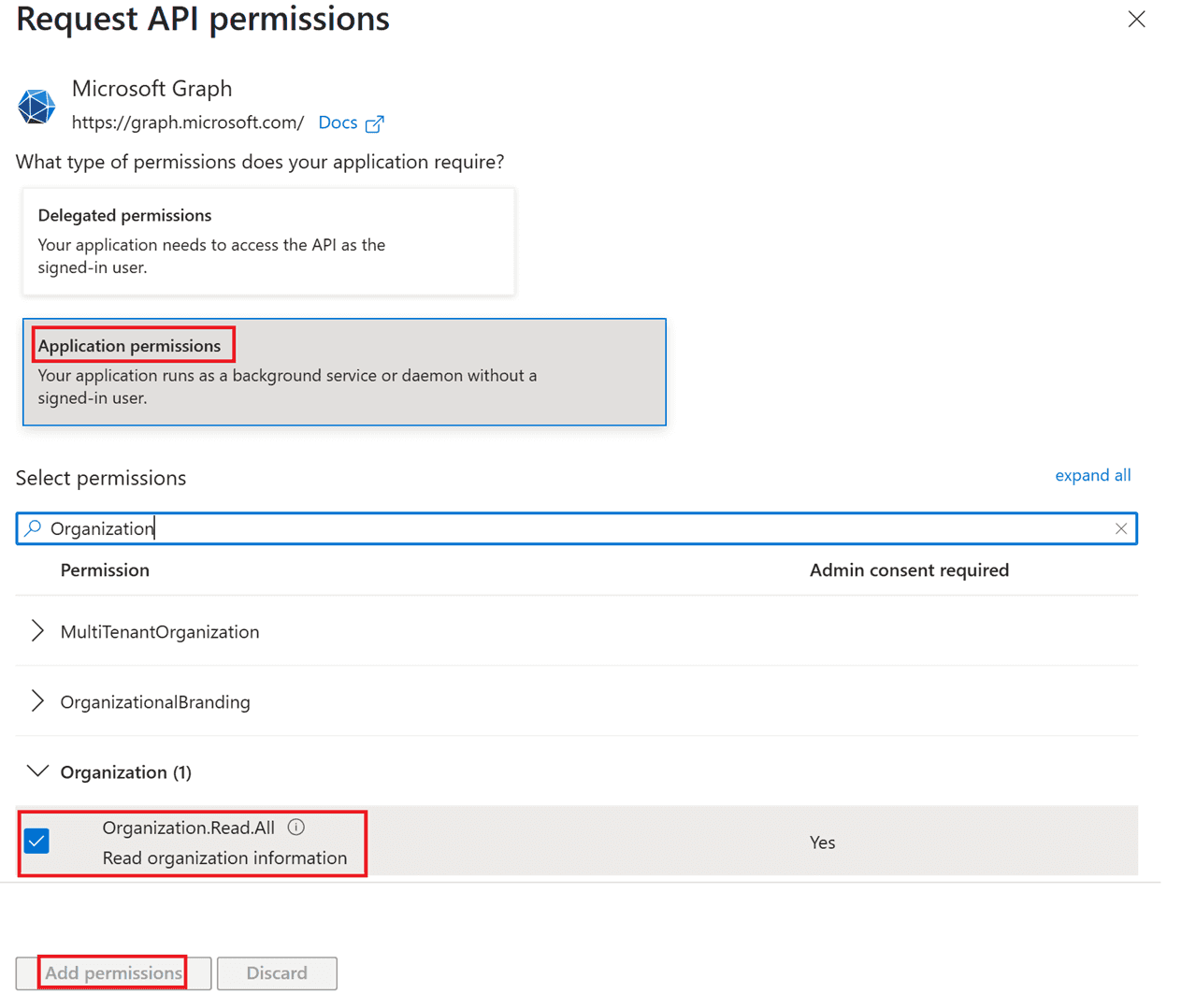

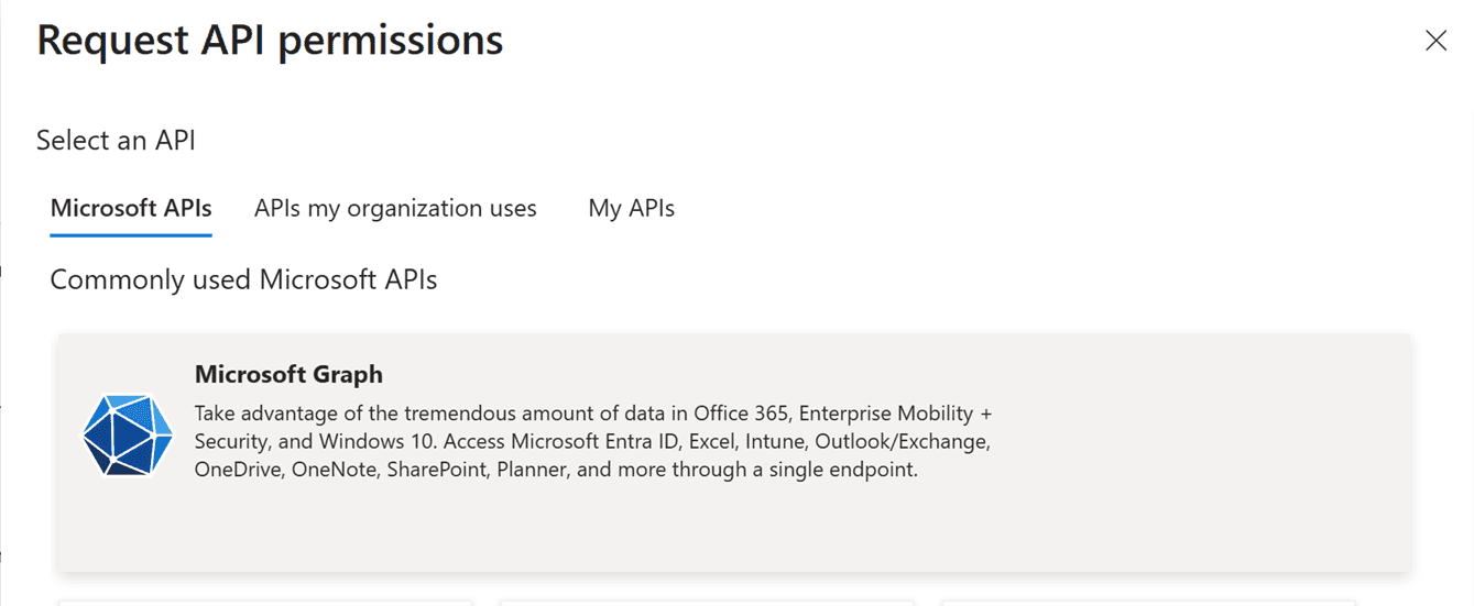

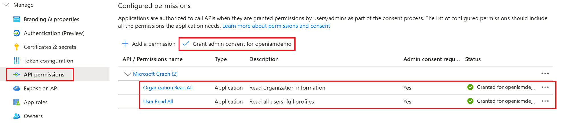

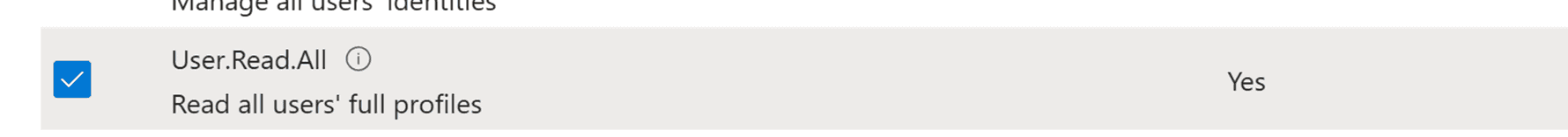

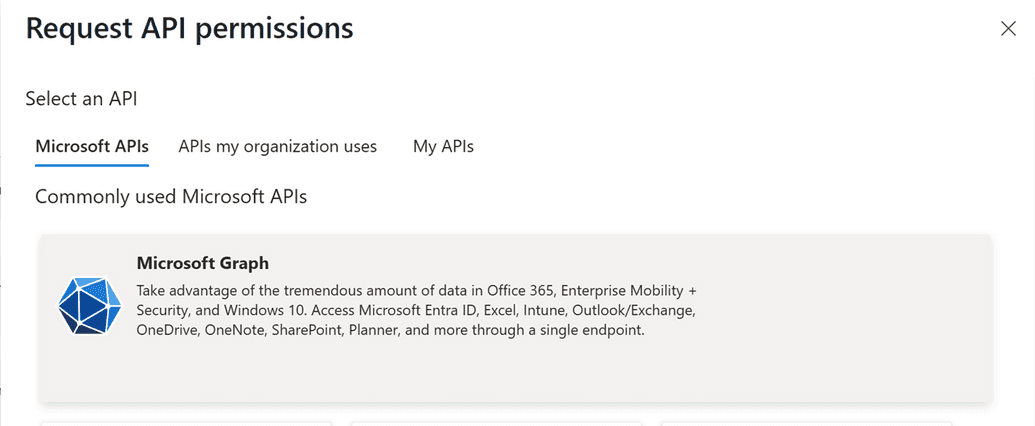

  1. Go to the API permissions section. Add the Organization.Read.All and User.Read.All Application permissions from the Microsoft Graph API, then click Grant admin consent.
API permissions API permissions 2 API permissions 3 API permissions 4

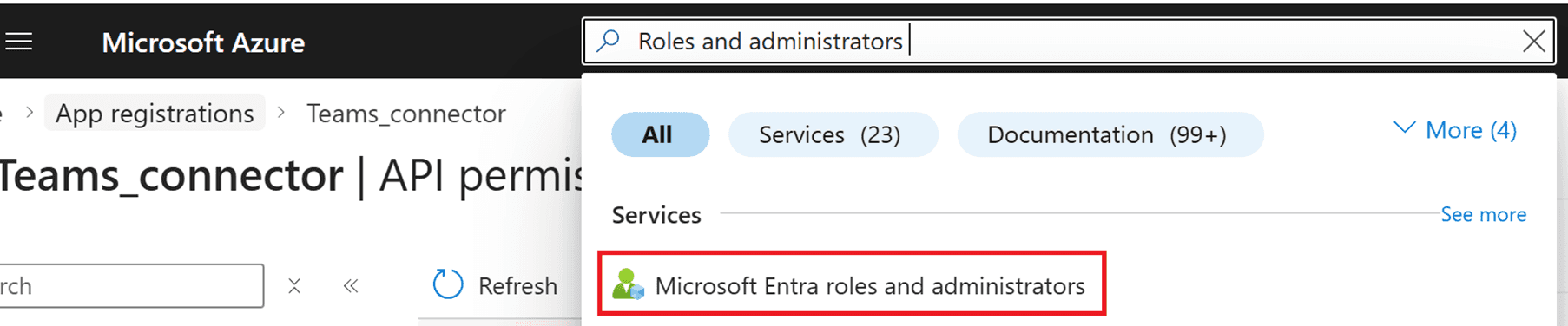

  1. In the Entra ID (Azure) search panel, type Roles and administrators and select Microsoft Entra roles and administrators.
Roles and Administrators

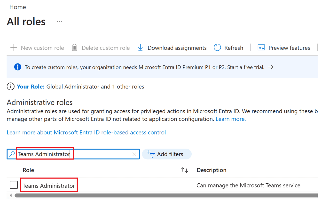

  1. In the search field, type Teams Administrator and select the Teams Administrator role.
Teams administrator

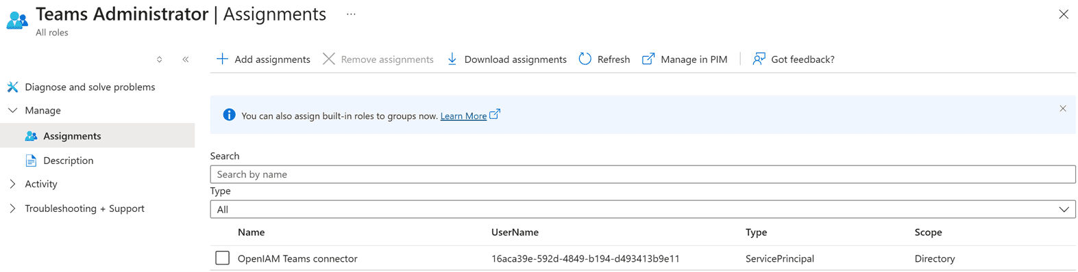

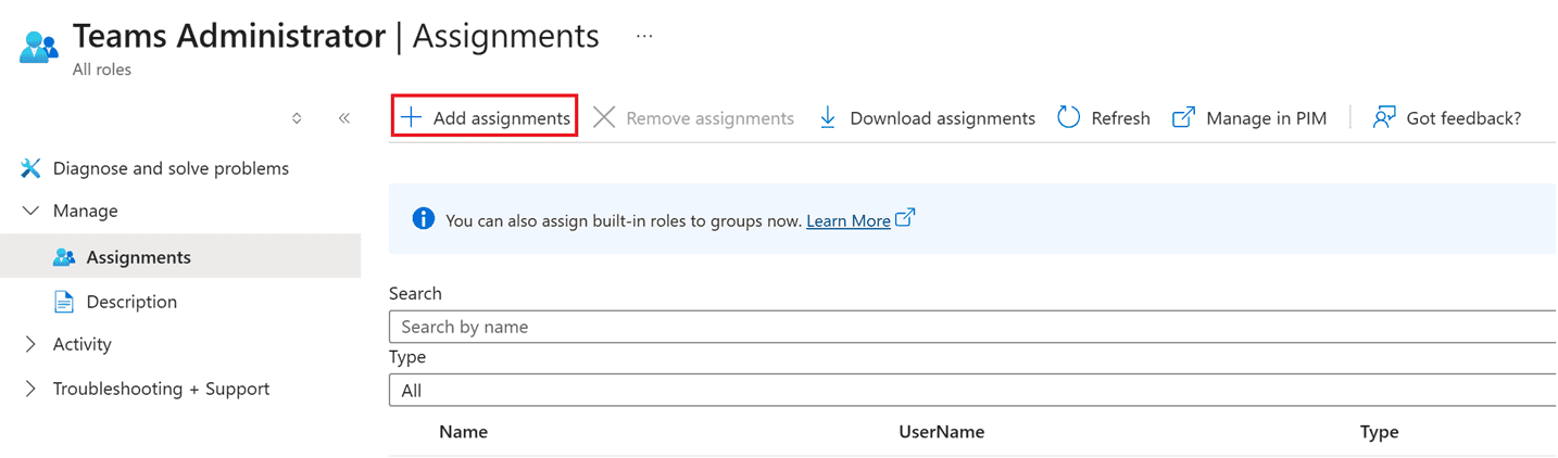

  1. Click Add assignments.
Teams administrator 2

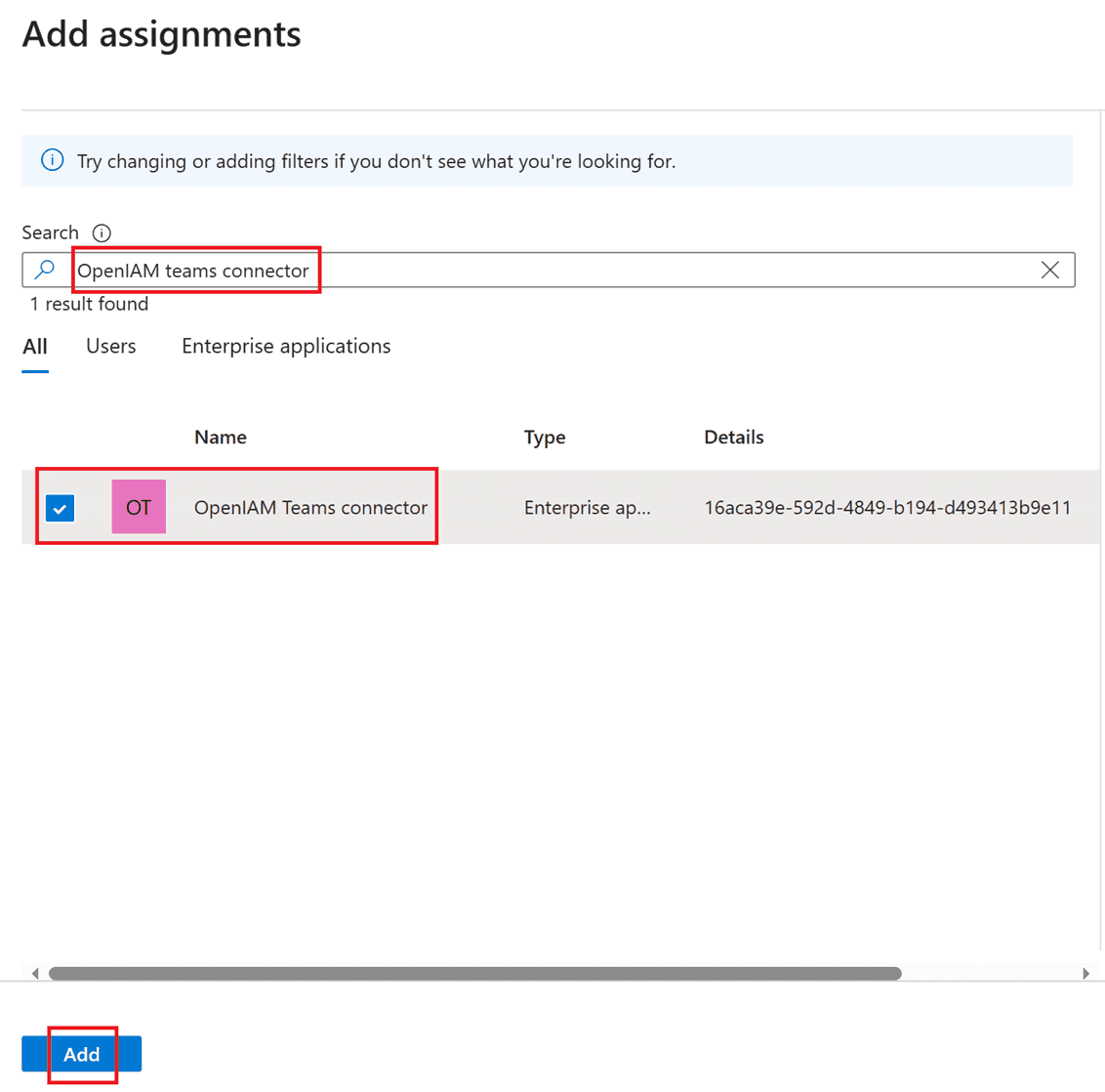

  1. In the search field, type the name of your created application, select it, and click Add.
Adding application Adding application 2

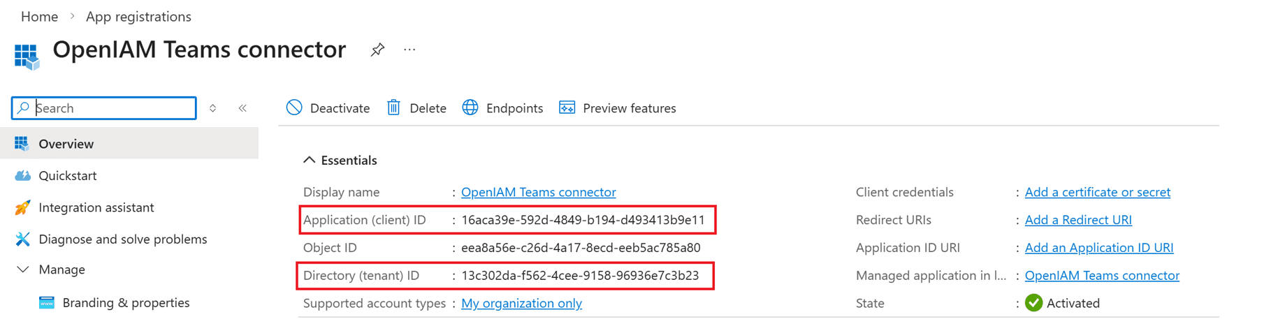

Your application is now ready to use. Additional information is available on the Microsoft website.

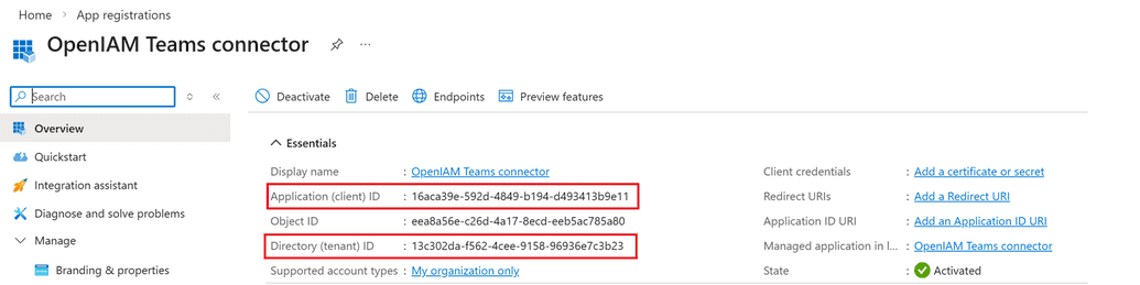

Configuring the OpenIAM managed system
When configuring the managed system on the OpenIAM side, follow the standard steps described in this document. Use the following values for the Teams managed system:
  • URL – Tenant ID
  • Login – Application ID
  • Password – Thumbprint of the generated certificate
Managed system config
