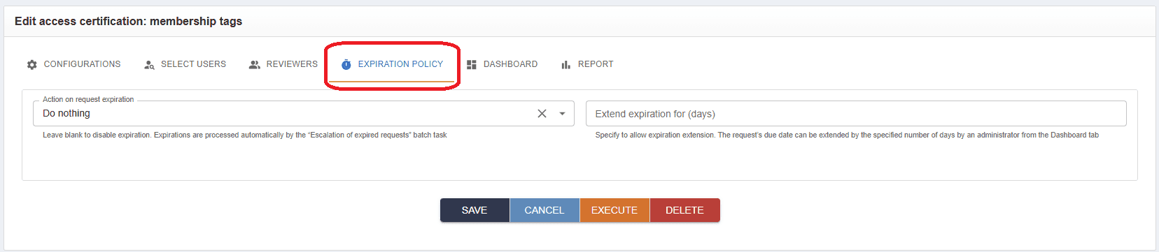

To use this feature, users must configure an expiration policy, which defines the sequence of actions that occur when a campaign expires.
Expiration policy tab

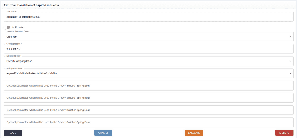

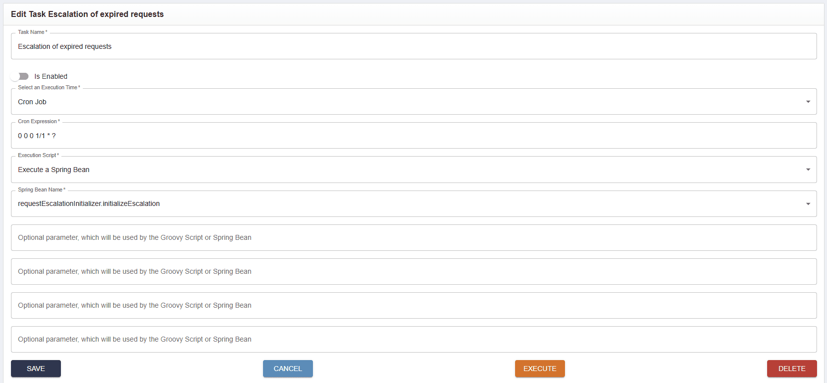

Expiration is initiated by the batch task called Escalation of expired requests. By default, this task is disabled, so the first step in configuring the expiration policy is enabling it.
  1. Log in to the webconsole and go to Administration > Batch tasks.
    Find the batch task (Escalation of expired requests) and click the edit icon. You will be taken to the screen below.
    Escalation of expired requests screen
  2. This is a default out-of-the-box batch task that is disabled, so move the slider to the enabled position.
    The task will locate requests with due dates in the past and handle their expiration. It applies not only to access certification requests but also to all requests with an assigned due date (termination, create access, etc.).

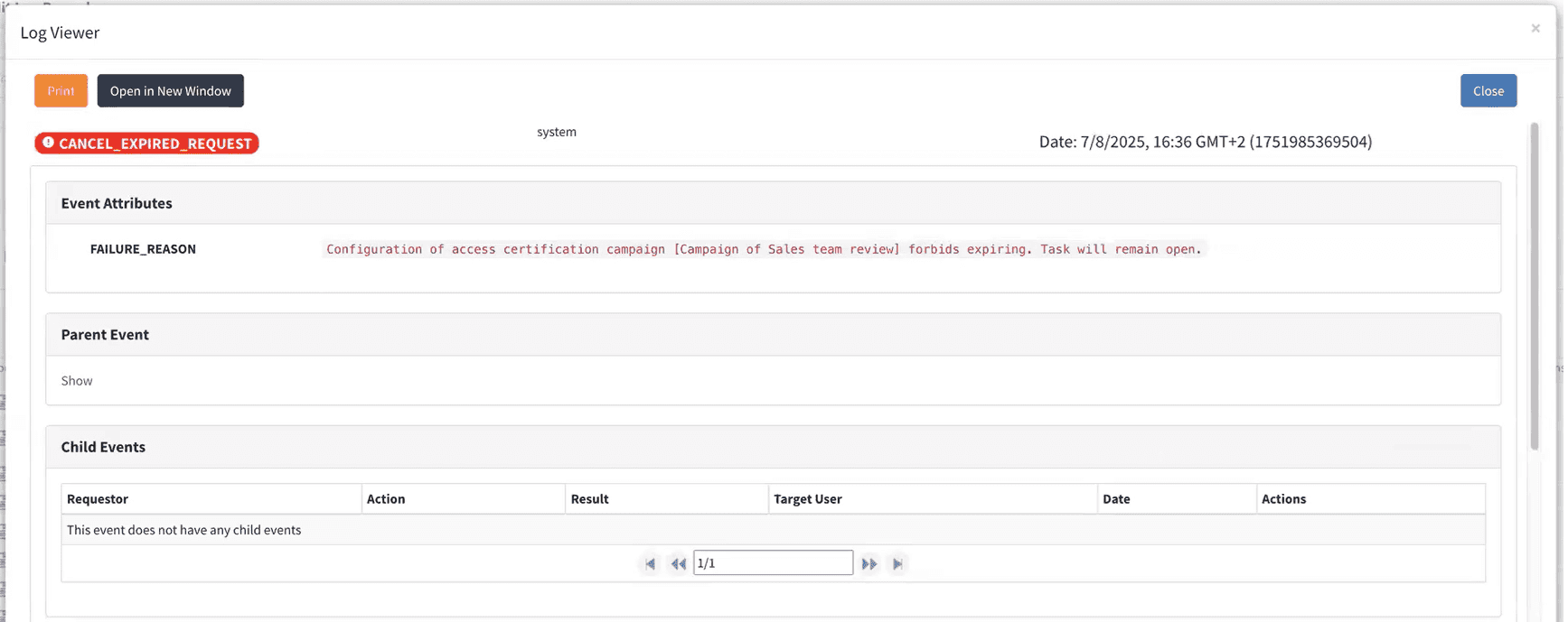

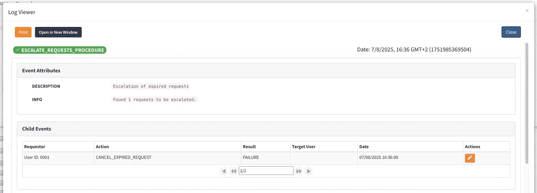

  3. By default, expiration is not allowed. In this case, the log entry for an expired request looks as follows:
    Log entry

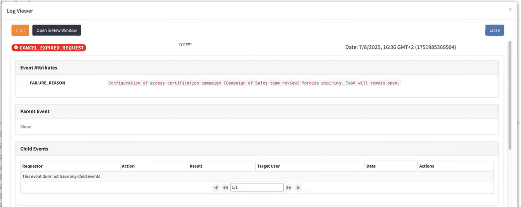

    There is an event CANCEL_EXPIRED_REQUEST, but it fails. Clicking the Details icon shows that expiration is forbidden by the campaign configuration, and the task remains open.

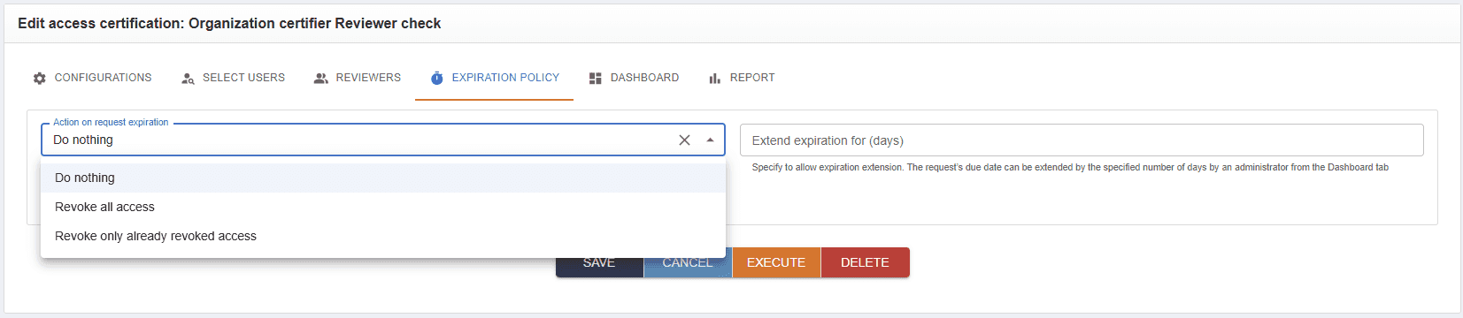

  4. When the expiration option is enabled, users are presented with the options below:
    Enabled expiration dropdown
    Here, users must specify what happens to an expired request. If no option is selected, the default is DO_NOTHING.

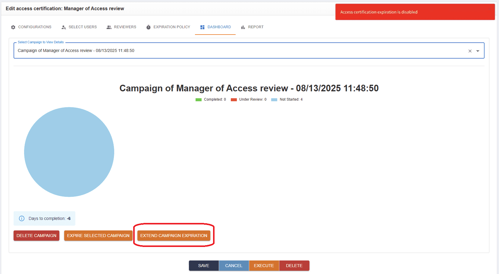

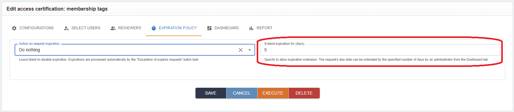

  1. The Extend expiration for (days) option enables extending the deadline if reviewers cannot finish within the original period.
    If disabled, attempts to extend the campaign by x days from the Dashboard will result in an error.
    Expiration extension error
    When enabled, users can specify the maximum number of days allowed for extension (in the example below it is 5 days).

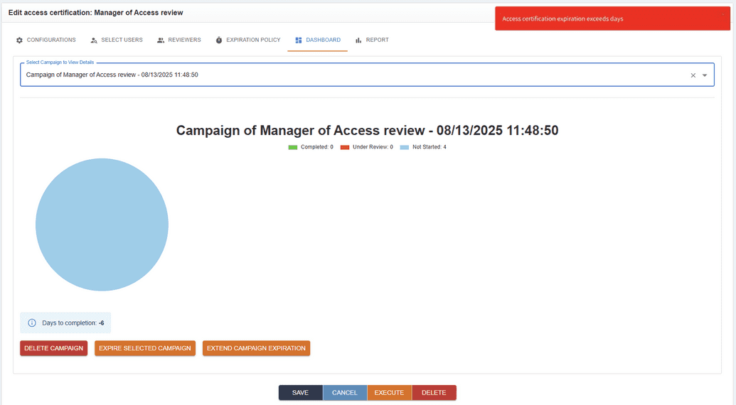

  2. Configure all extension-related fields and click Execute now.

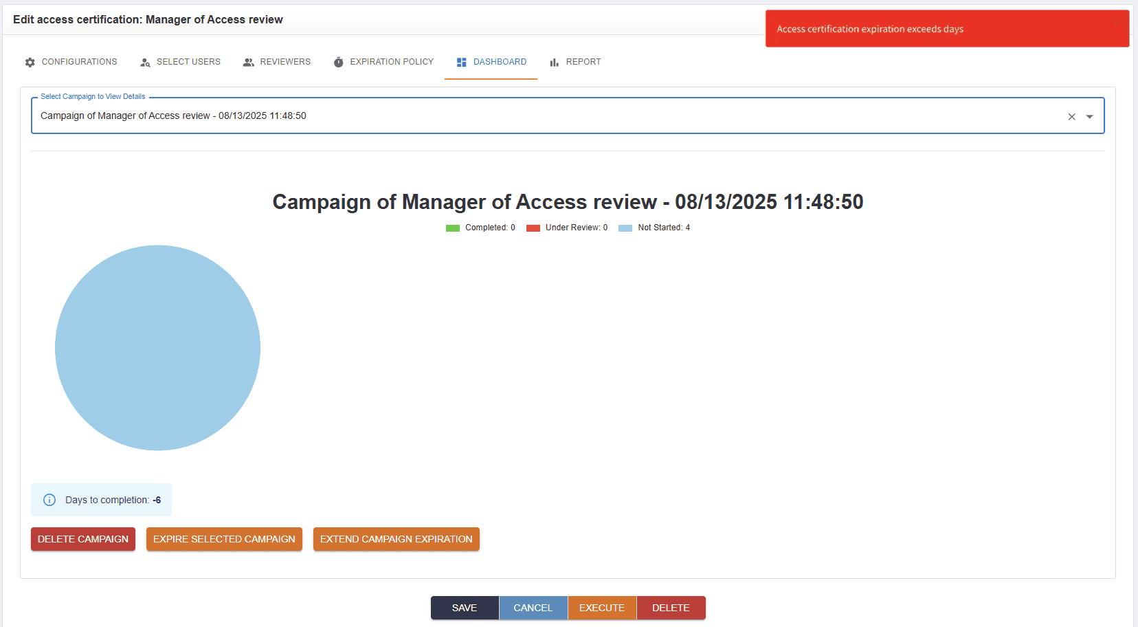

    In the Dashboard tab you will see the campaign executed, and you may extend it for the required number of days.
    However, if the requested extension exceeds the number specified in the Allow expiration extension field, the following error appears:
    Days number exceeded
