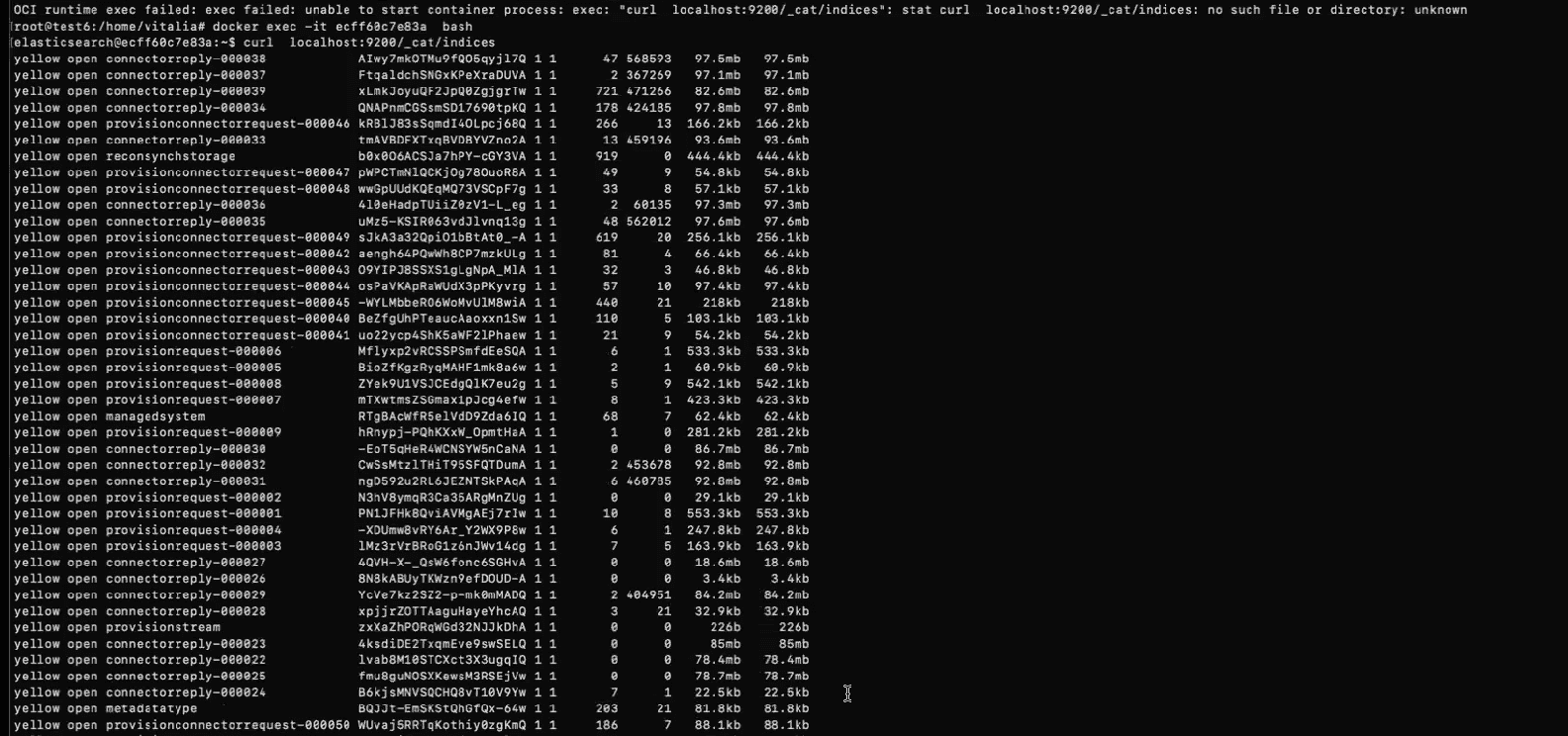

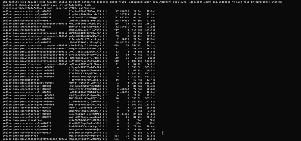

There are several types of indices in Opensearch. You can view them by calling the API using the following command (in RPM).
curl localhost:9200/_cat/indices
To access indices in Docker, perform the command above after entering the Opensearch container.
After executing the command, you will see a list of existing indices, as shown below.
There are three indices being curated by Opensearch itself, it means Opensearch refreshes them on its own. These are provisionconnectorrequest, connectorreply and provisionrequest. For each of these indices there is a curating script with an index setting, e.g. its size (up to 5Gb) or its age (up to 10 days of life), that is being called and closing the index and opening a new one when the setting becomes true. The indexes are closed since we believe they store some temporary data that are needed for some limited time only and not necessary further, hence, needed to be erased. More info on indexes can be found in Opensearch ILM reference
