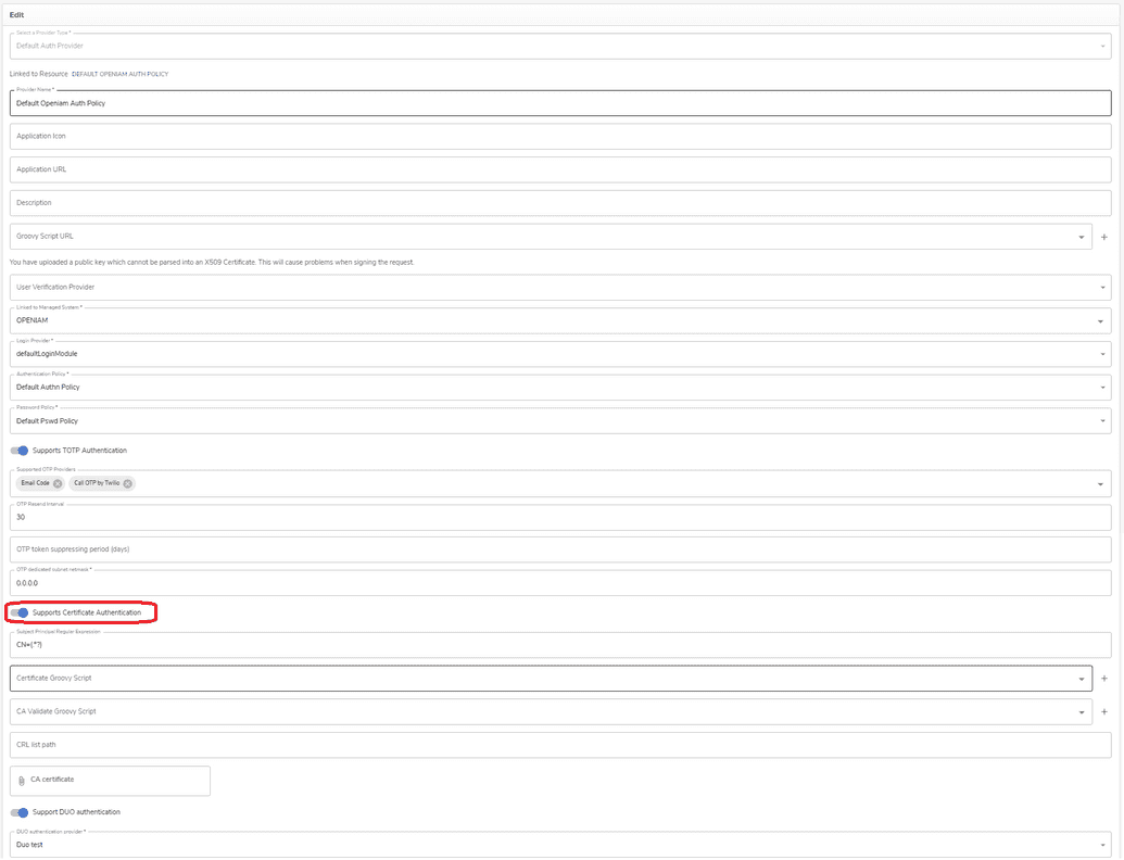

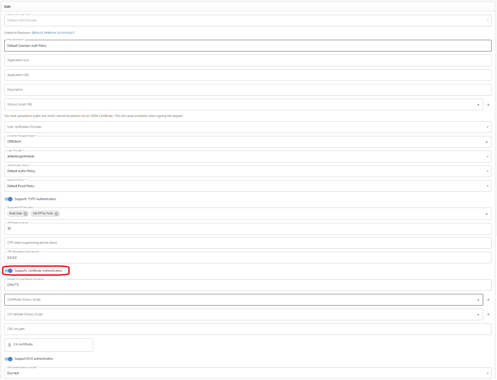

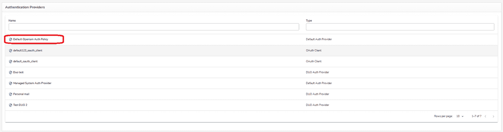

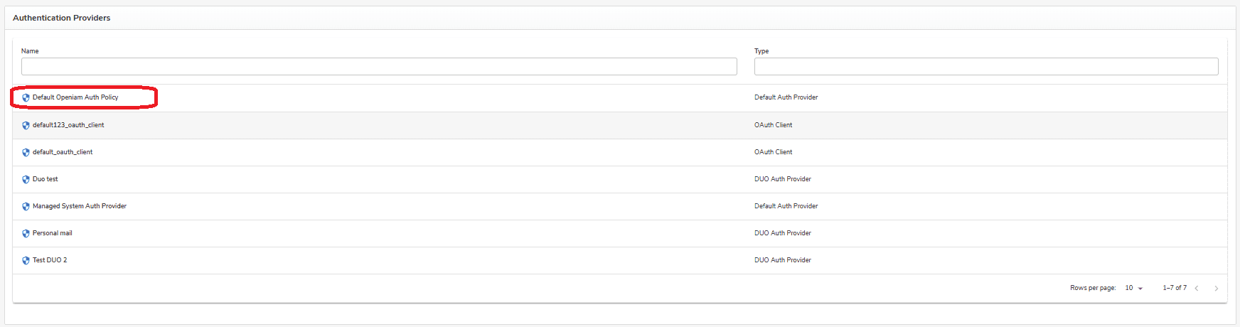

Navigate to the current Authentication Provider in Access Control > Authentication Providers, and enable Certificate-Based Authentication, as shown in the figures below.
Default Auth Provider
Now, there are two options for mapping the certificate to a user principal:
  • Add a Regular Expression to the Certificate: This will extract the principal from the matching group in the Regex.
    Example: CN=(.*?)
  • Define a Custom Groovy Script: Use a script with custom logic to parse the certificate and determine the principal.

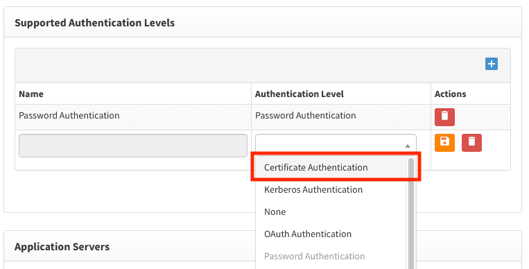

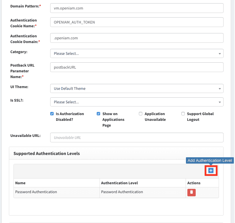

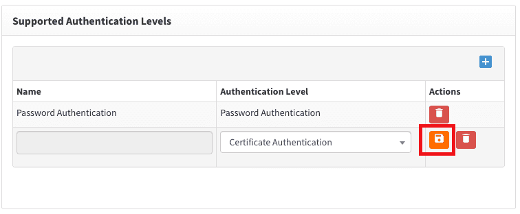

You can configure this in the Content Provider screen: Access Control > Content Providers. Navigate to Authentication Levels and add Certificate Authentication, as shown below.
Add Auth Level

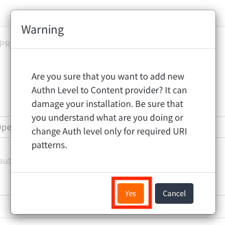

If a warning appears about modifying default settings, click Yes.
Warning
Add Certificate Authentication with the steps described below.
Add CertAuth Save CertAuth

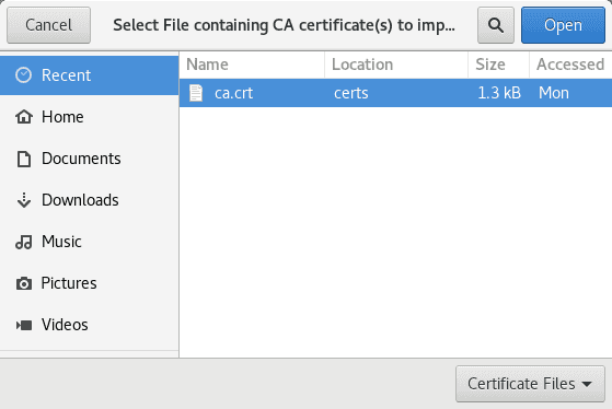

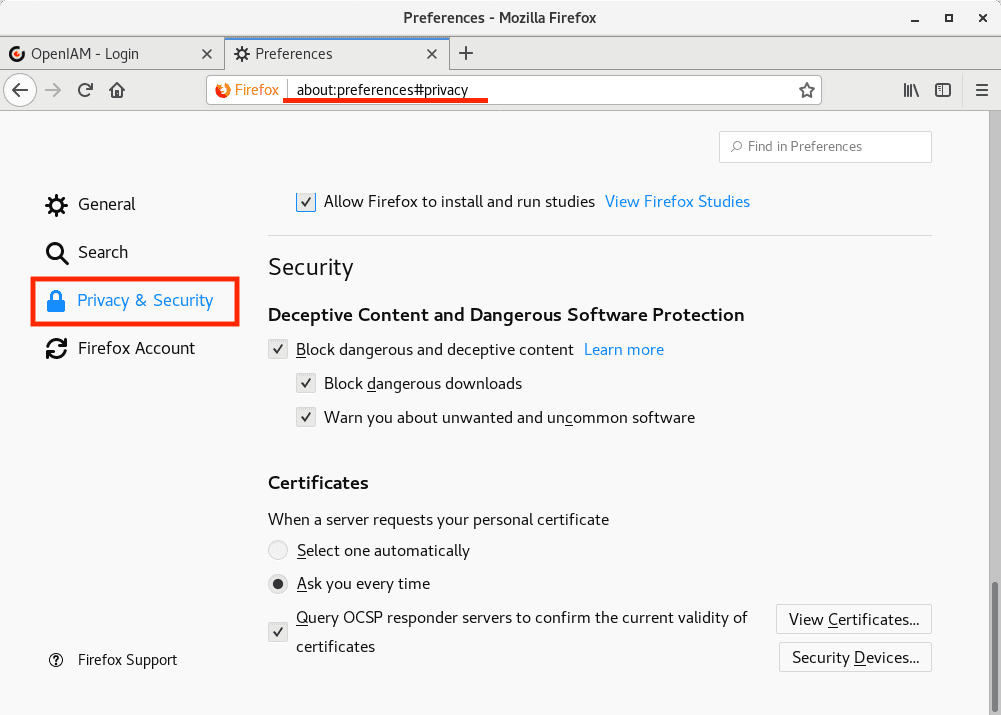

Users need to copy user1.p12 and ca.crt files to their local computer and install them in the browser. The browser checks user1.p12 using ca.crt before sending it in requests.
Installing ca.crt in browser

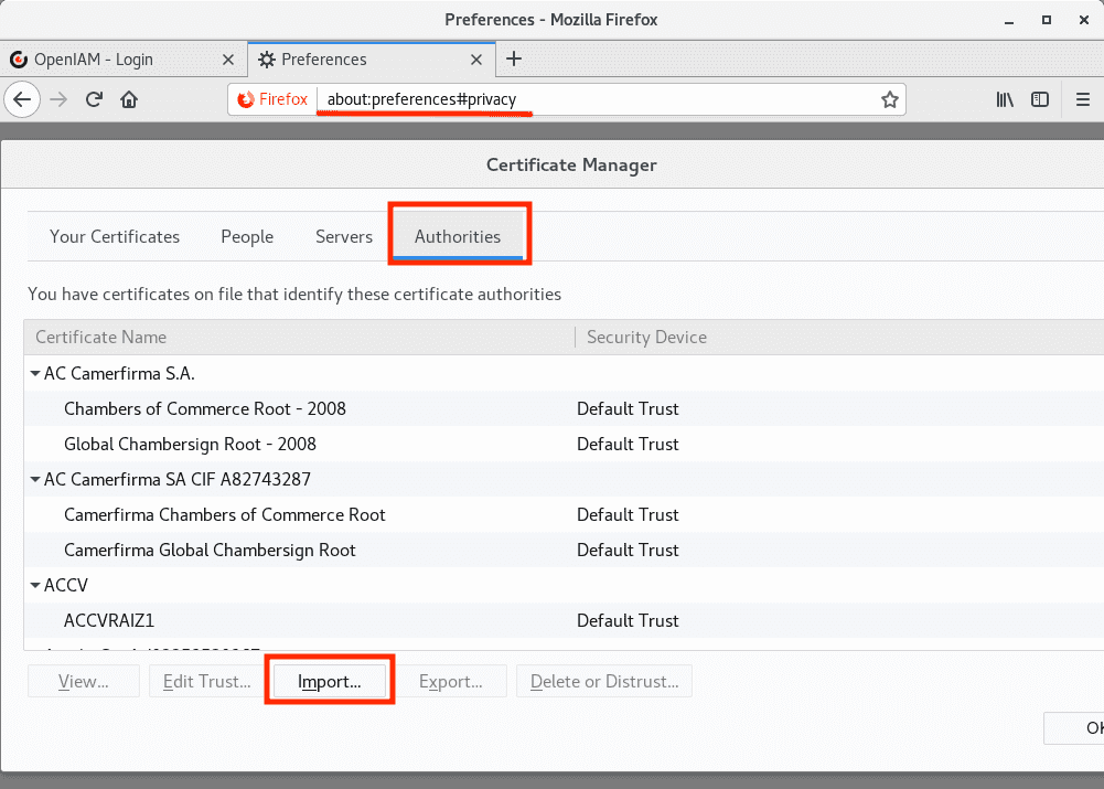

Go to the certificates configuration as shown below.
Certificates Config Authorities
Import ca.crt into Authorities.
Select CA

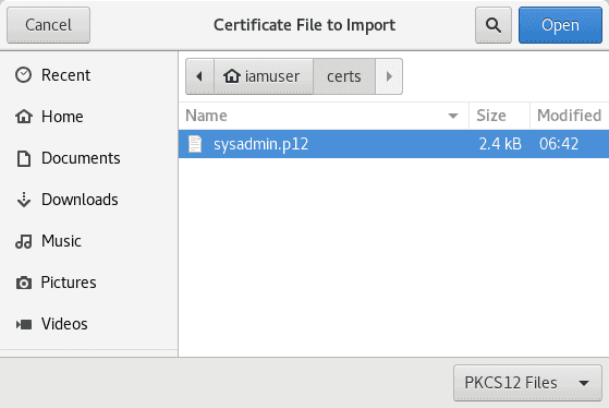

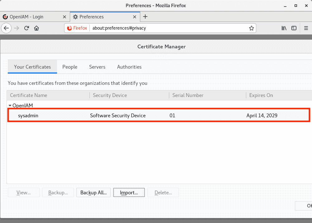

Install user1.p12 into Your Certificates.
Your Certificates Select User1

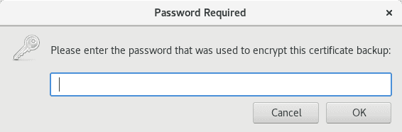

You will also need the Export Password that you used when creating the .p12 file.
Verify Export Password
Check that the user certificate was successfully added.
User Certificates Added
