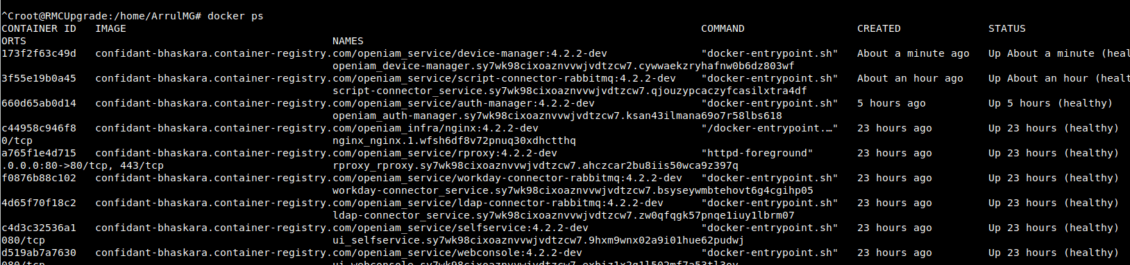

  1. View the running containers. Use the command below to list all running services.
docker ps
Services output
You can filter and see a particular service as follows.
docker ps | grep <servicename>
For example:
docker ps | grep idm
Here, the first column in the output is the container ID, which will be used to fetch logs.

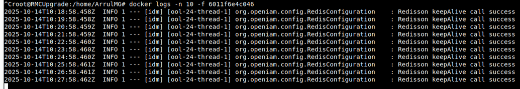

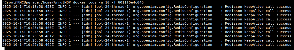

It can also be convenient to view only the last N lines (e.g., last 100 lines) of logs, not to scroll the whole file. You can do it as follows.
docker logs -n 100 -f <containerId>
docker logs -n 100 -f 7bf8b5be18bb
N lines of logs
