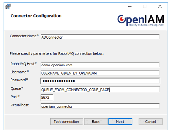

  2. Connecting to your directory. To connect OpenIAM to the Entra/O365 service using the connector you need to specify the service account on the Managed System configuration page. This service account should have sufficient privileges to perform actions that you would like to do using PowerShell connector.

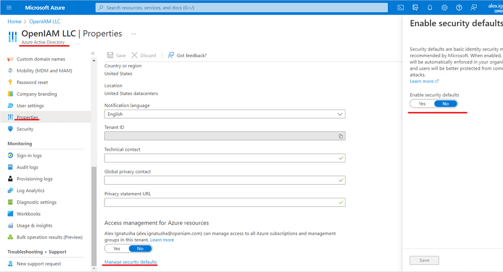

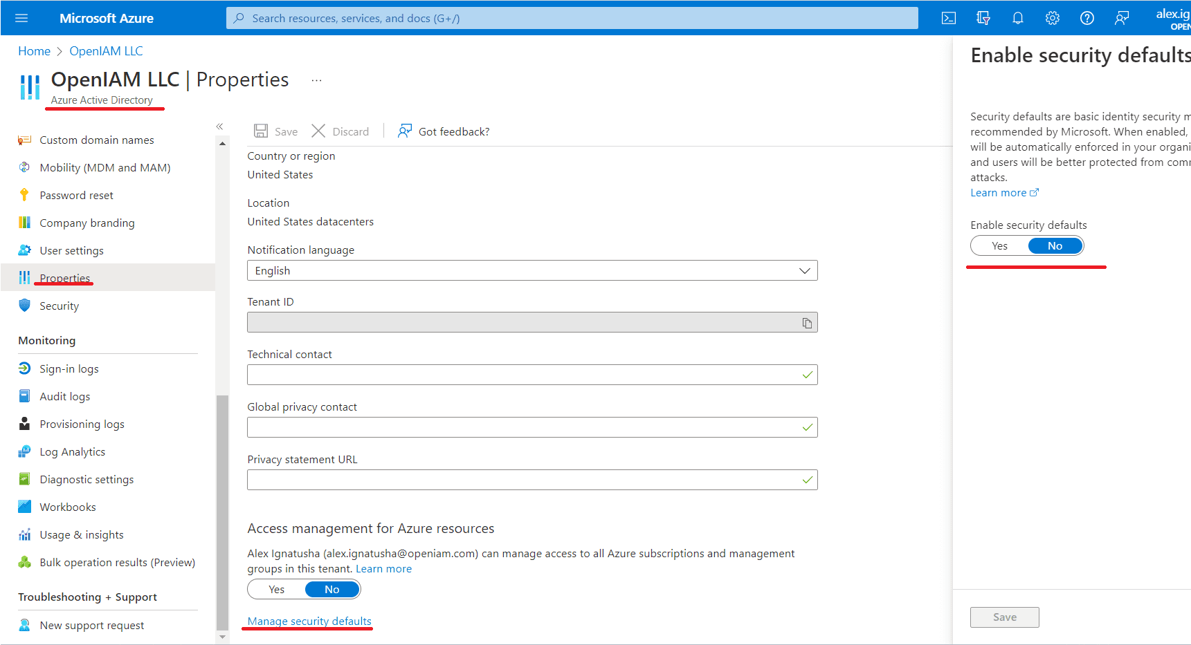

To configure SMPT, several issues shall be checked. Here, if the security defaults enabled - regardless of other settings, SMTP protocol will be disabled. Before it was off by default, but now Microsoft sets it to on.
Users can check whether it is on. This setting is located under portal.azure.com > Entra ID, as shown below.
Azure properties portal

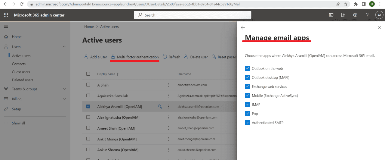

Additionally, at admin.microsoft.com it is possible to check if the given service account has explicit permission to use SMTP. To check it, click to account > mail > manage mail apps like shown below.
SMmail
