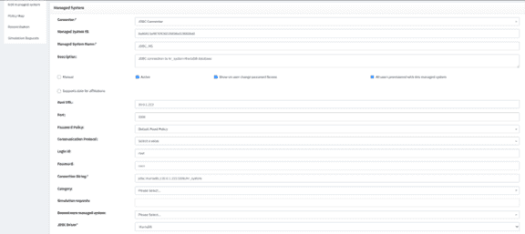

Configuring Managed system
Log in to webconsole, go to Provisioning > Managed system, click Create managed system on the left and configure a new managed system with the following parameters.
  • Type: JDBC Connector.
  • System Name: Choose descriptive name for your environment.
  • Description: Brief description of the database system.
  • Status: Active.
  • Connection String: Complete JDBC URL (e.g., jdbc:mariadb://your-host:3306/your-database)
  • Login Id: Database username
  • Password: Database password
  • JDBC Driver: Select your database type
JDBC Managed system
Configure the complete JDBC URL using the standard format for your database type.

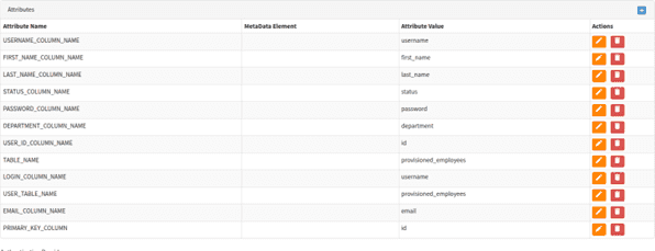

Attribute mapping
Map OpenIAM user attributes to corresponding database columns.
Attribute mapping for JDBC

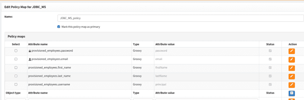

Policy map configuration

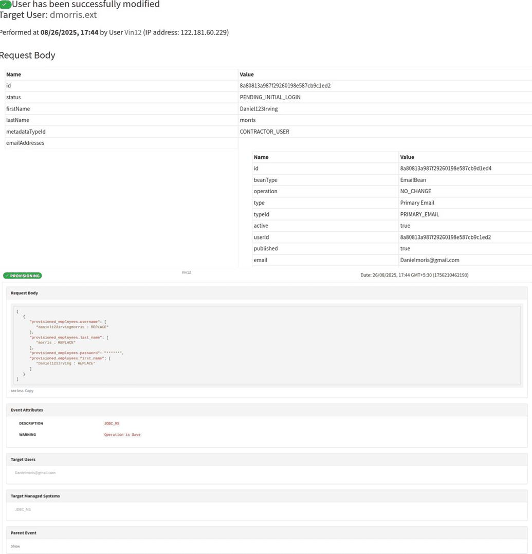

The next step is to configure a Policy map. For that, create a user account that is assigned to a managed system and is also associated with a specific database connection. Do that through the UI as shown below.
New user

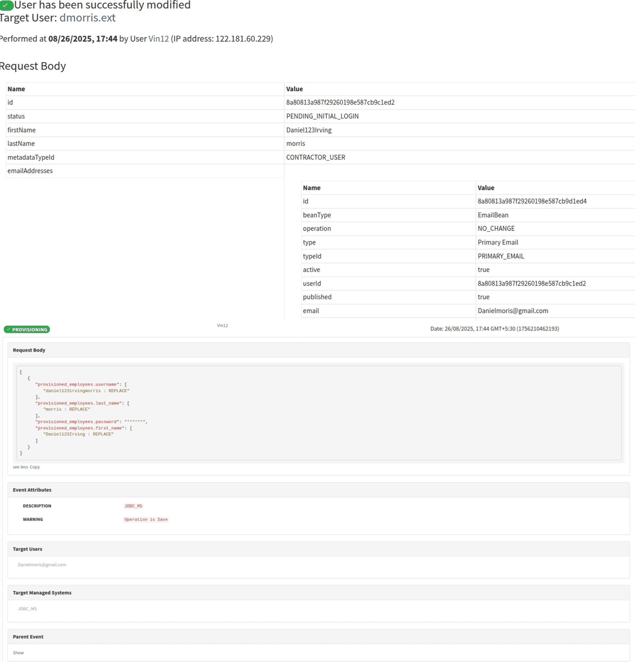

Logs for provisioning

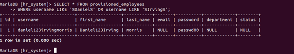

Make sure the user crated in UI is successfully fetched into the database, as shown in the logs screenshots below.
User fetched in DB

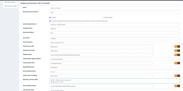

  1. Log in to webconsole and go to Provisioning > Synchronization, click Create Synchronization.
  2. Use the following setting to configure JDBC synchronization.
  • Name: JDBC User Example.
  • Managed System: JDBC_MS.
  • Sync Type: Complete.
  • Source Attribute Name: username.
  • SQL Query: SELECT * FROM provisioning_db.employees WHERE status = 'ACTIVE';
Synchronization configuration

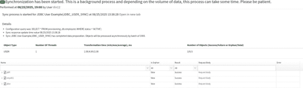

  1. Click Save and test synchronization. Check log entries to see if synchronization was successful.
Synchronization log
Synchronization in DB
