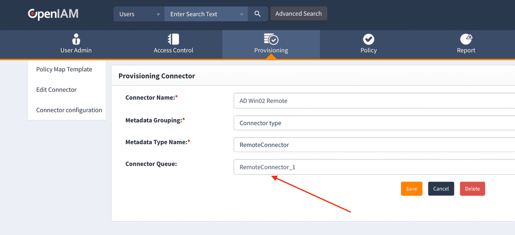

To get the queue name to use during installation, log in to your OpenIAM webconsole > Provisioning > Connectors > Select your connector > copy the Connector queue parameter from this page, as shown in the image below.
Getting RabbitMQ queue from webconsole

  • Queue: this parameter should be taken from the connector configuration page inside OpenIAM, as described above.

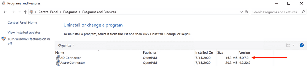

If you have customizations, check the connector version before updating. If the major version (first two numbers) is the same, you can most likely use the same script files as before.
To check the connector version, go to Control Panel > Uninstall a program. The version is shown next to the connector name, as shown in the image below.
Checking PowerShell connector version
If you have customizations, you can extract the PowerShell files from the new connector installer (using a test VM if needed) and compare them with your customized versions. If the OpenIAM team made the customizations for you, contact OpenIAM support if you are unsure.

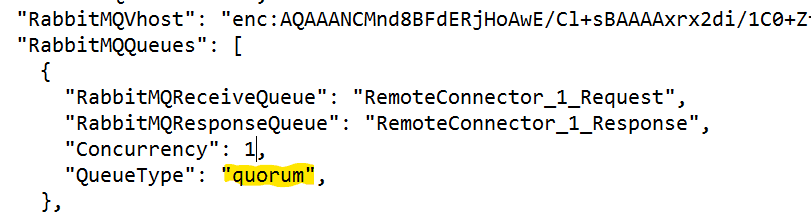

RabbitMQ QueueType
Starting from version 4.2.1.9, OpenIAM uses the quorum QueueType for RabbitMQ communication with connectors.
.NET/PS connectors use this value by default starting from version 5.31.0.0. However, this parameter is configurable on the connector side for backward compatibility. If you need to use a .NET/PS connector version 5.31.0.0 or higher with an OpenIAM version below 4.2.1.9, open Connector.config inside the connector folder and change the QueueType parameter from quorum to classic.
QueueType parameter
Troubleshooting: verify that the QueueType parameter in Connector.config matches the queue type configured on the RabbitMQ side.
