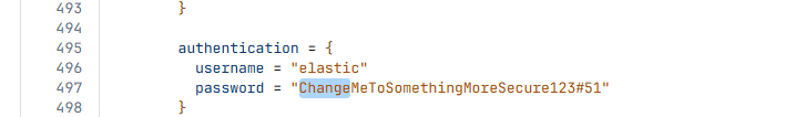

Elasticsearch passwords
  1. Update the default Elasticsearch password in terraform.tfvars.
vi terraform.tfvars
Locate the ElasticSearch password variable and update it.
Located password
