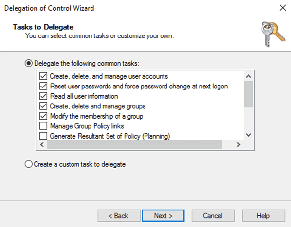

For Active Directory (AD) service account to connect to the AD domain and to integrate OpenIAM with your AD environment OpenIAM requires host information. The following permissions are also needed.
  • Read access to directory objects (users, groups, OUs).
  • Write access if provisioning/deprovisioning is required.
Access
