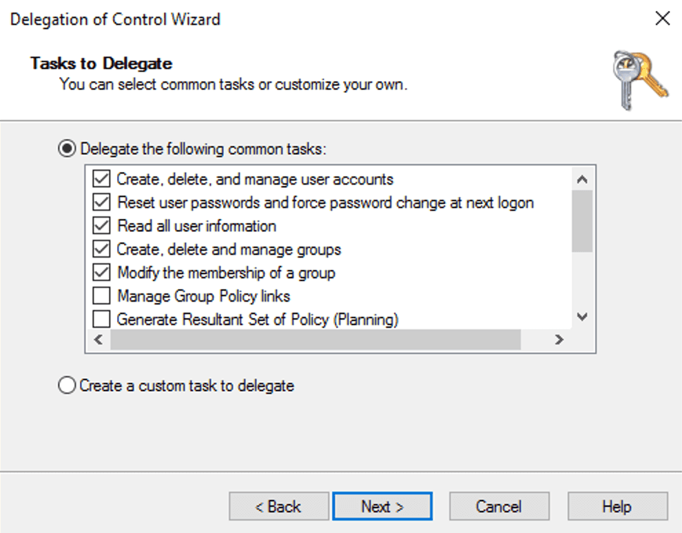

As an example, you can use Delegation control to give your service account permissions for a given OU. To do this you can select your OU inside ADUC (Active Directory Users and Computers) by right-clicking and picking the Delegation control wizard like shown below.

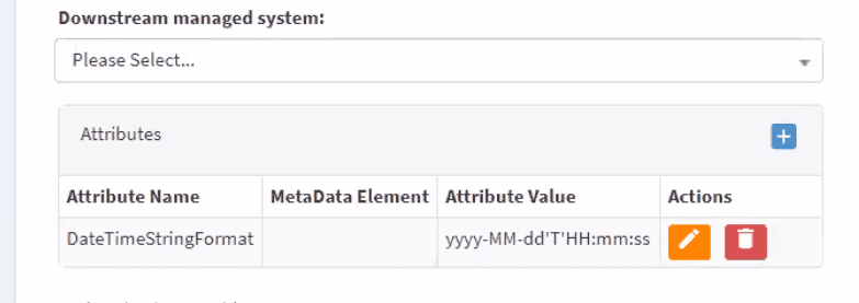

| AccountExpires | Sets the account expiration date using the format defined by DateTimeStringFormat on the managed system. When sent with the Delete operation code, the account is set to never expire. | No | String (format per DateTimeStringFormat) |

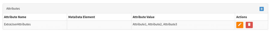

- At the managed system level, create an
ExtraUserAttributesattribute and add all provisioning attributes related to the extended AD schema to it, separated by commas.

DateTimeStringFormat | Format used to parse and return date/time values (such as AccountExpires). Must match the format OpenIAM uses when sending date strings. |

Incremental sync of users or groups
When running incremental sync, OpenIAM relies on the time of the last user/group modification in AD. Each user or group in AD has a Modified property that is updated each time the object is changed.
To get objects modified after a certain date:
Get-AdGroup -Filter "Modified -gt '$((Get-Date '?').ToUniversalTime())'"
In this example, OpenIAM replaces ? with a real value during runtime.
OpenIAM also needs to know the time format to use when receiving values from the connector. This format is sent in the request metadata as the DateTimeStringFormat parameter:
This setting can be changed in the configuration of your Managed System.

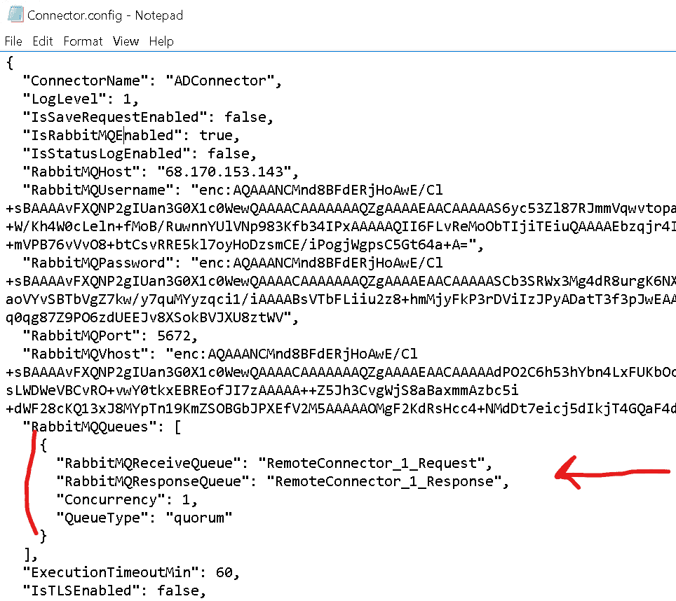

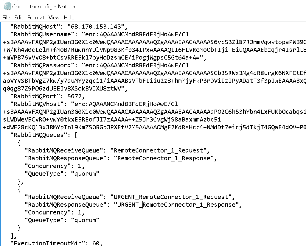

Urgent queues
A connector is responsible for transferring data between systems. If some messages require immediate processing, an urgent queue can be implemented to prioritize them over regular traffic. To add a connection, follow the steps below.
- Open
Connector.configinside the connector folder on the Windows machine and add a new record to the"RabbitMQQueues"array, as shown below.
Duplicate the existing queue record and append URGENT_ to the *ReceiveQueue and *ResponseQueue property values. The configuration that supports urgent queues looks like the one below.
Concurrency values can be set independently for the normal and urgent queues.
