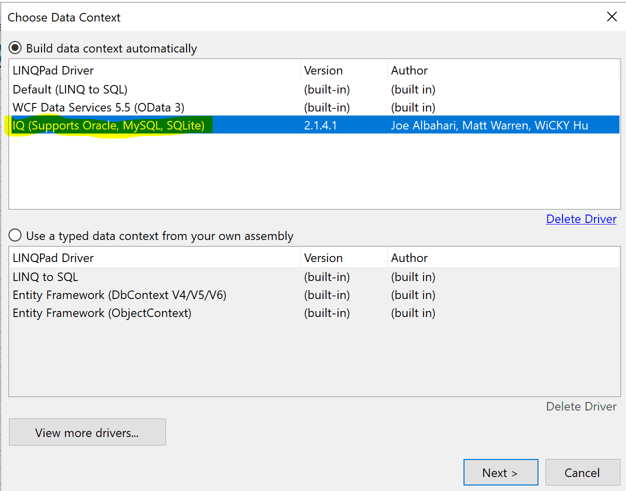

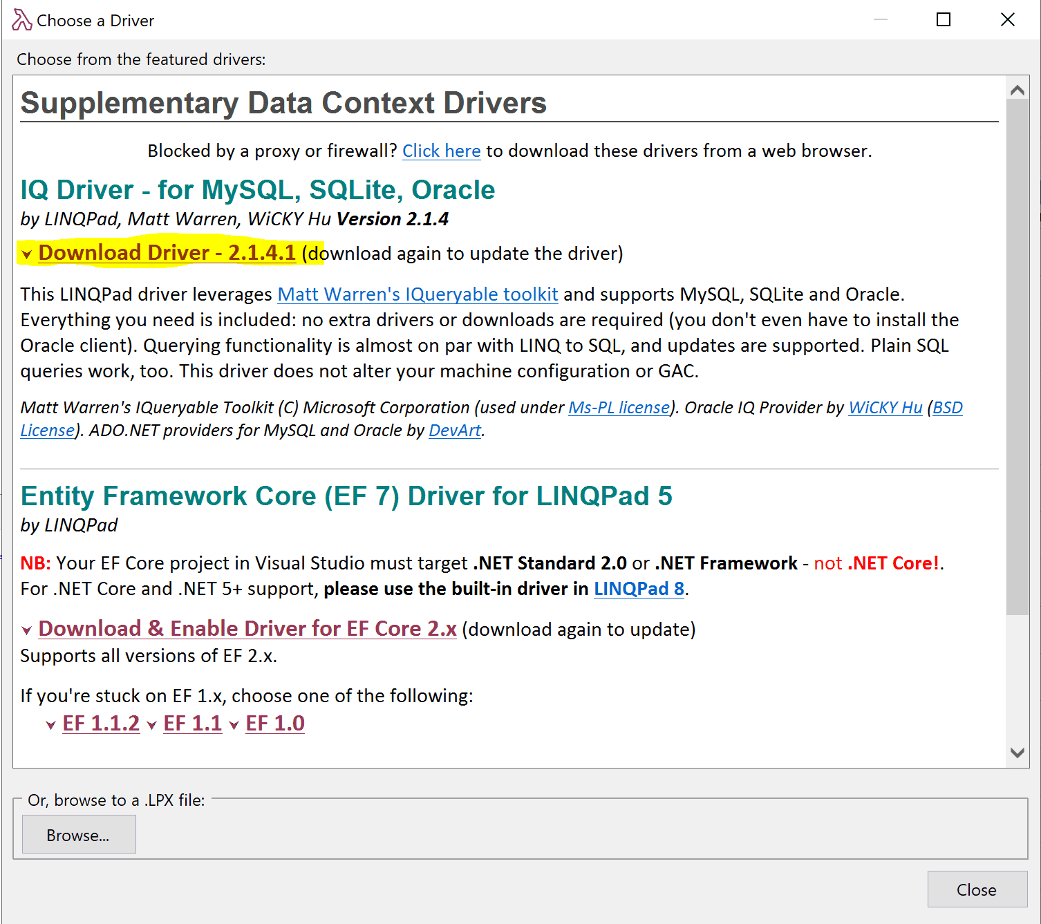

Important note: Starting from version 5.32.0.0, SQL Compact Edition is no longer supported and SQLite is used by default. You can continue using LinqPad to browse logs, but you must add a driver to support SQLite databases. The steps to do this are shown in the screenshots below.

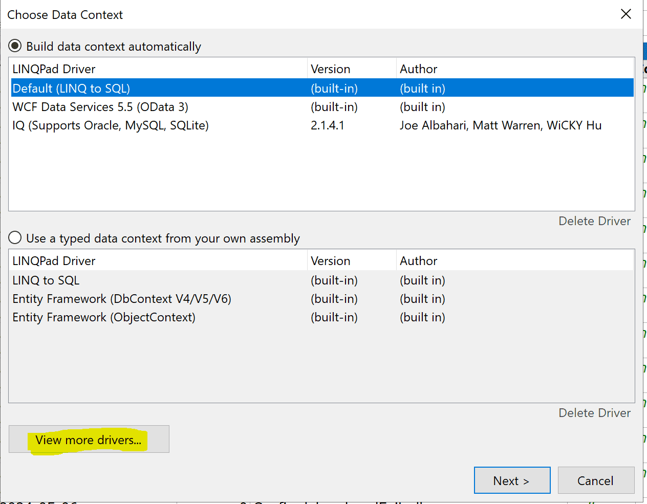

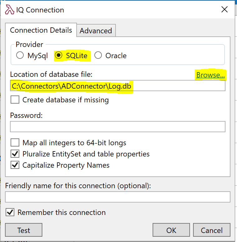

Adding driver
Adding driver
Adding driver
Adding driver
Viewing the log database
By default, all .NET/PowerShell connectors save logs in an SQLite database, so any compatible viewer can be used. An example using one such viewer is shown in the section above. Below are a few example queries for finding and viewing logs:

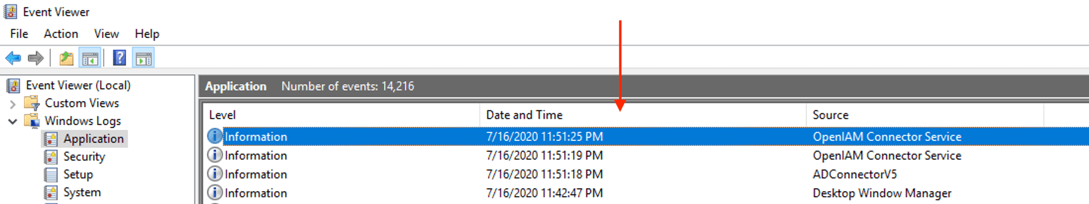

Windows Event Viewer
Important messages may also be sent by the connector to the Windows Event Viewer. This includes situations such as problems starting the service itself — in which case Log.db may not be useful because the service did not start normally. Messages can be found under Windows Logs > Application, filtered by source OpenIAM Connector Service and the ConnectorName provided during installation. Below is an example of how a connector restart appears in the Windows Event Viewer.
EventViewer logs for PowerShell connector

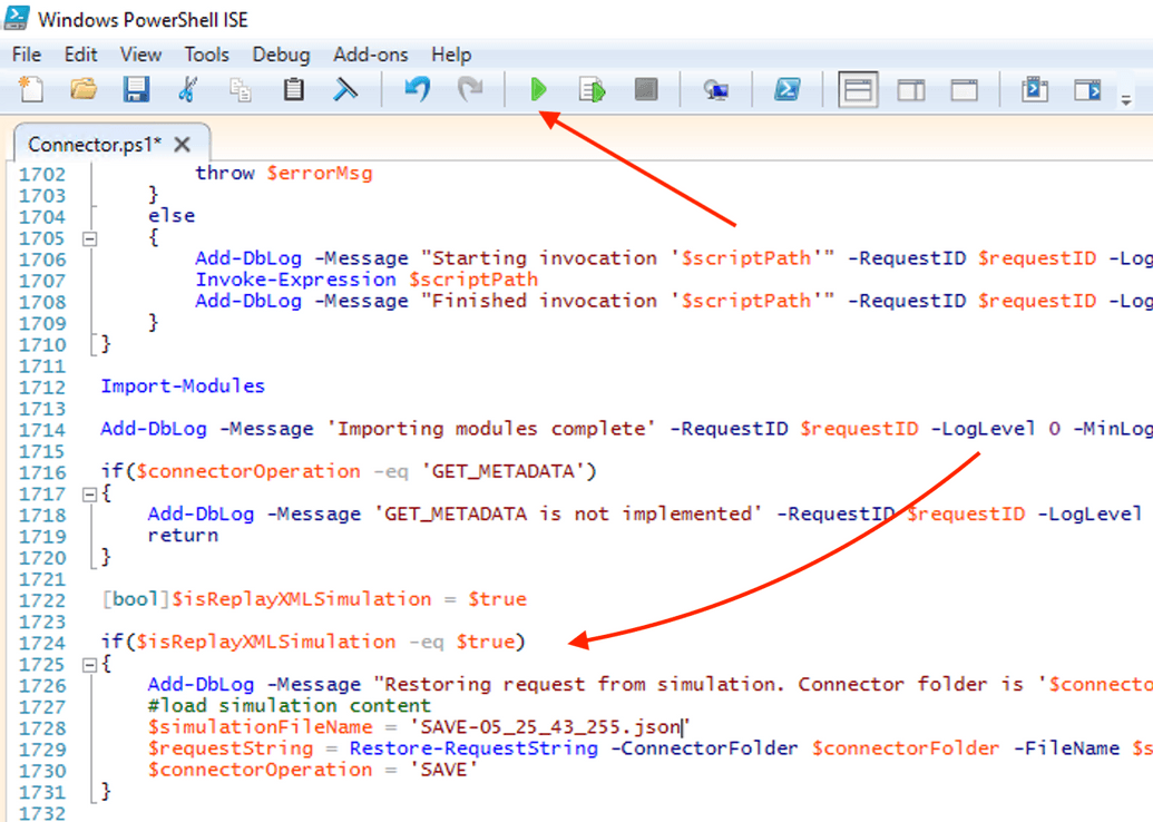

Simulation mode
PowerShell connectors support a Simulation mode, which is a powerful tool for troubleshooting and replaying certain requests.
When debug mode is on and IsSaveRequestEnabled is enabled, the connector creates a JSON file for each request received from OpenIAM. This file contains all request parameters. You can then trigger the connector to reprocess the request from the file, without waiting for a new request from OpenIAM.
Note: For security reasons, all properties related to passwords (containing that keyword) are masked with
. To re-run the request, you must manually edit the file and replace the masked values with the actual passwords.

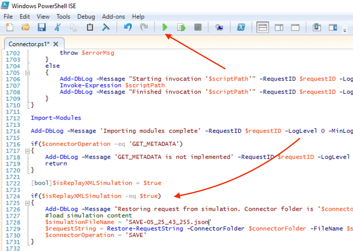

To trigger a replay, open Connector.ps1 in the connector folder and edit the lines below. We recommend using PowerShell ISE for editing PowerShell files.
The initial code snippet to modify:
[bool]$isReplayXMLSimulation = $false
if($isReplayXMLSimulation -eq $true)
Add-DbLog -Message "Restoring request from simulation. Connector folder is '$connectorFolder'" -RequestID $requestID -LogLevel 0 -MinLogLevel $minLogLevel
#load simulation content
$simulationFileName = 'filename.json'
$requestString = Restore-RequestString -ConnectorFolder $connectorFolder -FileName $simulationFileName
$connectorOperation = 'SAVE'
  1. Change $isReplayXMLSimulation to $true.
  2. Set simulationFileName to the name of your file inside the Simulation folder (filename only, not the full path).
  3. Set connectorOperation to the appropriate operation type. Valid options: SAVE, SEARCH, DELETE, RESET_PASSWORD, LOGIN, SUSPEND, RESUME, TEST.
The modified version might look like:
[bool]$isReplayXMLSimulation = $true
$simulationFileName = 'SAVE-05_25_43_255.json'
Note: In simulation mode, read-only operations (Search and Login/password validation) still execute against the managed system normally. Write operations (Save, Delete, Reset password, Suspend, Resume) are skipped and reported back to OpenIAM with a warning indicating that simulation mode is active.
When you apply your changes, you can run and debug the PowerShell script using PowerShell ISE or any appropriate tool.

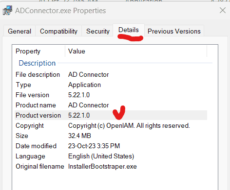

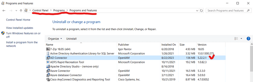

Checking the connector version
It is recommended to use the latest version of the connector. All .NET/PS connectors are backwards compatible, so there will be no issues using the latest connector version with OpenIAM 4.2.0.
To check your current .NET/PS connector version:
If the connector is not installed:
  1. Right-click the installer file and select Properties.
  2. In the window that opens, find the Details section, as shown below.

If the connector is installed:
  1. Go to Control Panel > Programs > Programs and Features.
  2. Find the connector in the list — the version is shown on the same line, as shown below.
Version check when installed
