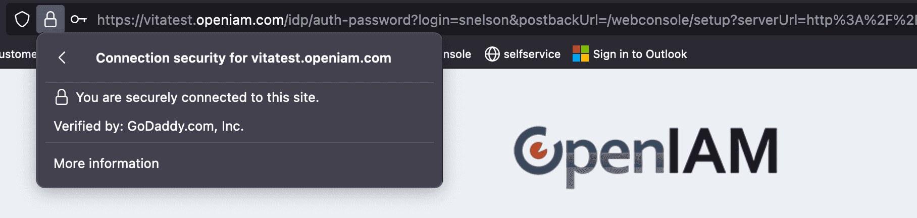

Files from your certificate provider, such as GoDaddy, are:
  • super_openiam_com.crt;
  • super_openiam_com.key;
  • gd_bundle.crt.
GoDaddy files
Now you can restart Apache.
systemctl restart httpd
