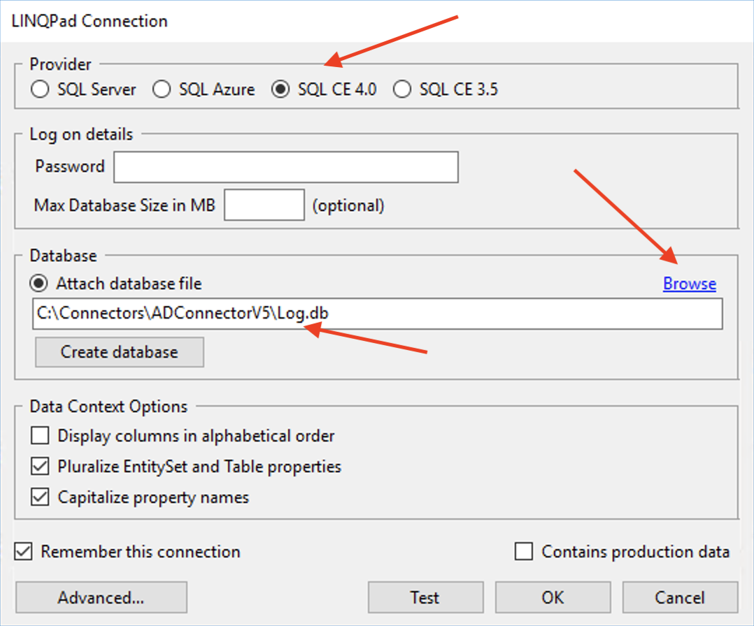

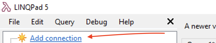

To connect to the log database, you need to start LinqPad and press 'Add connection' like shown on the picture below:
Next, you will need to specify database type and select a Log.db file location.
After this you will see your log database connection on the left side of your screen and you will be able to interact with it like with any normal database.

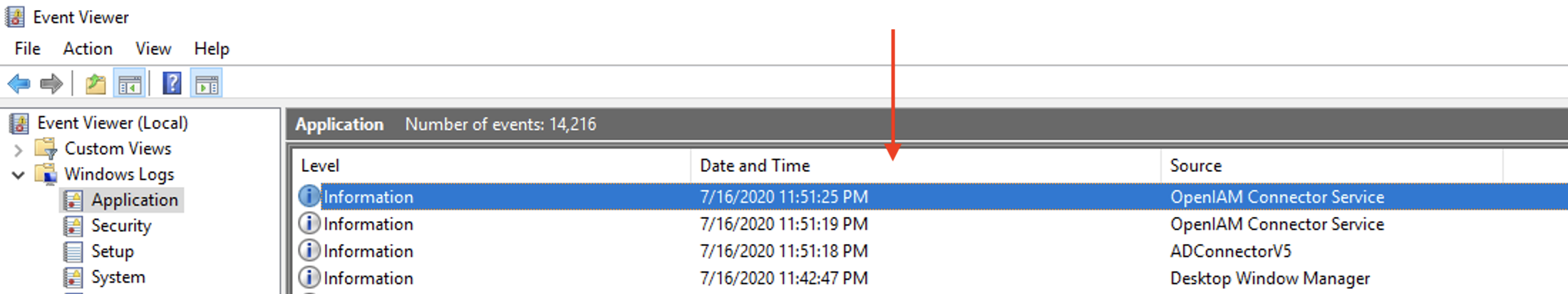

Windows Event Viewer
Important messages may also be sent by the connector to the Windows Event Viewer. It may include various situations like problems with starting the service itself. In this situation the Log.db will not be very useful, because the service was not able to start normally. However, you will be able to see messages in the Windows Event Viewer. Messages can be found in Windows Logs -> Application. Messages can be found by source OpenIAM Connector Service and the ConnectorName that was provided for the connector during installation. Below is an example of how a connector restart looks in the Windows Event Viewer.

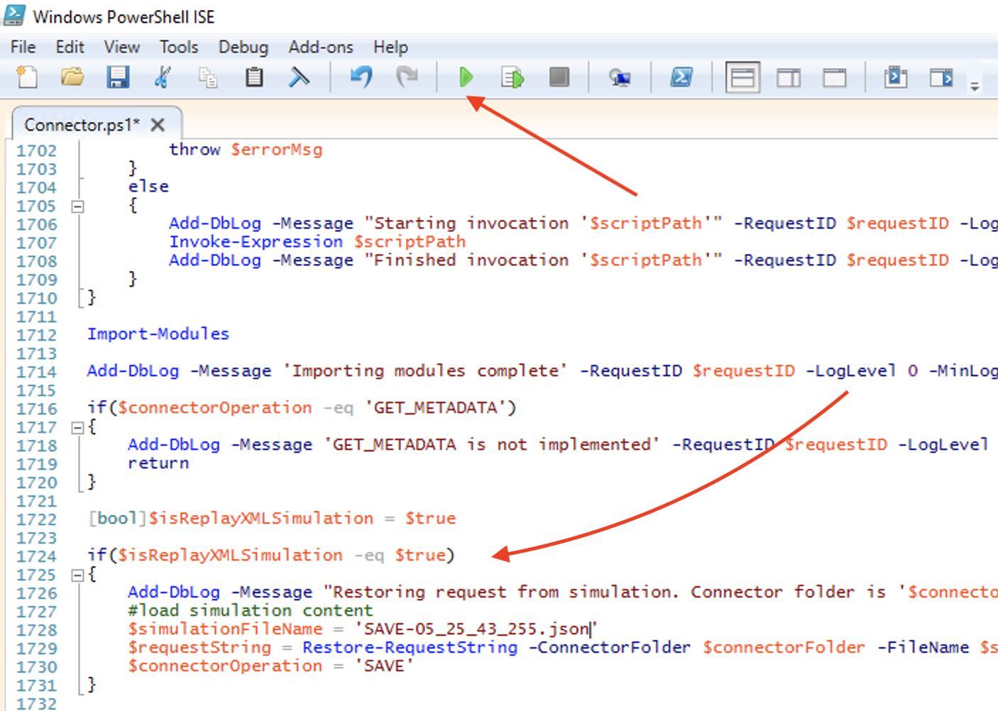

When you have done the above, to trigger the request again you should open Connector.ps1, which is located inside your connector folder and edit the lines. We recommend to use the PowerShell ISE native Windows tool for editing the PowerShell files.
Below is the initial code snippet that we will modify.
[bool]$isReplayXMLSimulation = $falseif($isReplayXMLSimulation -eq $true){Add-DbLog -Message "Restoring request from simulation. Connector folder is '$connectorFolder'" -RequestID $requestID -LogLevel 0 -MinLogLevel $minLogLevel#load simulation content$simulationFileName = 'filename.json'$requestString = Restore-RequestString -ConnectorFolder $connectorFolder -FileName $simulationFileName$connectorOperation = 'SAVE'}
- Change
$isReplayXMLSimulationto $true - Set
simulationFileNameequal to your file name inside the Simulation folder (just filename needed, not the full path) - Set
connectorOperationtype to the connectorOperation variable. Valid options include:SAVE,SEARCH,DELETE,RESET_PASSWORD,LOGIN,SUSPEND,RESUME,TEST
The newly modified version could look like:
[bool]$isReplayXMLSimulation = $trueif($isReplayXMLSimulation -eq $true){Add-DbLog -Message "Restoring request from simulation. Connector folder is '$connectorFolder'" -RequestID $requestID -LogLevel 0 -MinLogLevel $minLogLevel#load simulation content$simulationFileName = 'SAVE-05_25_43_255.json'$requestString = Restore-RequestString -ConnectorFolder $connectorFolder -FileName $simulationFileName$connectorOperation = 'SAVE'}
When you apply your changes, you can run and debug the PowerShell script using PowerShell ISE or any appropriate tool.
