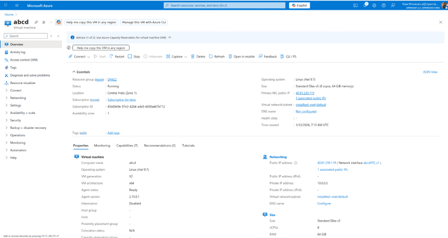

To install OpenIAM with a remote Oracle DB, prepare the DB first. Start with creating a VM in Azure.
Type Red hat in a search engine and select Red Hat Enterprise Linux (RHEL) RAW for Microsoft Azure > Red Hat Enterprise Linux 9.7 RAW with cloud-init or Rocky Linux and select Rocky Linux for x86_64 (AMD64) official > Rocky Linux 9.

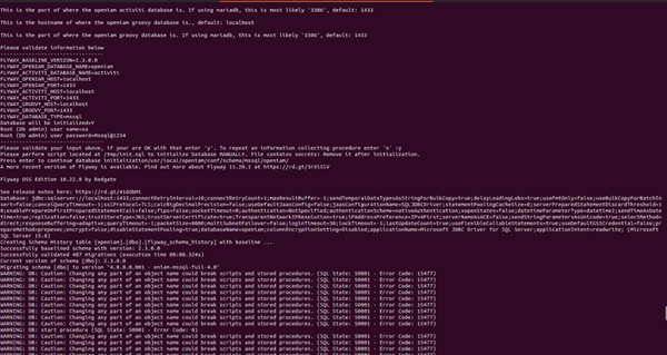

During database configuration, the system will display auto-populated values (default is typically mysql). You must explicitly specify the database type - Enter mssql in addition to or instead of the default value. Press Enter to confirm.
Note: Ensure that MSSQL is correctly provided as the database type. The default MySQL value should not be used in this setup.
Do you want to initialize OpenIAM Schema and Users? (y/n): Enter y if the database schema and users have not yet been created. This step requires database administrator (superuser) credentials.
  • Provide the credentials for the MSSQL administrative user:
Enter username for superuser (default: root):
sa
Enter password for superuser:
Mssql@1234
Ensure that the credentials match your MSSQL server configuration.
  • Confirm Configuration Review all entered details carefully. Enter y to confirm and proceed with the installation.
