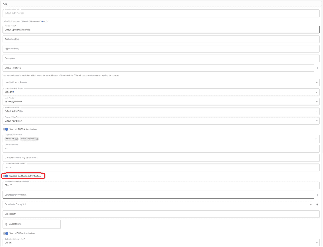

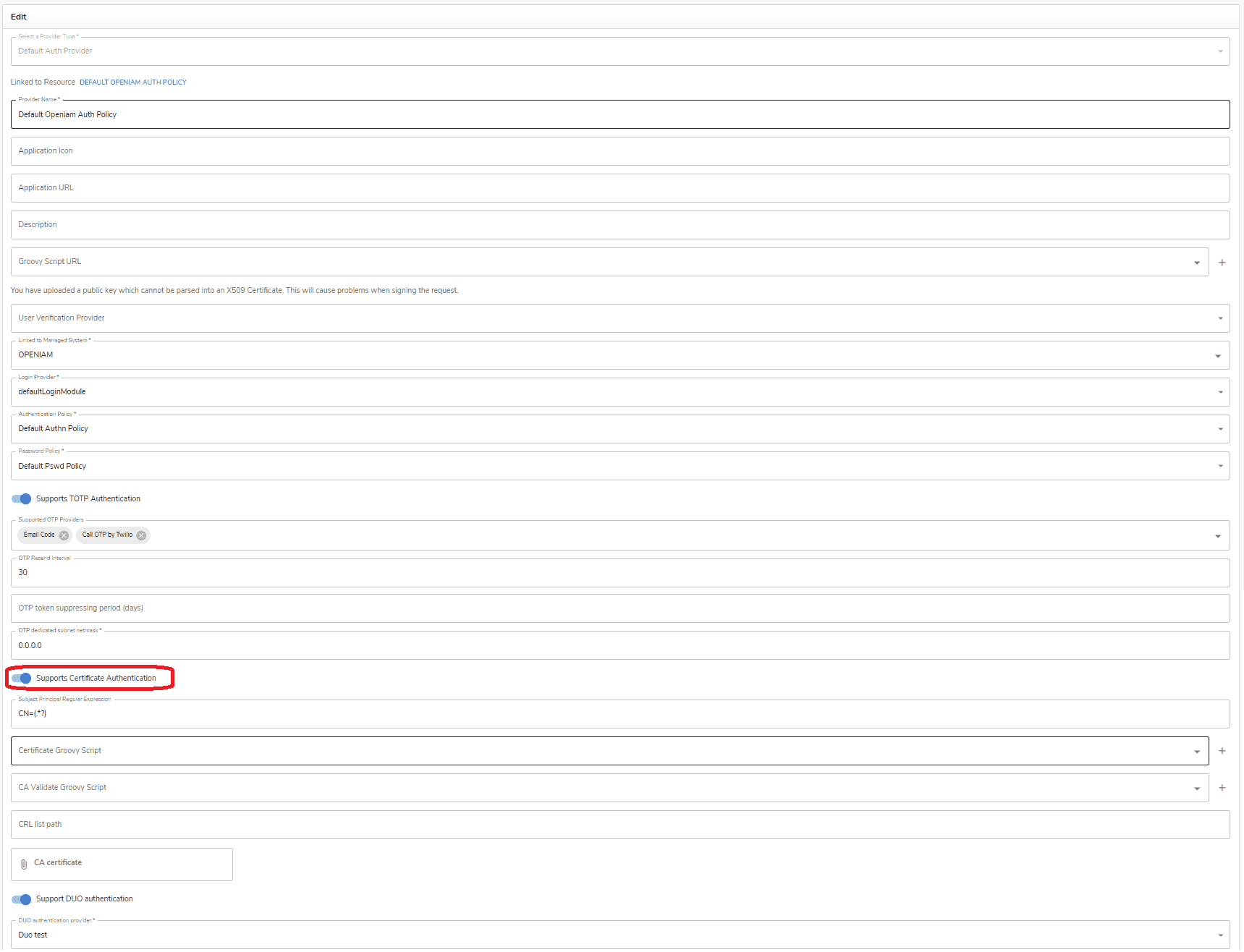

Navigate to the current Authentication Provider in Access Control > Authentication Providers, and enable Certificate-Based Authentication, as shown in the figures below.
Default Auth Provider
Now, there are two options for mapping the certificate to a user principal:
  • Add a Regular Expression to the Certificate: This will extract the principal from the matching group in the Regex.
    Example: CN=(.*?)
  • Define a Custom Groovy Script: Use a script with custom logic to parse the certificate and determine the principal.

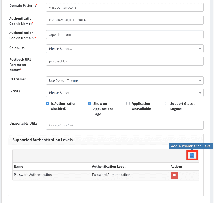

Configuring Content Provider
You can configure this in the Content Provider screen: Access Control > Content Providers. Navigate to Authentication Levels and add Certificate Authentication, as shown below.
Add Auth Level
If a warning appears about modifying default settings, click Yes.
Warning
Add Certificate Authentication with the steps described below.
Add CertAuth Save CertAuth

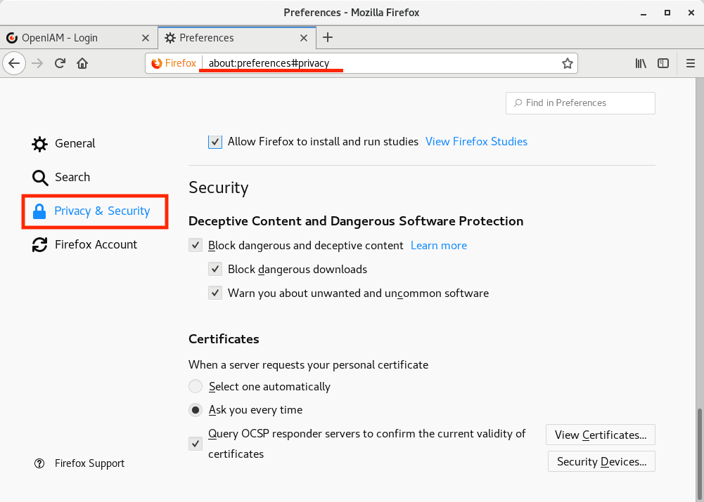

Go to the certificates configuration as shown below.

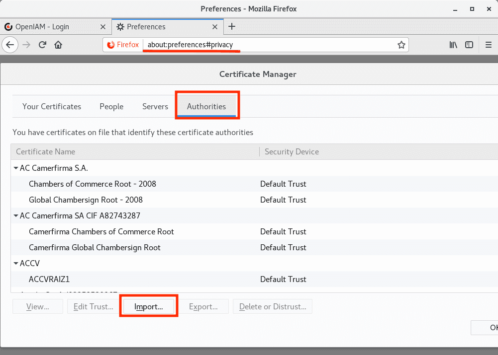

Certificates Config Authorities
Import ca.crt into Authorities.

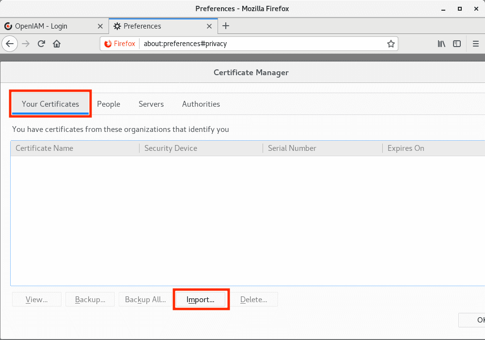

Install user1.p12 into Your Certificates.

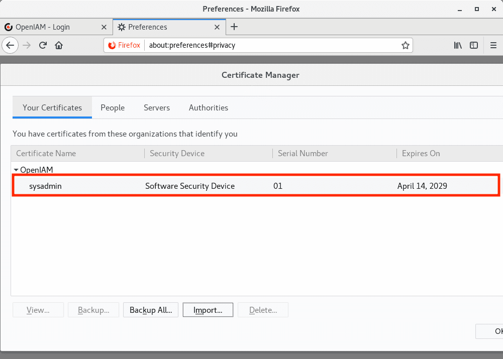

Check that the user certificate was successfully added.
User Certificates Added
