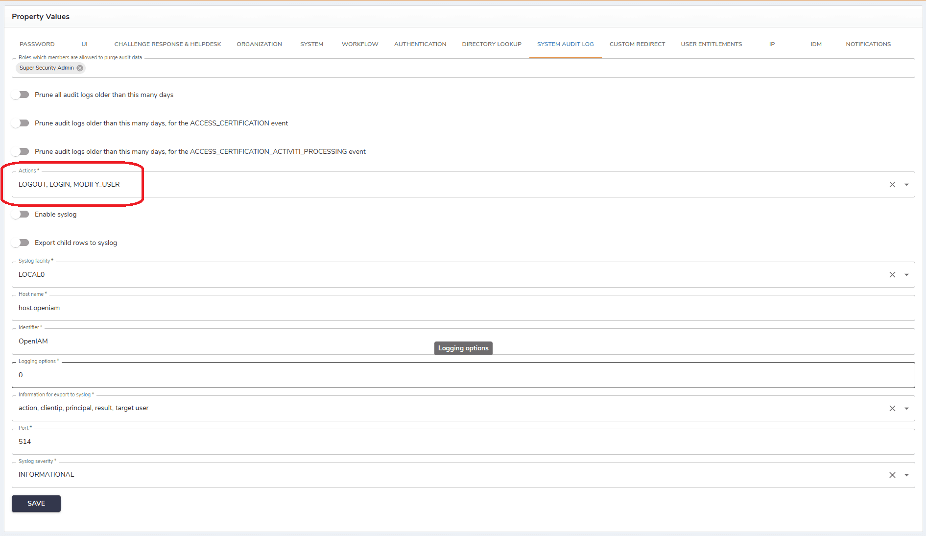

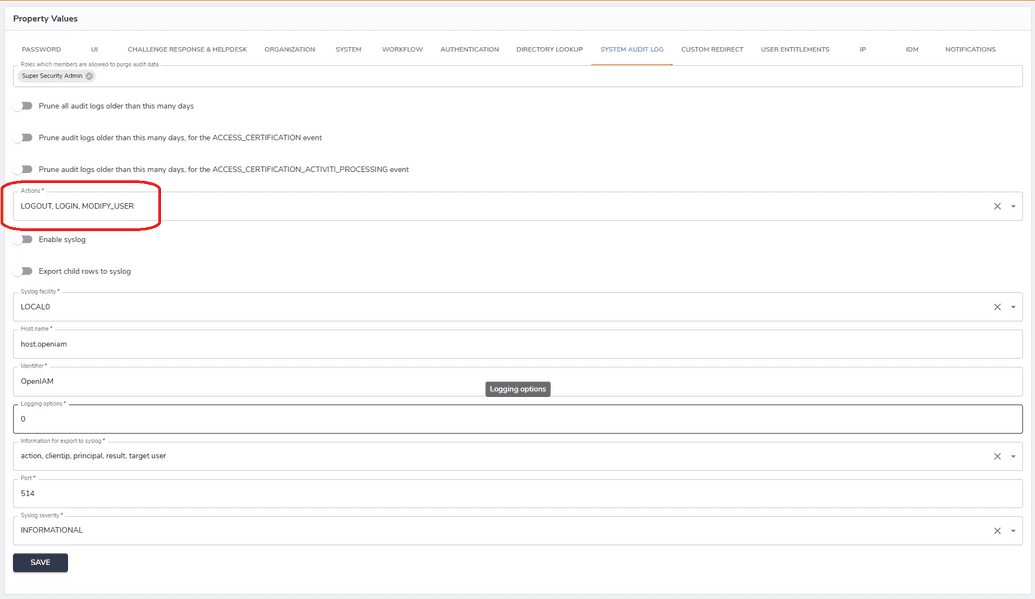

ActionsAudit logs actions to add to syslog.LOGIN, LOGOUT
Enable syslogTurns syslog on/off.Checked / Unchecked
Export child rows to syslogAllows exporting child rows of the audit log.On / Off

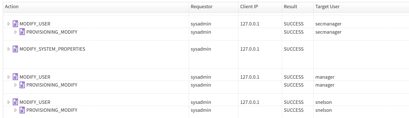

Below you can see an option of having a MODIFYUSER action, which can export to syslog without the _Export child rows to syslog checkbox. But for exporting the PROVISION_MODIFY action, the user needs to check the checkbox.
Modify user action
FieldDescriptionDefault Value
Syslog facilityThe syslog facility name.LOCAL0
Host nameHost name of the server where syslog is placed.
IdentifierIdentifier in syslogOpenIAM
Information for export to syslogAudit log information which will be added to syslog.

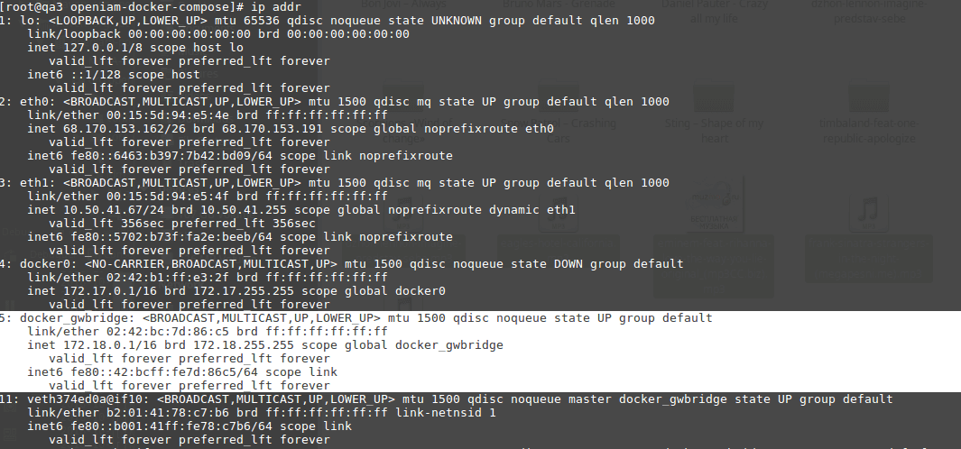

  1. Detect the Docker server IP for containers.
Docker syslog

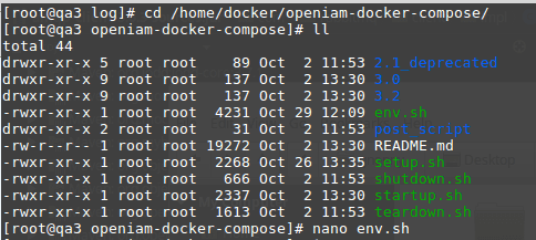

  1. Set properties in env.sh.
Properties
Host name:
export SYS_LOG_HOST=host.openiam
IP:
export DOCKER_HOST_IP=172.18.0.1

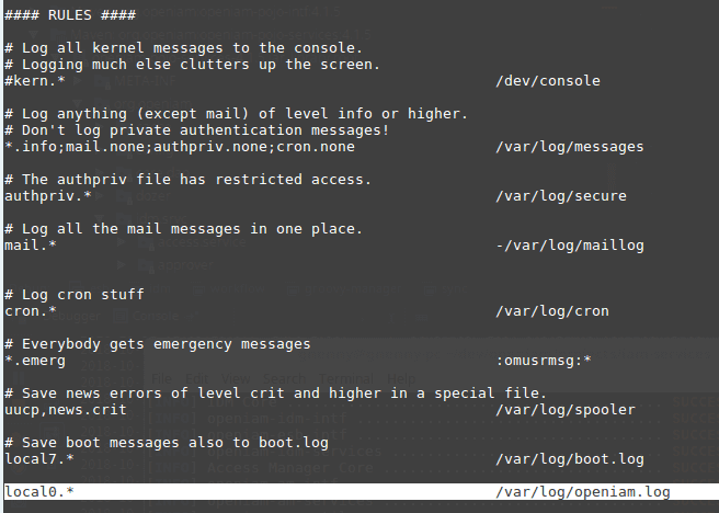

  1. Set the file for logs from OpenIAM in rsyslog:
nano /etc/rsyslog.conf
Setting a file for syslog

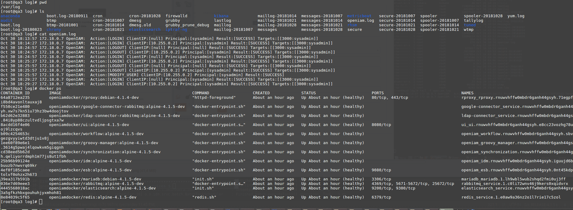

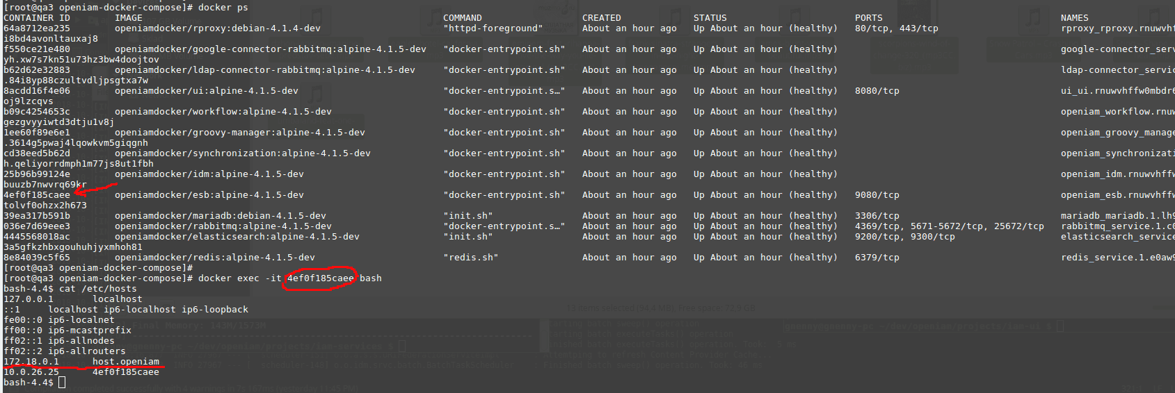

  1. Start Docker containers and check /etc/hosts:
Starting Docker containers

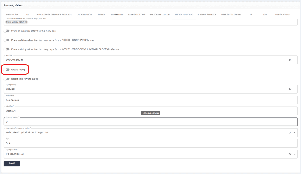

  1. Enable system audit log in OpenIAM properties:
OpenIAM log properties
After about 5 minutes, the logs will be sent to system logs.
  1. Check system logs on the Docker server:
Logs check on server

To set the output file, you can add a row like the following:
local0.* /var/log/openiam.log

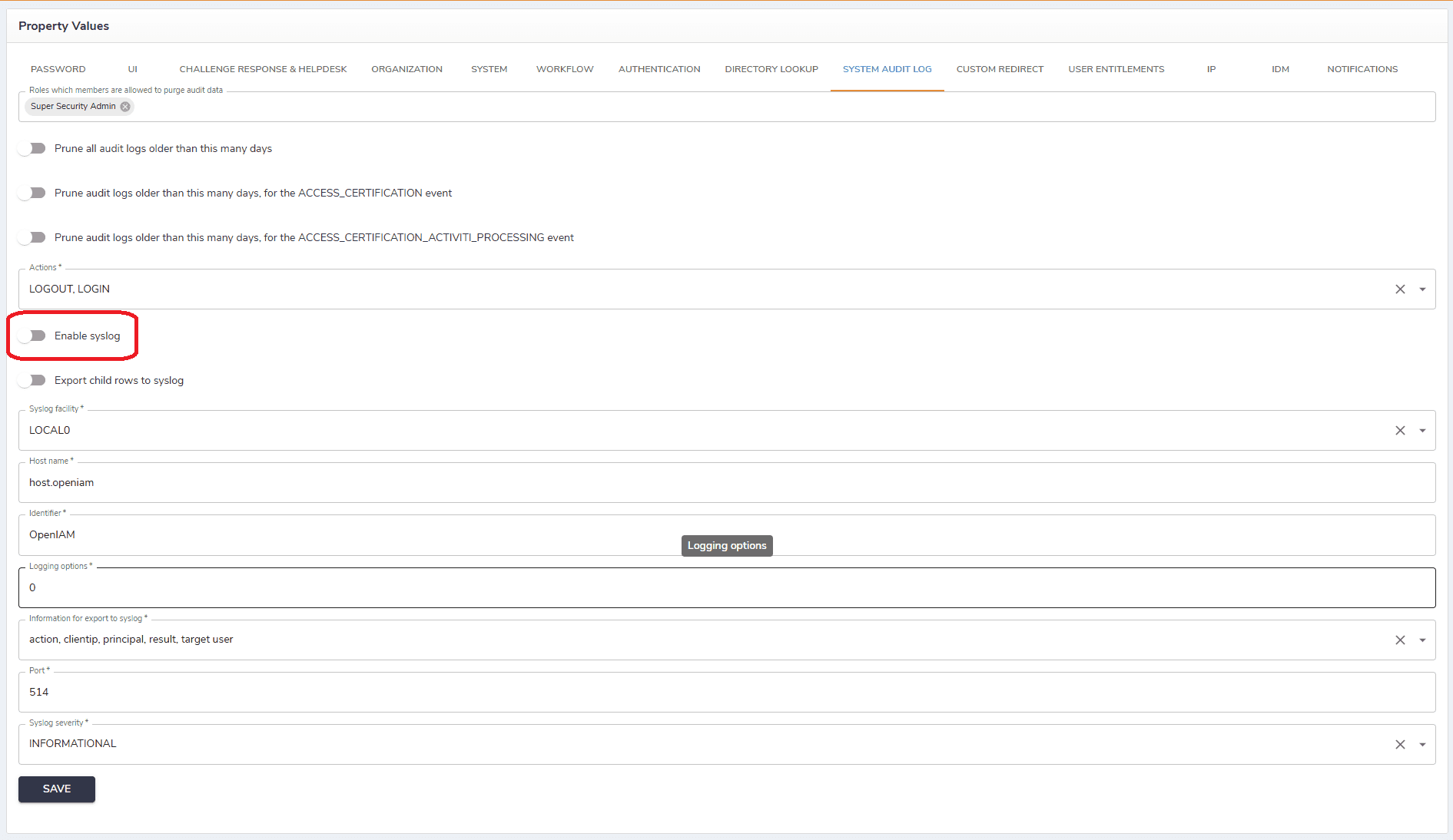

If Ubuntu is an external server, you only need to check the Enable syslog checkbox and set the correct external IP. This can be done provided your Kubernetes configuration has access to the internet.
To do so, go to web console > Administration > System configuration > System audit log tab and check the respective checkbox, as shown below.
Checkbox
