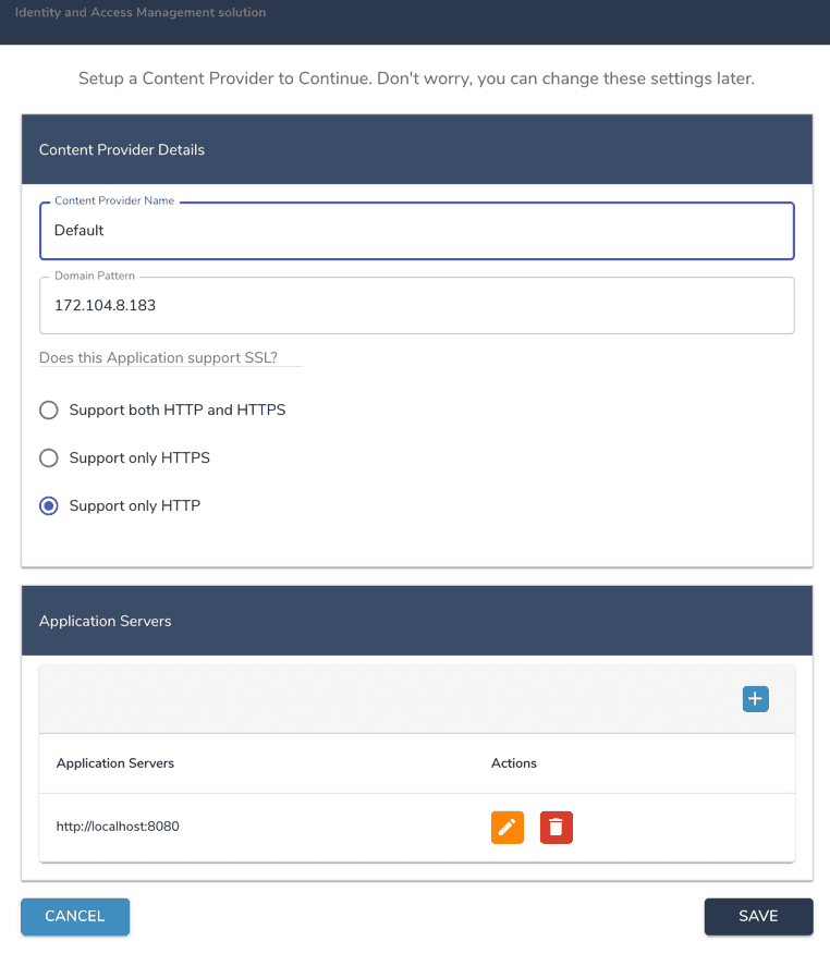

After setting up the content provider, you will be taken to the challenge questions page. These questions will be used to reset your admin account in case you have locked yourself out. Please make a note of your answers.
After completing the above steps, you will be taken to the admin console landing page shown below. Give the system about 5 min to refresh the internal cache and then you can proceed to configure your solution.

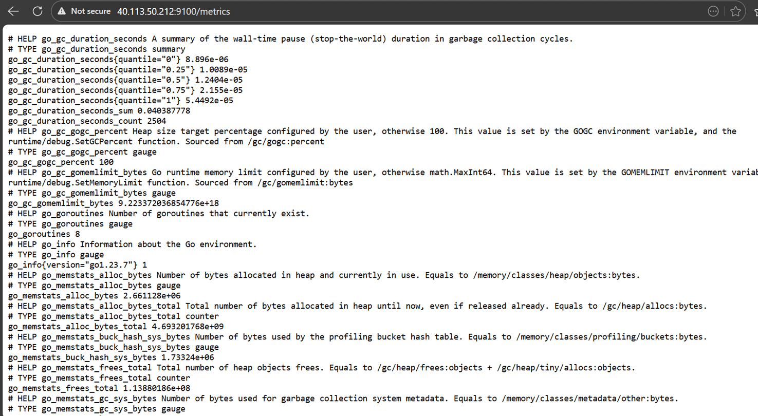

Verify node-exporter metrics with the following command.
curl http://localhost:9100/metrics

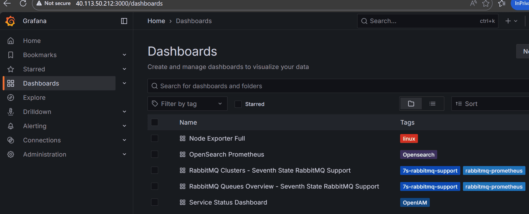

For Grafana access from outside using public IP
For Grafana access, default user will be admin and password will be admin.
http://<Ip of VM>:3000
Grafana dashboard

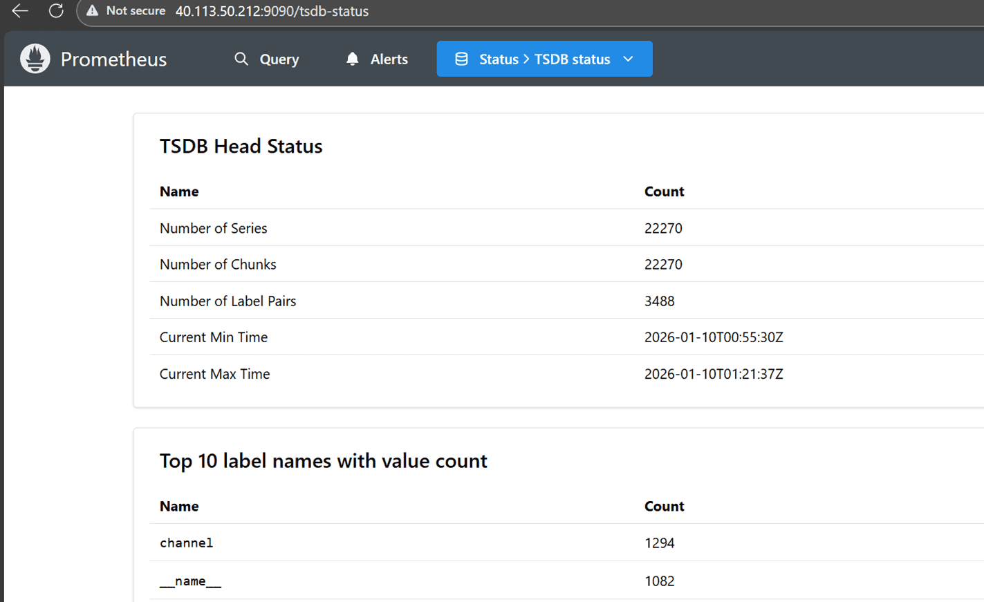

For external Prometheus access
Change web.listen-address from 127.0.0.1 to 0.0.0.0 in below service file.
vi /etc/systemd/system/prometheus.service
Now, reload and restart Prometheus using the commands bellow.
systemctl daemon-reexec
systemctl daemon-reload
systemctl restart Prometheus
Try to access using the http://<Ip of VM>:9090 URL.
Prometheus
For node exporter metrics access
Use the http://<Ip of VM>:9100/metrics URL for the access.
