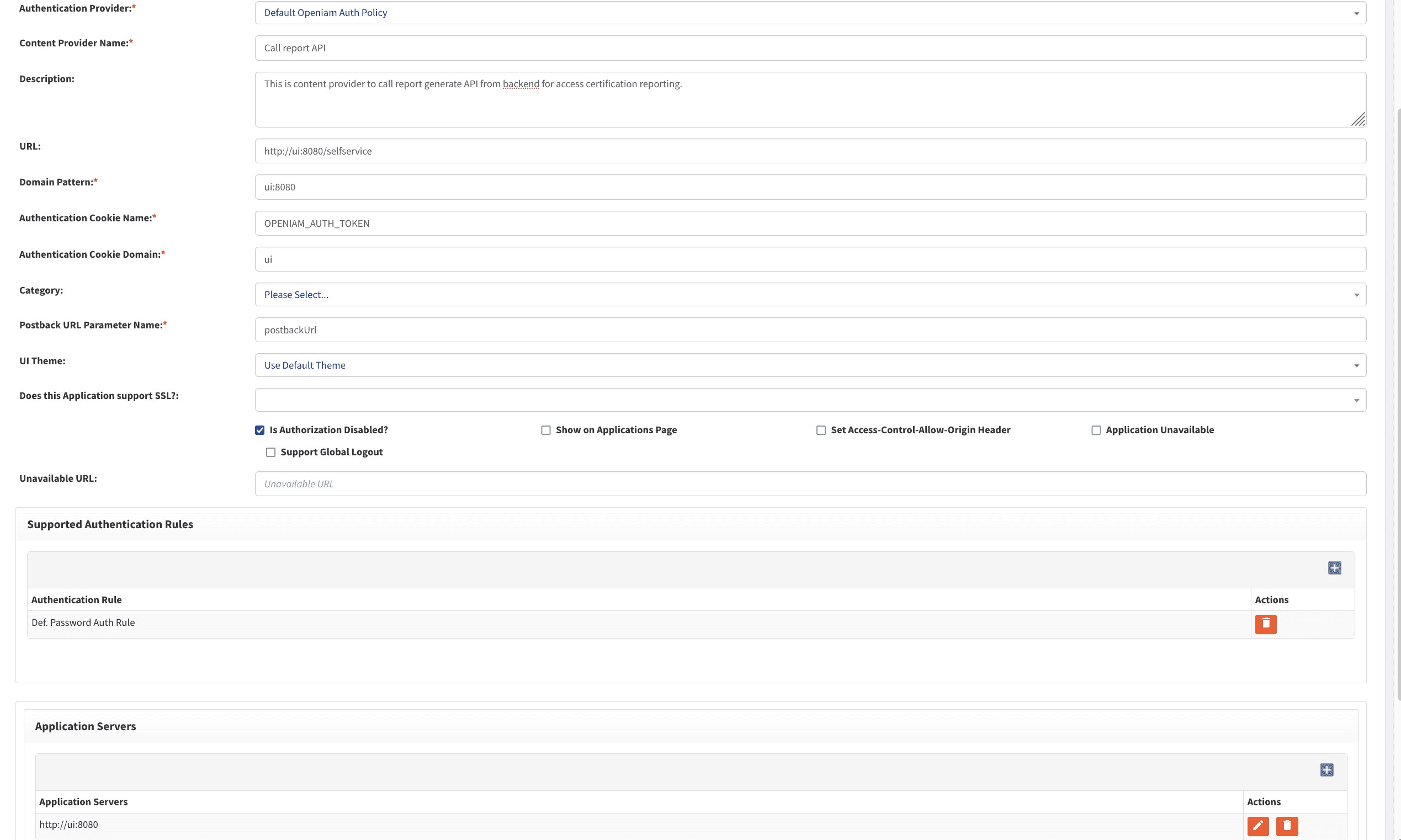

- Create a content provider. You can name it Call report API or give it any other applicable name.
Below is an example of the content provider configuration when running OpenIAM in Docker.

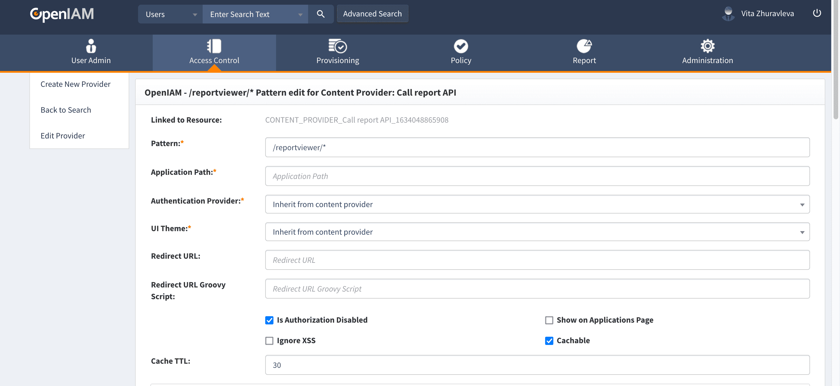

- Save it and add one
/reportviewer/*
URL pattern. Click Create in the URI Patterns section.

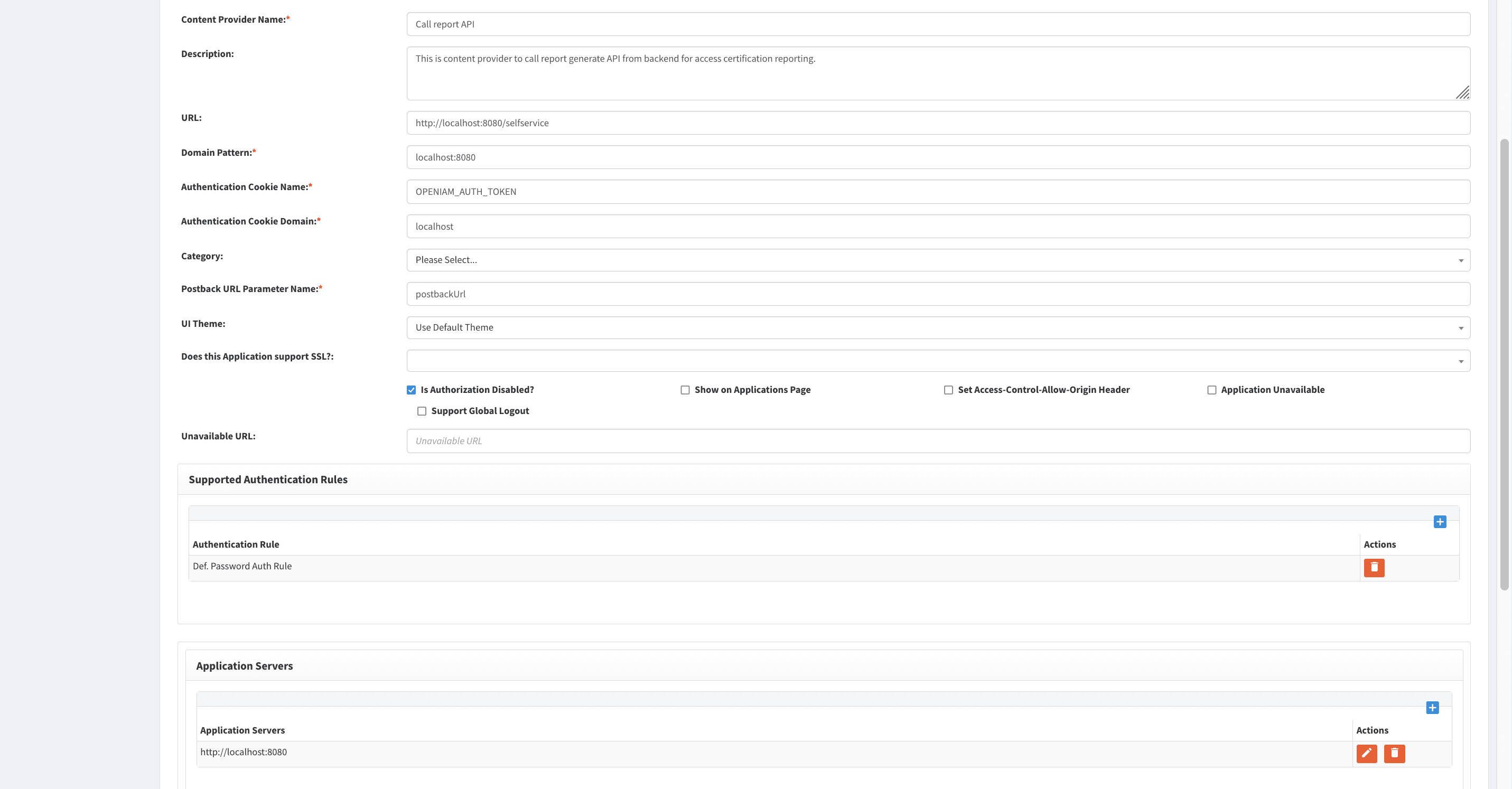

If you are using RPM as your installation environment, use localhost
instead of ui
(see the screenshot below).
This URL will be called by OpenIAM as a background task to generate the scope and results report.
