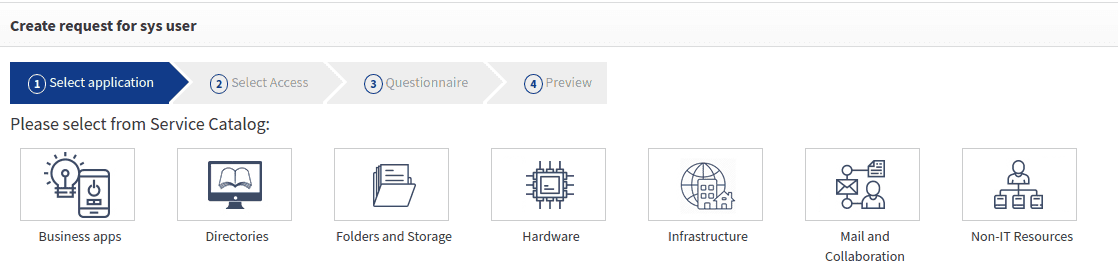

If you go to SelfService > Create request for myself > Select from service catalog, you will see that the catalog is structured by categories, as shown below. This structure is a default model, and you can customize it to meet your organization's needs. This categorization structure and appropriate naming can have a significant impact on how easily end-users can navigate the catalog and find what they need.

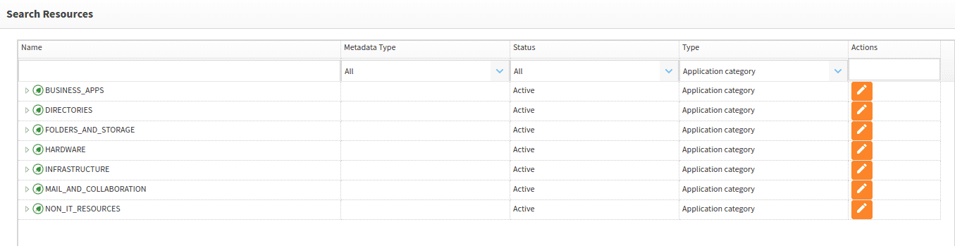

To view the existing category structure, go to webconsole > Access Control > Resource, and filter by Application Category as shown below.
OTB categories
You can modify or remove these categories based on your needs.

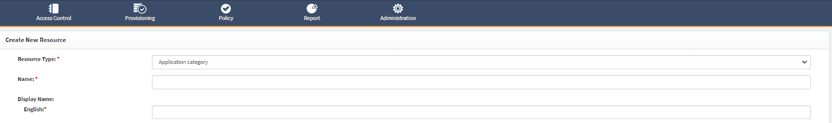

To create a new category, go to webconsole > Access Control > Resource and click Create New Resource in the side menu bar.
New resource
Complete the fields shown in the table below.
Field NameDescription
Resource TypeSelect Application category from the dropdown. This setting determines which type of resource you are creating.
NameName of your category. This value can be any short descriptive name.
Display nameThis is the value that end-users will see. It should be a short descriptive name that is meaningful to end-users. This field has been localized, and you should complete the localization for the languages you need to support.
StatusFlag that determines if this resource is active (visible) or inactive (hidden from all users).
Is visible or Is public flags do not impact category behavior in the SelfService application catalog.
If you need to support multiple languages, complete the display name values for the necessary languages.
Save your category. You should see it appear in SelfService as well.

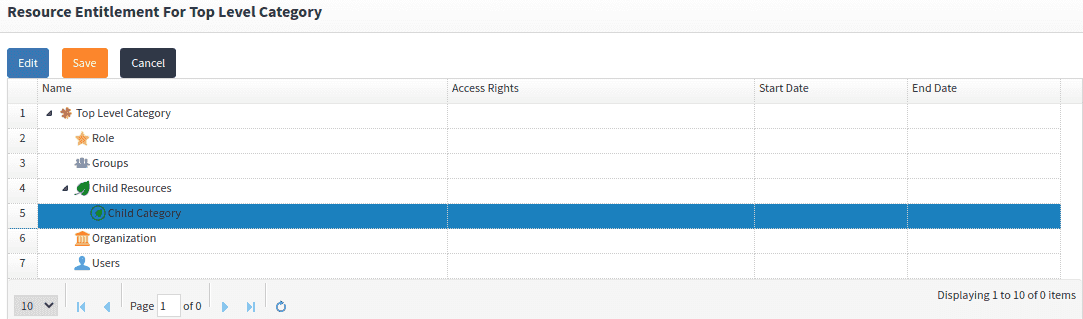

In some cases, when working with a large number of applications, you may want to nest your category structure. To create a child category, follow the steps below:
  1. Create a new category as described in the previous step.
  2. Find the parent category by going to webconsole > Access Control > Resource, and search for the name of the category.
  3. Click the Actions button to view the resource details.
  4. From the side menu bar, click Entitlements.
  5. Right-click on Child resource and then click Add.
  6. From the dropdowns, first select Application category, and then the name of your category in the second dropdown.
The parent-child relationship should appear like in the example below.
