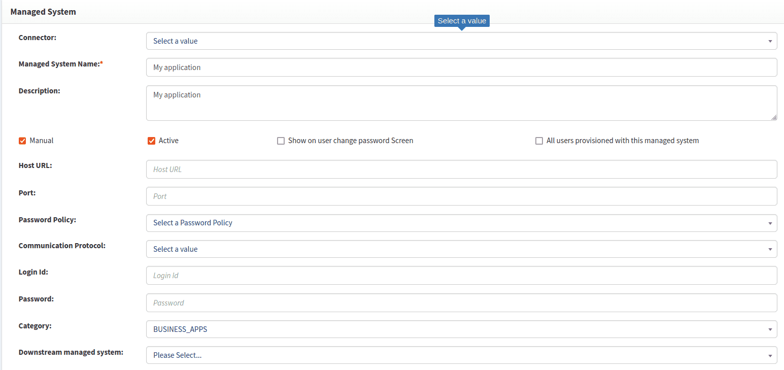

  • Log in to the webconsole and navigate to Provisioning > Synchronization.
  • Click on Create managed system from the side menu. The system will render the screen as shown below.
Populate the screen using the values from the table below.
Field NameDescription
ConnectorLeave this field blank for manual applications.
Managed System NameName of the managed system configuration or application.
DescriptionDescription of the application to help end-users recognize it in the service catalog.
ManualEnable this checkbox for manual applications.
ActiveEnable this checkbox to indicate that this configuration is active. Uncheck it to disable the application in the catalog.
CategorySelect the service catalog category where you want your application to appear.

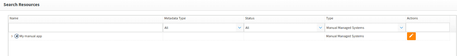

  • Log in to the webconsole and navigate to Access control > Resource.
  • Filter the list of resources by Manual managed system, as shown in the image below.
Managed system resource

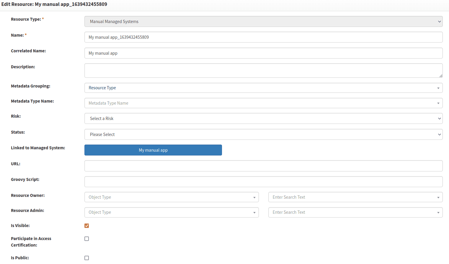

After finding your application, click on the application's Actions button to view the resource/managed system details, as shown below.
View managed system resource

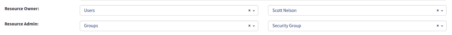

Here, you will see two fields: Resource owner and Resource admin. To define either the resource owner (aka Application owner) or the resource admin (aka Application admin), follow the steps below:
  • Select whether the owner or admin will be a User or a Group in the first dropdown. If it's a group, then anyone in the group can approve.
  • Select the name of the user or group in the second field.

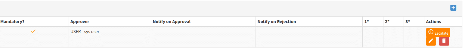

By default, the sysadmin account is assigned as an approver. To modify the first approver, click on the Actions button and change the approver, as shown below.
Approval step
Field nameDescription
ApproverDefines who will approve a request. This can be selected users, the requestee's immediate supervisor, a group, people in a role, the application owner, or the application admin.
Notify on approvalPerson to notify when a request has been approved.
Notify on rejectionPerson to notify when a request has been rejected.
1*Number of reminders to send to the approver to encourage them to complete the request.
2*Number of days to wait before sending a reminder notice.
3*Days to escalation. This value is calculated based on the values in 1 and 2.
To add additional approval steps, click on the + icon and complete the row as described above.
