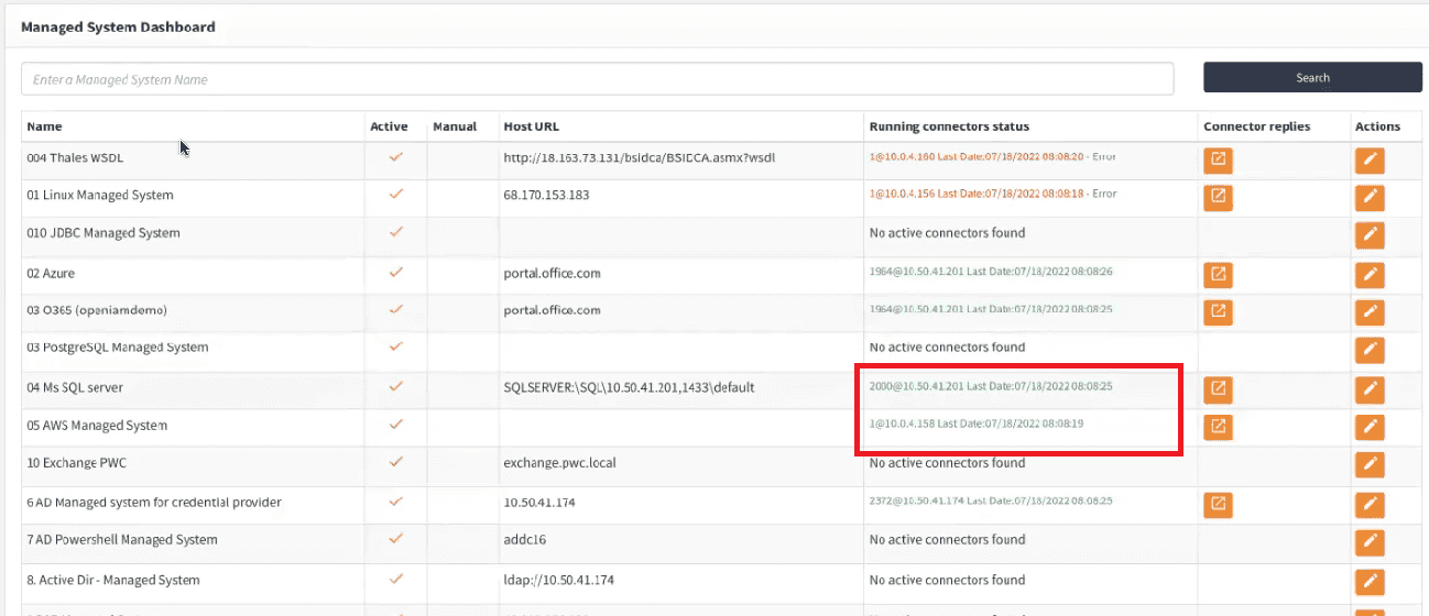

For the synchronization process to be successful, make sure the Managed system and Connector shall be running. To check it, go to Provisioning -> Managed Systems and in the search box find the required managed system. The code for the needed managed system in the Running connector status field shall be of green color as shown below.

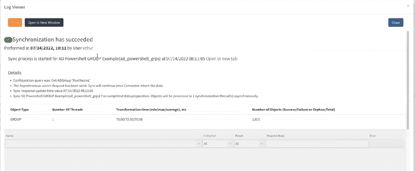

To check whether the synchronization was successful, synchronization audit is used. To access it go to Administration -> Log Viewer and type Synchronization in the search box. Here, one can see all synchronizations made using the connector. Synchronization audit log is the first place to search whenever a synchronization error occurs.
When opening the log, one can the details about this synchronization session, as shown below.

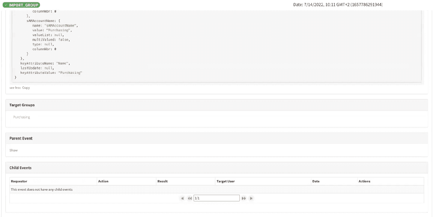

Synchronization results are displayed in Name section, this link is clickable, and it shows the details about an individual string that has been imported. The detailed screen is shown below.
The Target Group string is also clickable. After clicking it, you will be sent to Group editing template.
