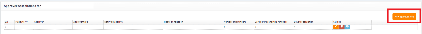

  • Define the approval flow:
    • Click on the Approval Associations menu from the sidebar.
    • Click on New approver step. It will open a row where you can define the approver.
Add approver - step1
Complete the fields in the approval flow as described below:
  • Approver – Select the type of approver followed by the name of the approver. The table below describes each of the approval options.
  • Notify on Approval – Select who should be notified after this step has been approved.
  • Notify on Reject – Select who should be notified if this step is not approved.
  • Request service level agreement parameters
    • 1* – Number of reminders to be sent to the approver.
    • 2* – Number of days before sending a reminder.
    • 3* – Calculated value of the maximum time allowed to complete the step.
  • Save your configuration (this must be done independently of the page save operation).
To add additional approval steps, simply save the first approver and click on New approver step again.
