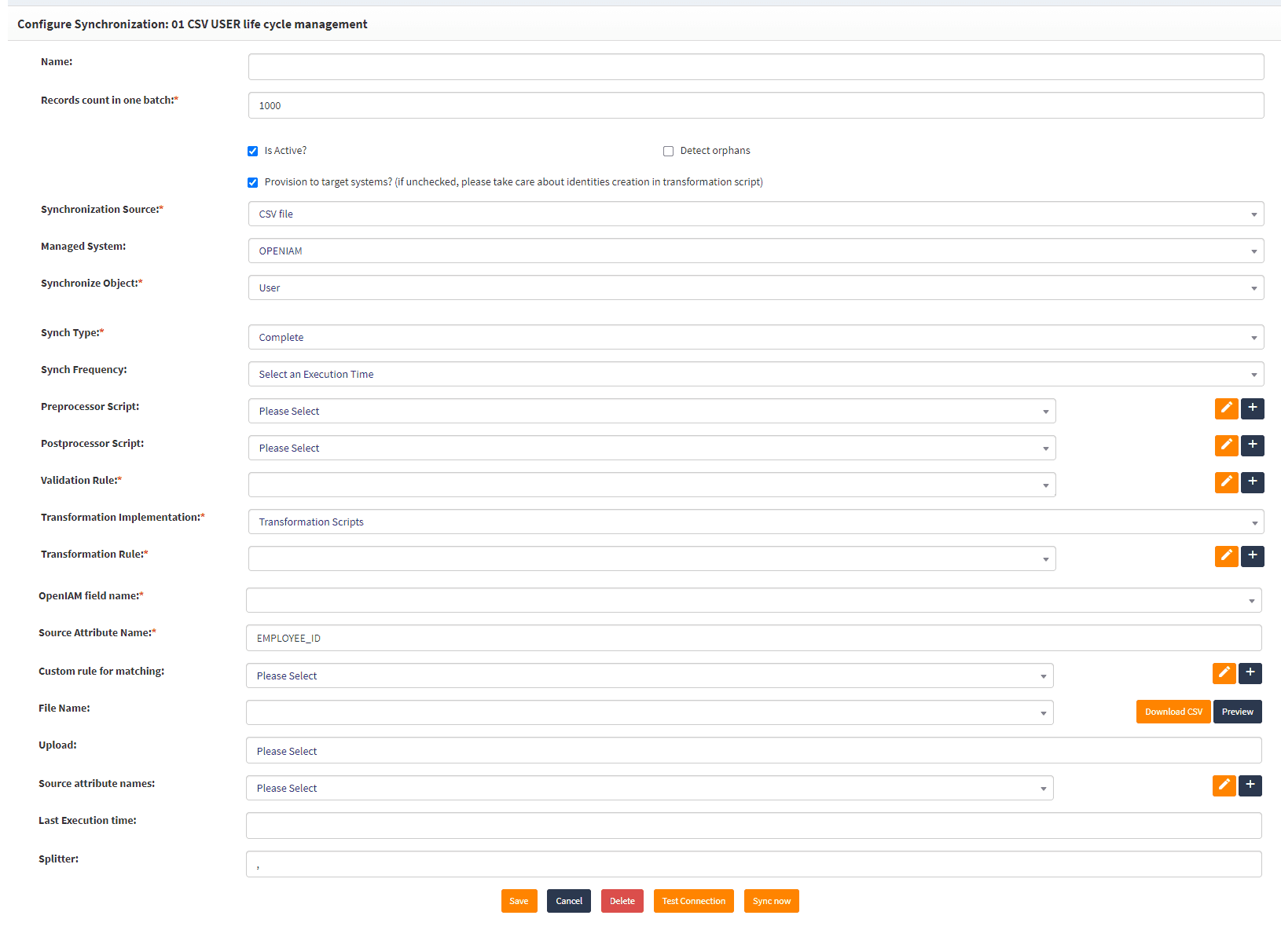

To configure synchronization, follow these steps:
  1. Go to webconsole > Provisioning > *Synchronization.
  2. Several examples are provided to help you get started. If you are new to OpenIAM, we recommend leveraging these examples rather than creating a configuration from scratch. The following steps describe how to create a new configuration.
  3. Click Create Synchronization. You will see the screen below. Complete the form as described in the table.
Synchronization configuration
Field NameDescription
NameA descriptive name to identify this configuration.
Records count in one batchDefault is 1000. This determines how many users/records are processed per batch. Adjust this for performance: a higher number increases throughput, but excessive threads may reduce performance. If your transformation scripts are resource-intensive (e.g., >10 seconds per user), consider reducing this number to avoid exceeding the 30-minute RabbitMQ queue limit.
Is Active?Determines whether this synchronization configuration can be executed. If inactive, the sync will not run.
Detect orphanThis should not be enabled for data from a source system. Orphan detection is used for target systems and is covered in the Orphan Management section.
Provision to target systems?Enables downstream provisioning. After configuring synchronization and managed systems, this checkbox must be enabled for downstream provisioning to occur.
Synchronization SourceSpecifies whether data will be imported via a connector or CSV file. Choose accordingly.
Managed SystemDefines which managed system the user should be added to. For automated provisioning, use OpenIAM; provisioning targets are then defined in the transformation script.
Synchronization ObjectSelect the type of object being imported. Typically, choose User.
Synch TypeChoose between Complete or Incremental. Use Complete during development. For production, use Incremental if the source supports change detection (e.g., using whenChanged in LDAP).
Synch FrequencyDefines how often synchronization runs. If a value is entered, a scheduled task will be created. Ensure the CRON expression is valid.
Example: To run every 24 hours, use 0 */24 * * * ?
Pre-Processor ScriptGroovy script that runs before synchronization starts.
Post-Processor ScriptGroovy script that runs after synchronization completes.
Validation RuleGroovy script used to validate incoming data.
Transformation ImplementationChoose between Policy Map or Transformation Script. Select Transformation Scripts.
Transformation RuleGroovy script that maps incoming data to OpenIAM-compatible objects. Most sync logic resides here.
IDM Repository FieldUnique identifier for users in OpenIAM. Options: EMPLOYEE ID, IDM USER ID, PRIMARY EMAIL ADDRESS, PRINCIPAL NAME, or CUSTOM ATTRIBUTE.
Source Attribute NameUnique identifier from the source system.
Custom Rule for MatchingUse a Groovy script for complex matching logic when a single attribute is insufficient.
Attribute Names LookupScript that defines which source attributes are available in the transformation script. Must be set if using connectors like LDAP/AD.
File NameThe name of the uploaded CSV file. Use the Choose file button to upload.
SplitterCSV delimiter. Examples: ,, `

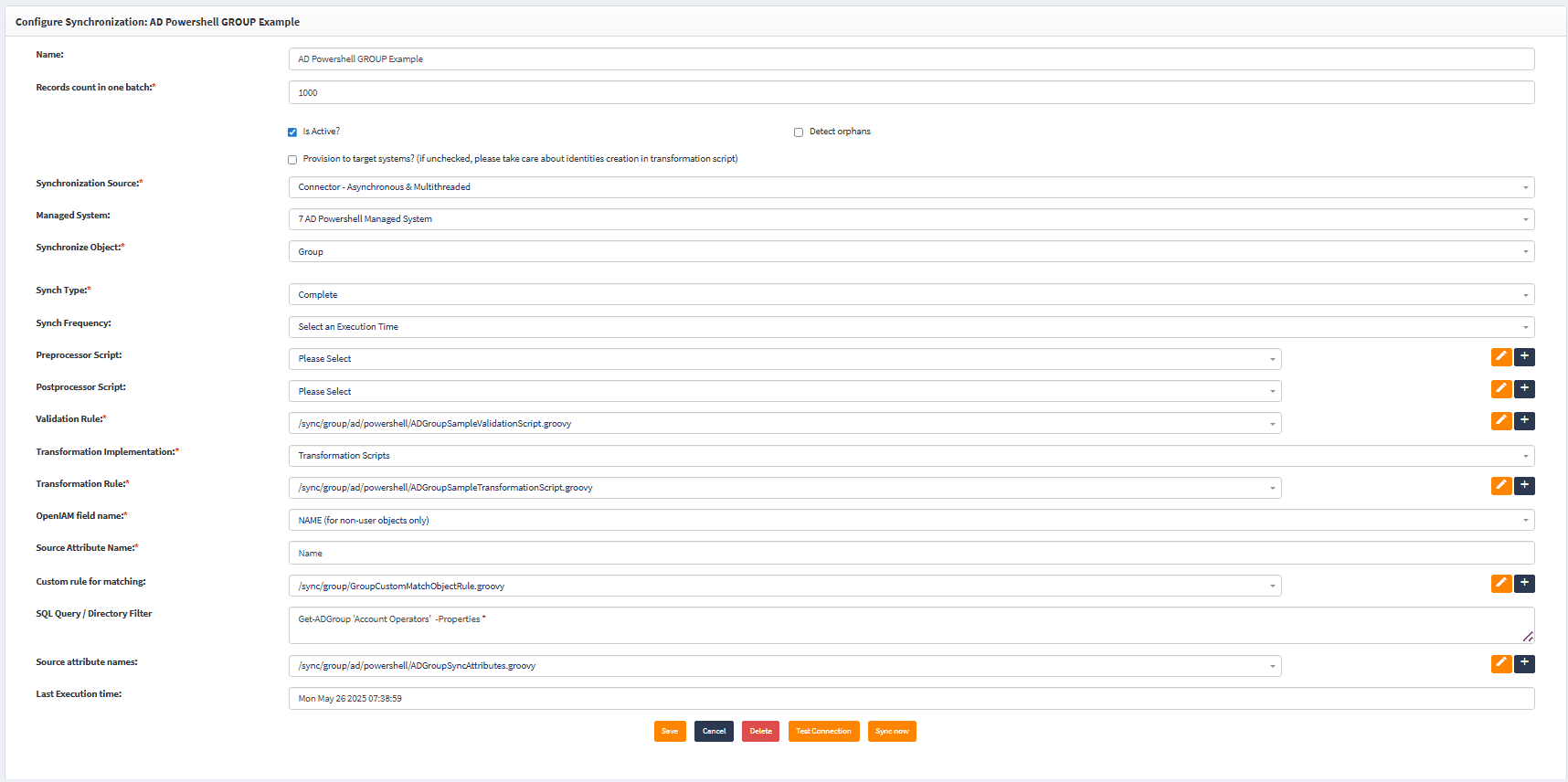

There may be cases where you need to synchronize objects that have the same name, but belong to different managed systems. A common example of this scenario is synchronizing groups that share identical names.
Matching group names
If synchronization is configured to match solely by name, the system will not be able to distinguish between the two groups and synchronization will fail. This is because, as of now, the synchronization engine does not support matching based on multiple fields directly.
To address this, you should use linked attributes, such as a combination of name and managed system, where the managed system acts as a unique identifier.
There is a custom matching script is provided to solve this issue - /sync/group/GroupCustomMatchObjectRule.groovy.
This script includes detailed comments explaining how it works. Specifically, it enables you to match group objects by their name in combination with their associated managed system, ensuring uniqueness.
To use this script select it from the list of available scripts in the Custom rule for matching field while configuring synchronization, as shown below. The code for it is also given below.

This approach allows accurate synchronization of objects with non-unique names across different managed systems.
