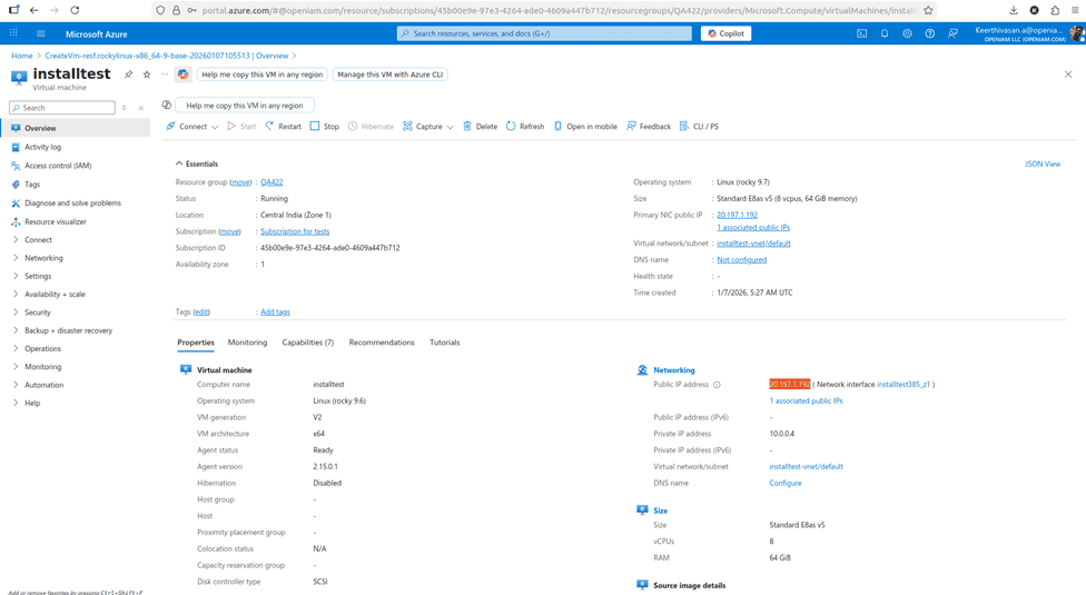

To install OpenIAM with a remote Oracle DB, prepare the DB first. Start with creating a VM in Azure.
Type Red hat in a search engine and select Red Hat Enterprise Linux (RHEL) RAW for Microsoft Azure > Red Hat Enterprise Linux 9.7 RAW with cloud-init or Rocky Linux and select Rocky Linux for x86_64 (AMD64) official > Rocky Linux 9.
