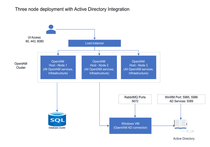

As indicated above, there are several deployment options when considering an HA configuration. A common high availability configuration used in mid-sized customers is the three-node cluster. Three-node clusters are a popular choice for HA configurations due to the performance and scalability benefits. For example, in the event of a node failure in a two-node cluster, the burden would shift to only one server which could potentially spike resource utilization on that node and throttle performance. Alternatively, during a server failure in a three-node cluster the burden would be split between the two remaining nodes and thus the stress on each server is diminished comparatively.
In this type of deployment, all the OpenIAM services and infrastructure are replicated on each of the three Linux hosts that make up the cluster. The database is external to these servers and can have its own cluster.
If integration to Active Directory or another Microsoft application is required, then a Windows VM should be used to host the connector. In this example, we use the Active Directory PowerShell connector.
Note: This diagram is limited to integration with one application using common ports. The list of ports can change if integration with other applications is required.
Three-node cluster diagram
