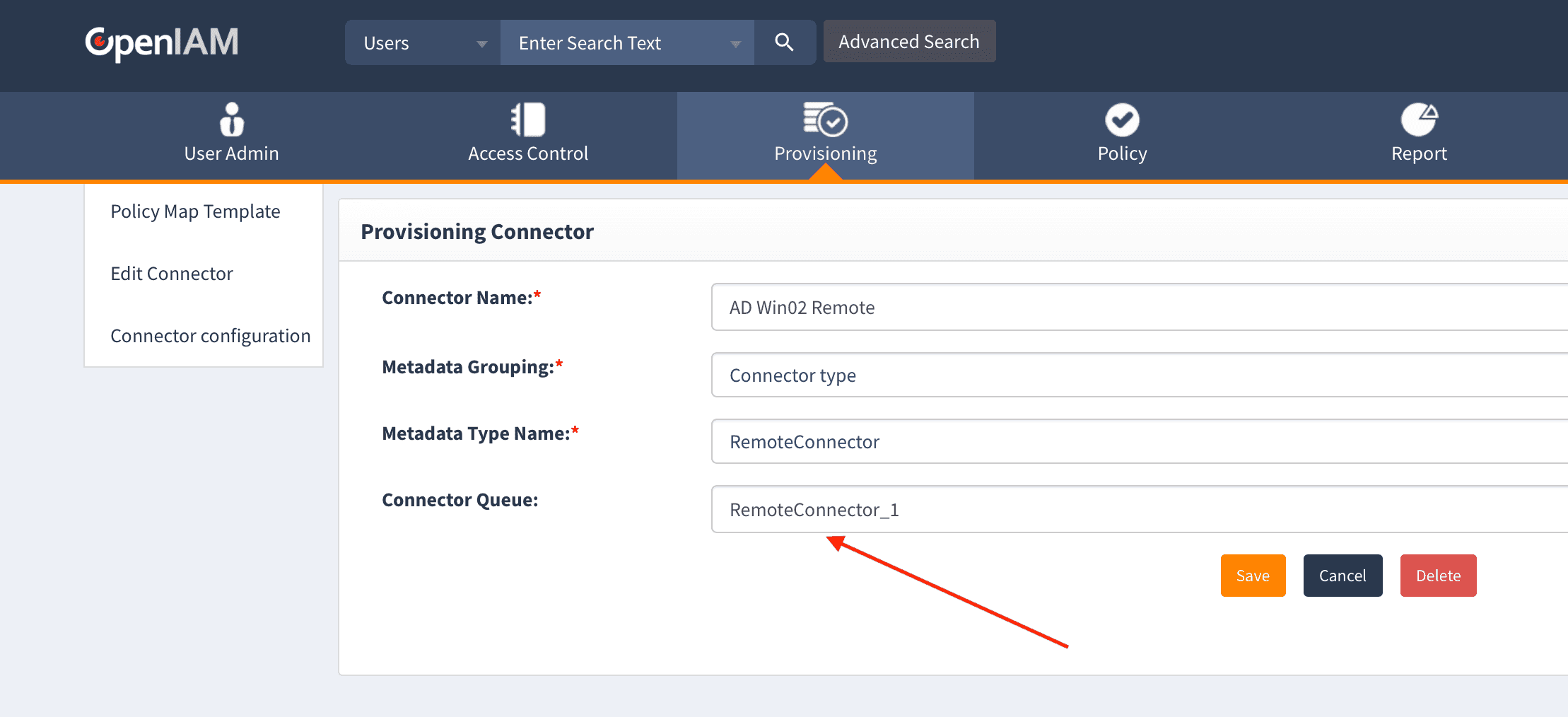

To get the queue name to specify during the installation process you need to log in to your OpenIAM webconsole > Provisioning > Connectors > Select your connector > copy Connector queue parameter from this page, as shown on the image below.
Getting RabbitMQ queue from webconsole

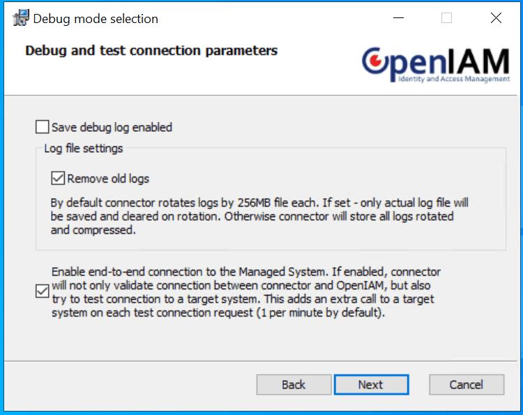

You will be asked to configure log settings. If you are installing the connector for the first time you may want to set debug mode on to be able to track what is happening on the connector side when you run requests from OpenIAM.
If debug mode is disabled only information and error messages will appear in logs. Normally it will be just one record per request indicating that the request was processed. Hence, if it is not running in debug mode the connector does not consume much disk space. However, in debug mode the log records amount significantly grows.
If you select the Remove old logs option, the connector will automatically delete rotated log records.

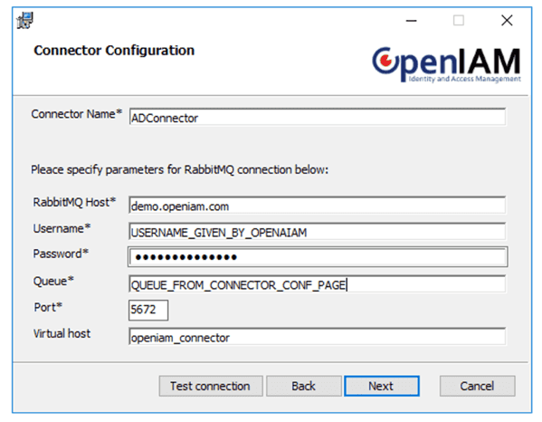

After clicking Next you will be asked to configure the RabbitMQ connection to your OpenIAM instance.
PowerShell connector RabbitMQ configuration
  • Connector name: this parameter is used for distinguishing this connector among other connectors of different types installed on the same machine. It is just a human-readable value that makes sense for you. It should not contain whitespaces however, because this name will be included to process names.
  • RabbitMQ host: usually hostname or IP address of your OpenIAM instance. However, in different scenarios this may vary.
  • Username: RabbitMQ connection username. By default: openiam.
  • Password: RabbitMQ connection password. By default: Password#51, however, this is usually changed after initial configuration.
  • Queue: this parameter should be taken from the connector configuration page inside OpenIAM. It is described above.
  • Port: by default 5672. However, this could be overridden by your configuration. Please make sure that this port is opened on the OpenIAM instance and the RabbitMQ service that listens to it. If you are running a Docker installation - please make sure that the port could be reached in Docker as well.
  • Virtual host: by default, it is openiam_connector.
To be sure that you have specified RabbitMQ settings correctly please press the Test connection button. Please note that Test connection just tests connection to RabbitMQ itself - address, port, username and password, and it cannot verify if your queue is correctly set (because different connectors can use different queues). Please make sure that you have specified the queue parameter correctly, because this is a frequently made mistake during the installation according to our feedback.

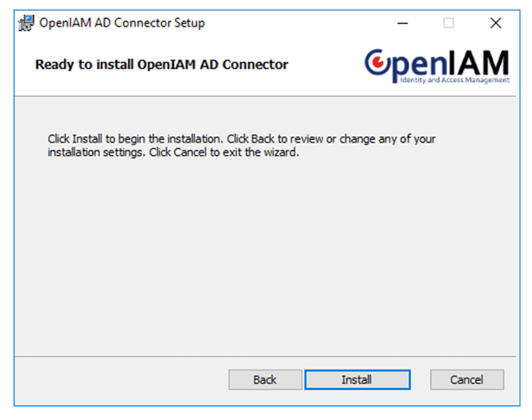

After having done the above you can confirm your installation by pressing Install. This will finalize your connector installation.

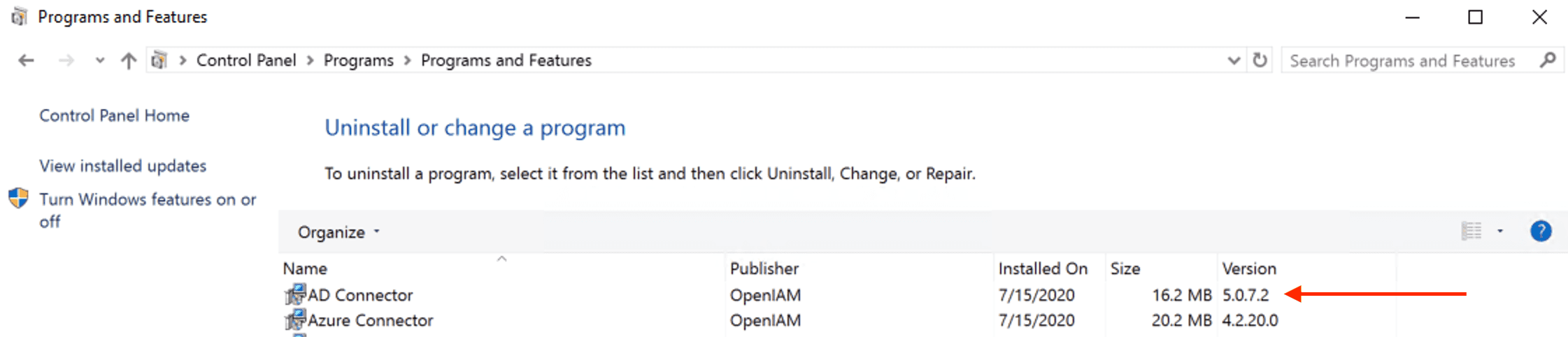

To check the connector version, you should go to Control panel > Uninstall a program. You will see the connector version at the same line where you see the connector as shown in the image below.
