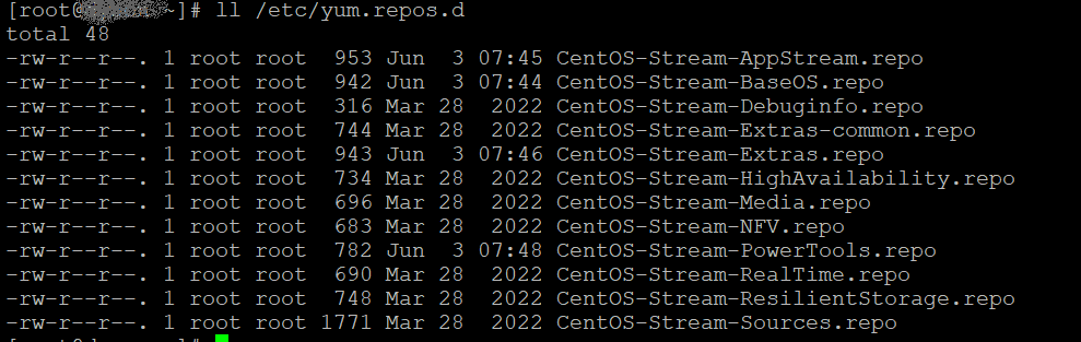

The last possible cause of this might be the extra repository present not letting tar to get installed, the repository was in /etc/yum.repos.d and named the Extras-common.repo.
Extra repo
After removing it, tar can be successfully installed. After installing tar successfully, we can proceed with OpenIAM installation further a noted in the installation instructions.
