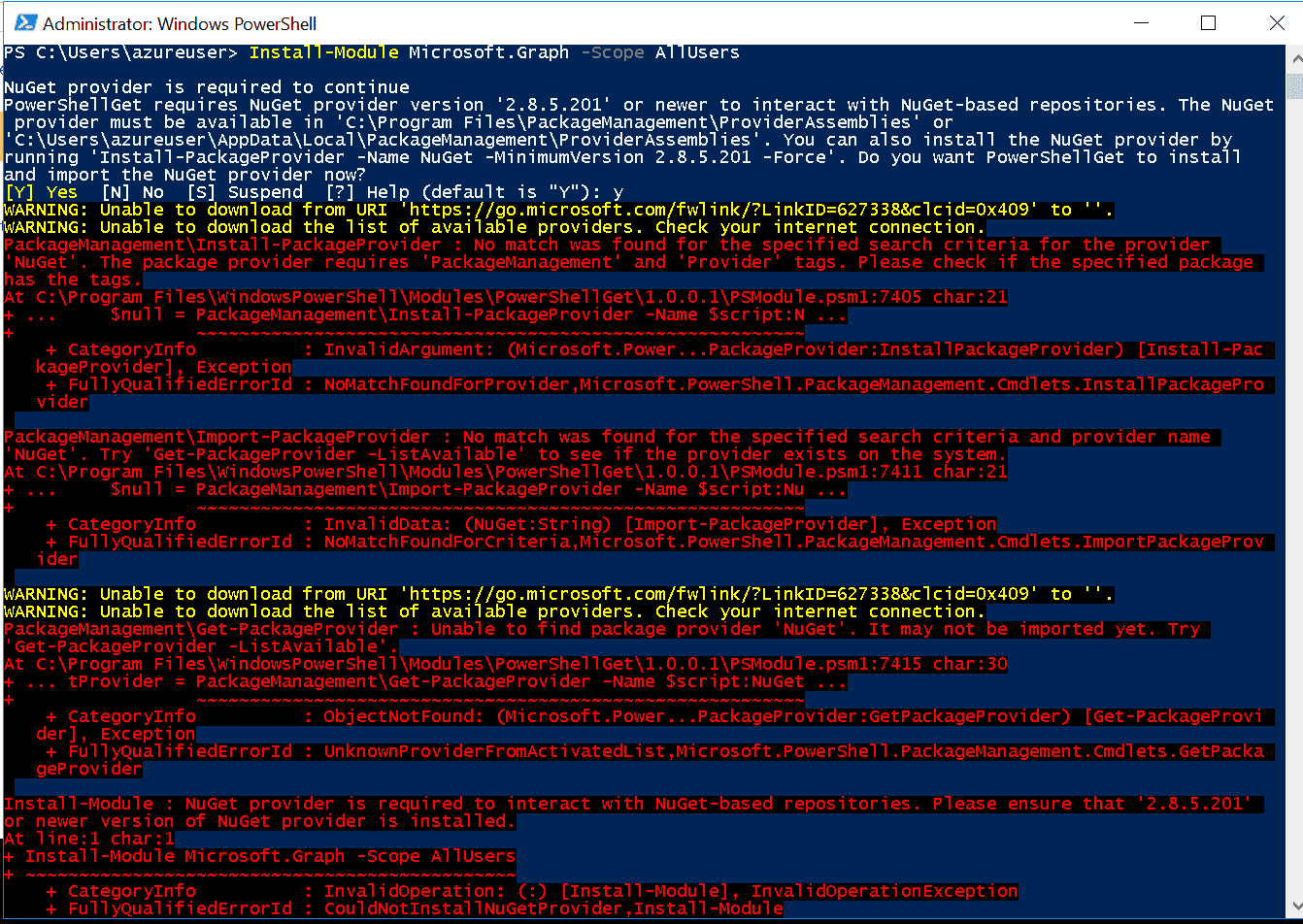

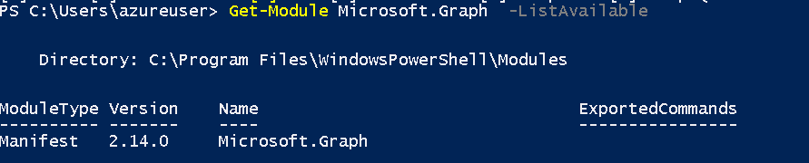

Step-2: Installing Microsoft Graph PowerShell module
Command response
Connector version
Troubleshooting tip #1
Error
[System.Net.ServicePointManager]::SecurityProtocol =
[System.Net.SecurityProtocolType]::Tls12

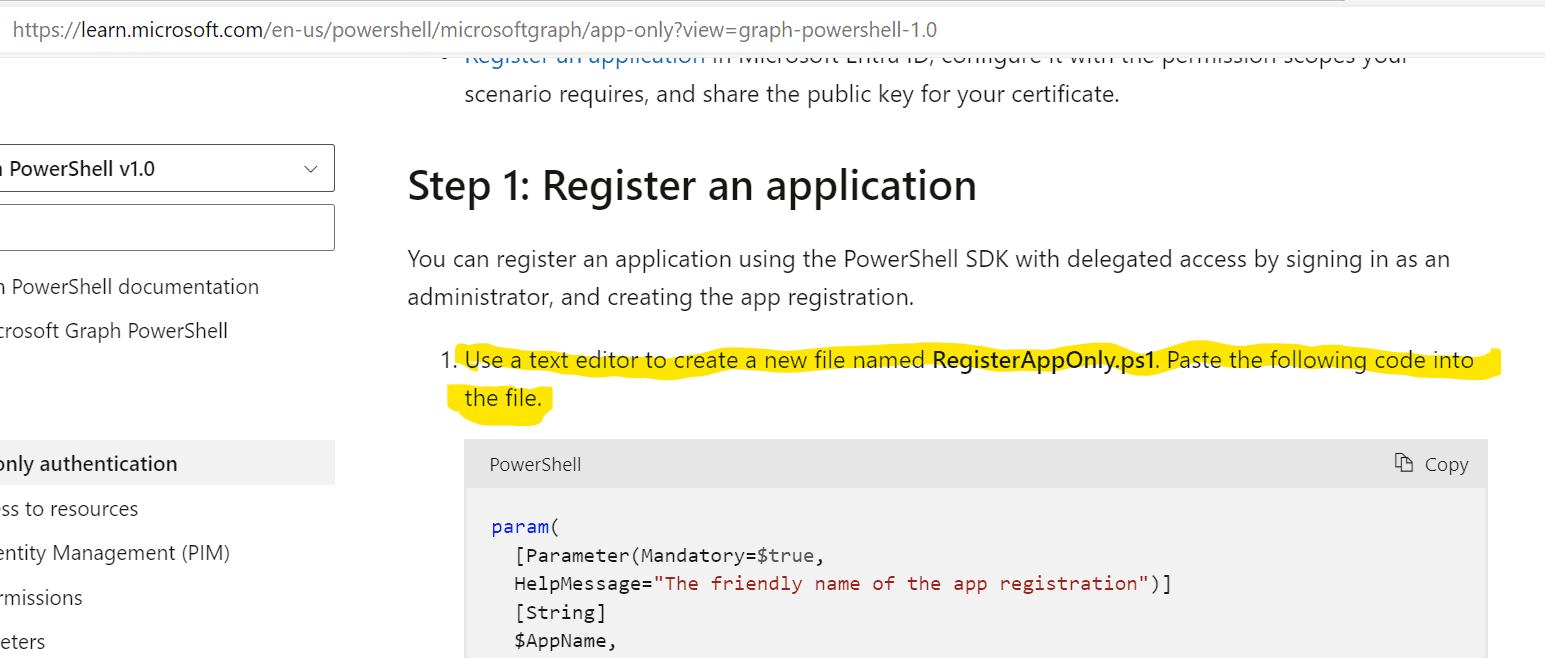

Step-3: Registering connector application in Azure
Microsoft Graph PowerShell module is designed to be used either by end users in the interactive mode or automated scripts/applications. In this case OpenIAM connector is a standalone application and should be registered as such inside Azure tenant. Unlike several older Microsoft PowerShell modules for Azure where it was enough to authenticate using just username and password, this module (while running in app-only mode) requires a bit more complex steps that include certificate generation and application registration. Despite some one-time configuration efforts, this approach is a lot more secure.

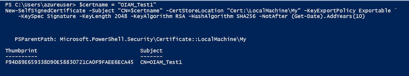

3.1 Generating application certificate
$certname = "OIAM_Test1" #Give your certificate name
New-SelfSignedCertificate -Subject "CN=$certname" -CertStoreLocation
"Cert:\LocalMachine\My" -KeyExportPolicy Exportable -KeySpec Signature -KeyLength 2048 -
KeyAlgorithm RSA -HashAlgorithm SHA256 -NotAfter (Get-Date).AddYears(10)
Certificate created

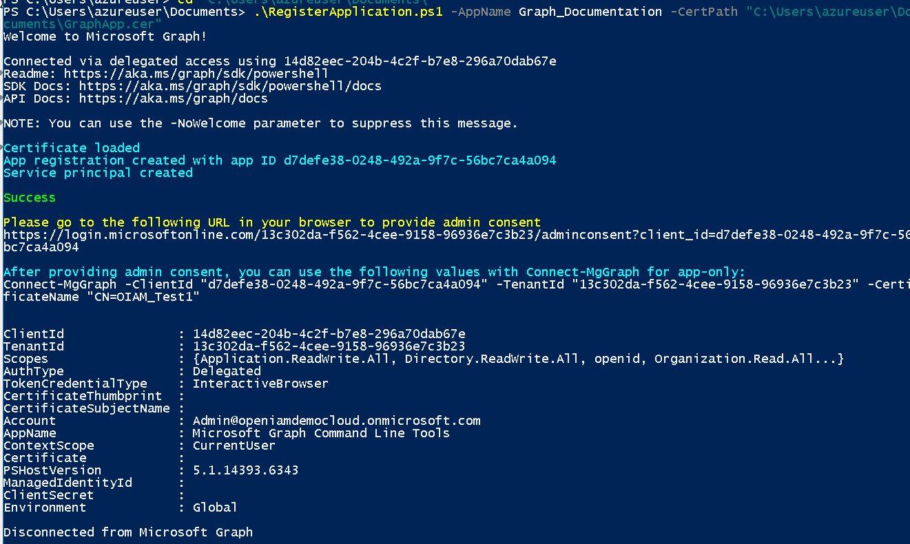

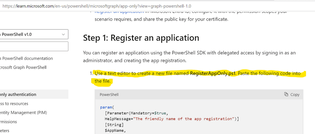

3.2 Running registration script
Registering
Exporting Exporting2
After specifying those parameters, the script will open a browser window for authentication. You should have sufficient permissions to register applications inside your Azure tenant. If everything is fine you will see the summary of registration similarly as below.

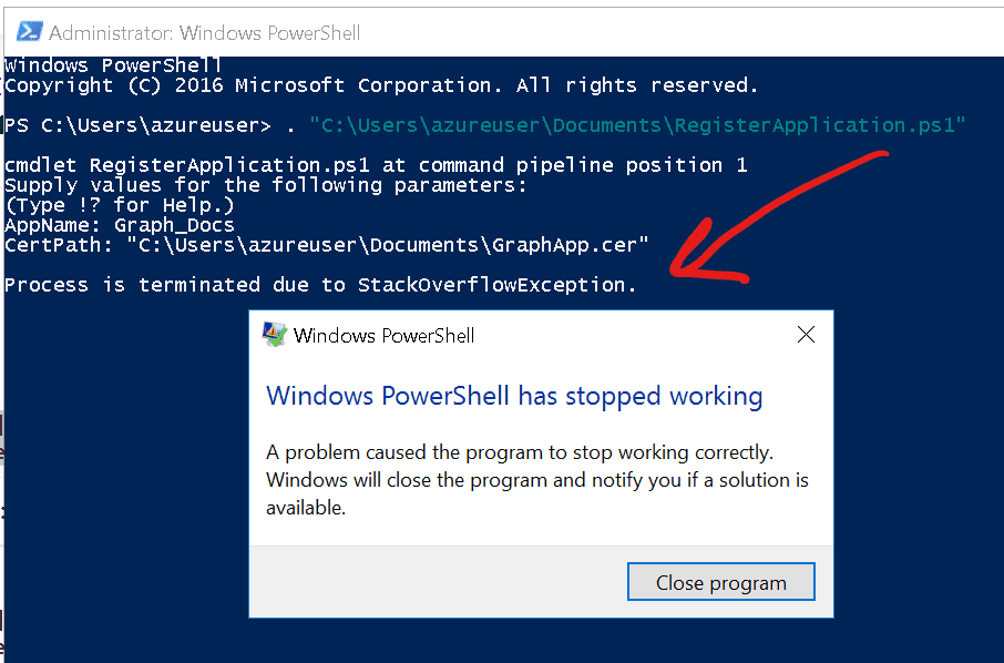

Error

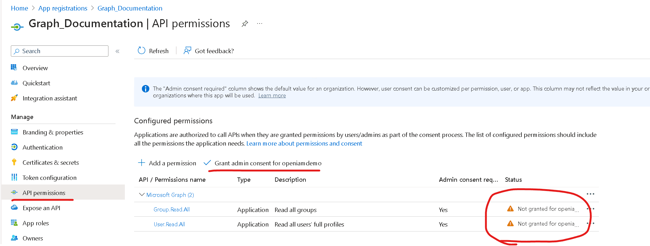

Step-4: Granting admin consent and adjusting application permissions
4.1 Granting admin consent

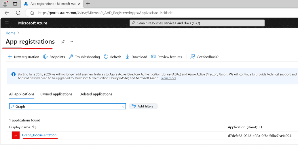

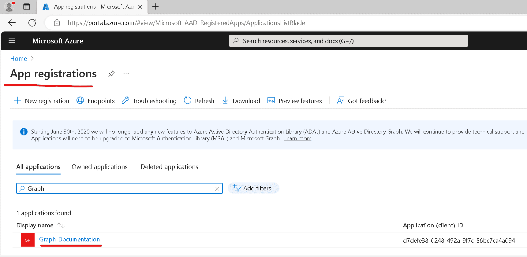

Apps registration
API permissions
As it can be seen from the above image, your application is not granted consent by default, so to make it operational you need to press on Grant admin consent for openiamdemo. Once you do it, your application (and connector) would be able to perform operations listed in API permissions.

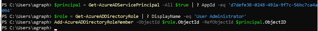

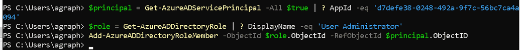

Unfortunately, not all permissions can be set directly through API permissions page. There is no way to grant permission for your application for resetting user password using that page. By default only applications that run in interactive mode can do that. However, there is a workaround. You can grant your application a User Administrator object role. If you would like to do this you can use Add-AzureADDirectoryRoleMember cmdlet from the AzureAD PowerShell module. To use it make sure that AzureAD module is installed.
Install-Module “AzureAD”
When module is installed, run
Connect-AzureAD
Get ID
Example

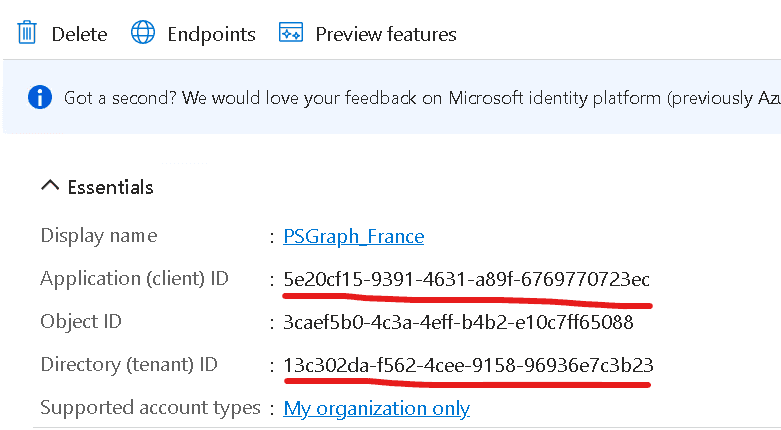

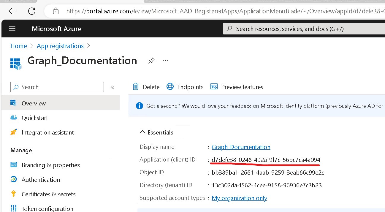

  • Application (client) ID. It goes to the Login ID property on the OpenIAM configuration page.
  • Directory (tenant) ID. It should be inserted into the Host URL property field.
IDs

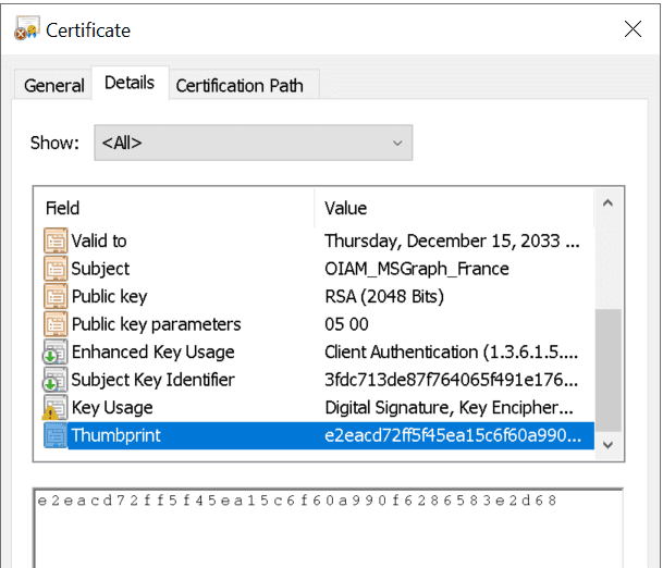

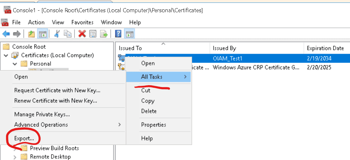

  • Certificate Thumbprint, generated on step #3.1. It could be taken from MMC > Certificate Snap-in > Local Computer certificates > Personal > your certificate. This should go to the Password property
Certificate thumbprint

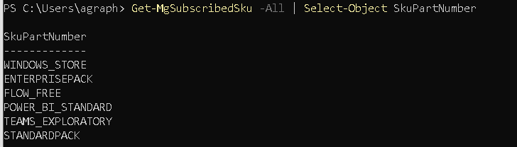

Connect-MgGraph -Scope User.ReadWrite.All, Directory.ReadWrite.All
Get-MgSubscribedSku -All | Select-Object SkuPartNumber
License

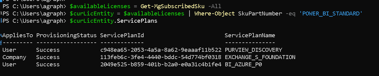

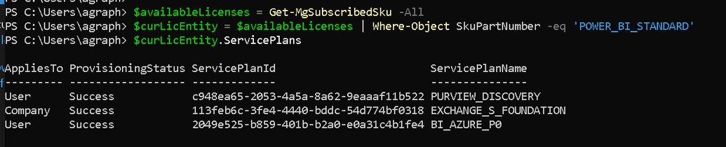

$availableLicenses = Get-MgSubscribedSku -All
$curLicEntity = $availableLicenses | Where-Object SkuPartNumber -eq 'POWER_BI_STANDARD'
$curLicEntity.ServicePlans
License package included
{"LicenseName":"POWER_BI_STANDARD","DisabledPlans":["PURVIEW_DISCOVERY"]} => with operation code 'Add'
