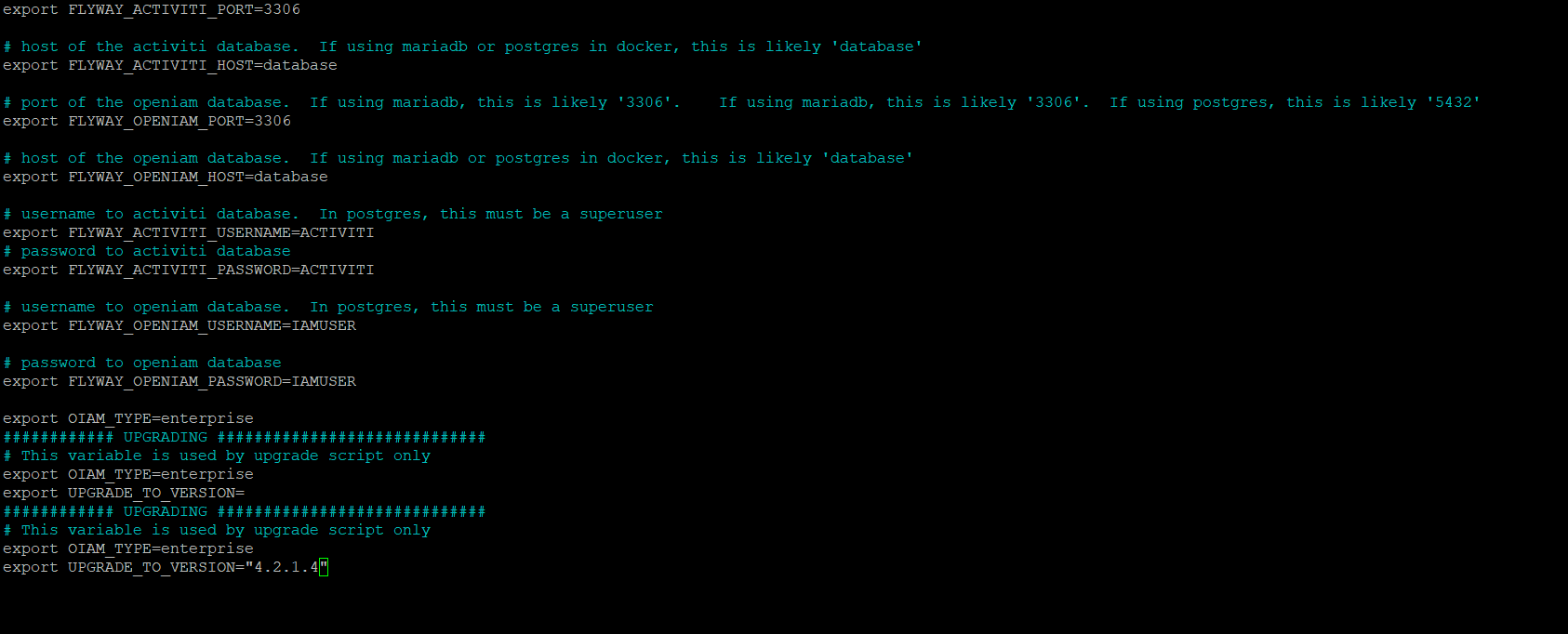

Add the below mentioned lines in the new env.conf if missing.
########################## UPGRADING #############################
# This variable is used by upgrade script only
export UPGRADE_TO_VERSION=""
Define the value for export UPGRADE_TO_VERSION="4.2.1.5"

Note: If you are using out-of-the-box configurations for the database, replace the value for the following parameters:
export FLYWAY_ACTIVITI_HOST=database
export FLYWAY_OPENIAM_HOST=database
Replace “database” with localhost. After replacing it, it should look like this.
# host of the activiti database.
export FLYWAY_ACTIVITI_HOST=localhost
**host of the openiam database.**
export FLYWAY_OPENIAM_HOST=localhost

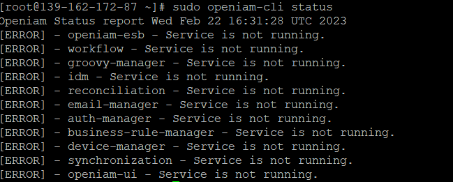

  1. After making the changes, check the services and stop them if they are running.
sudo openiam-cli status
sudo openiam-cli stop
Make sure all the services are stopped. Services stopped

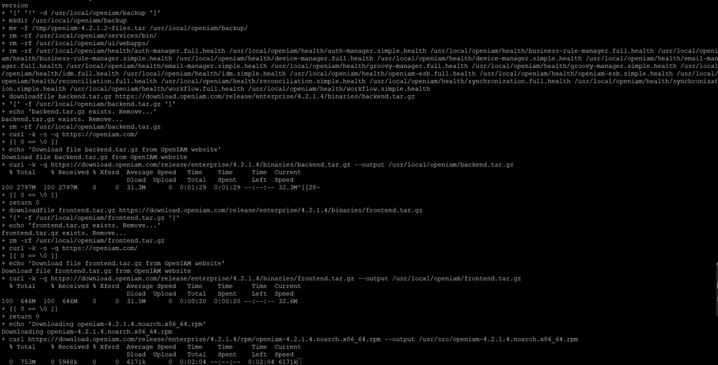

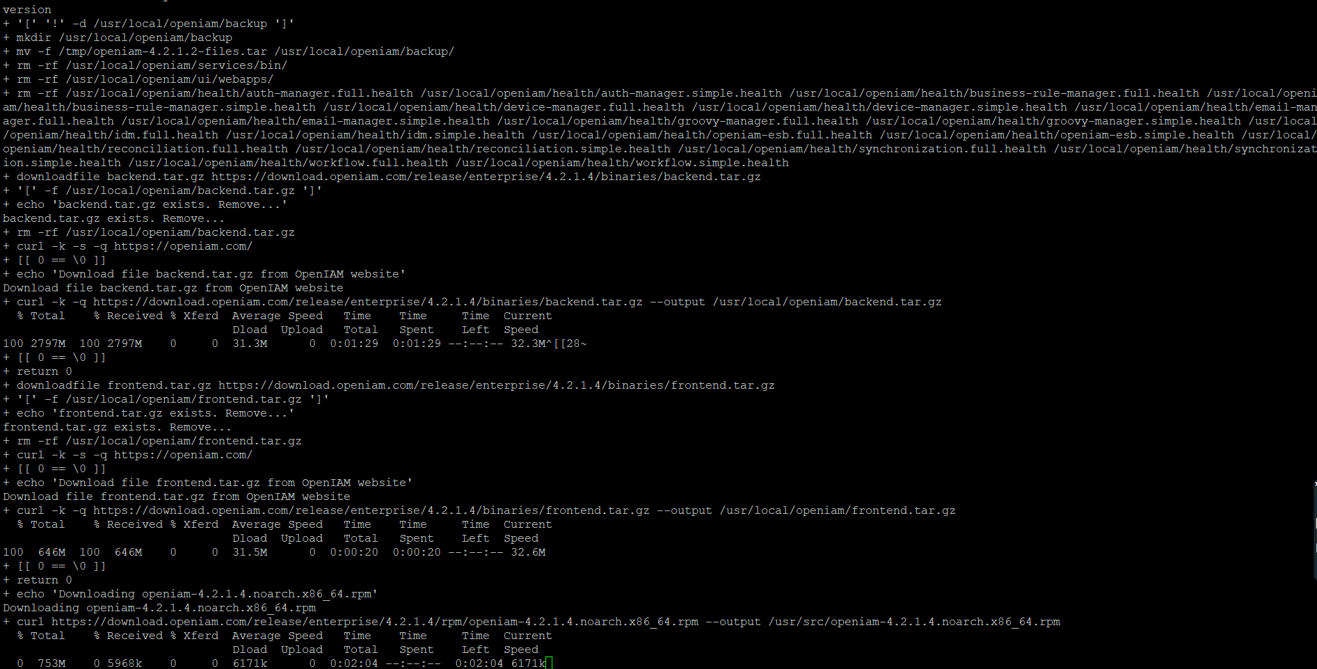

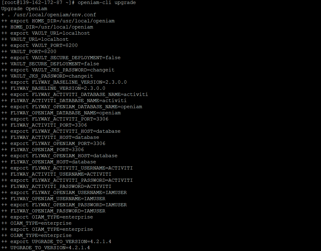

  1. Run the upgrade command.
sudo openiam-cli upgrade
The output must look as follows: Upgrade command output

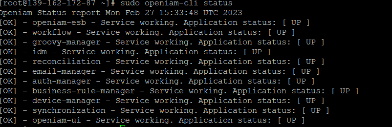

  1. Check all the services are up and running.
Services up and running
