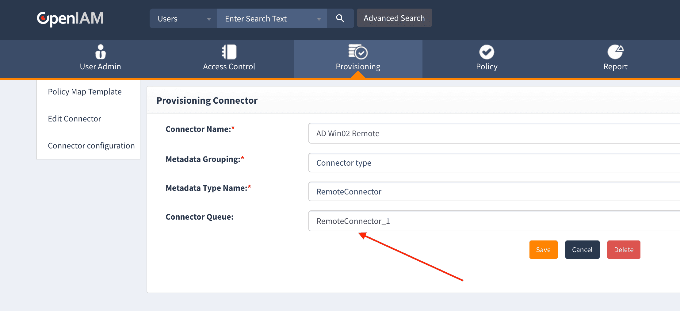

To get the queue name to specify during the installation process you need to log in to your OpenIAM webconsole -> Provisioning -> Connectors -> Select your connector -> copy 'Connector queue' parameter from this page, as shown on the image below.
Getting RabbitMQ queue from webconsole

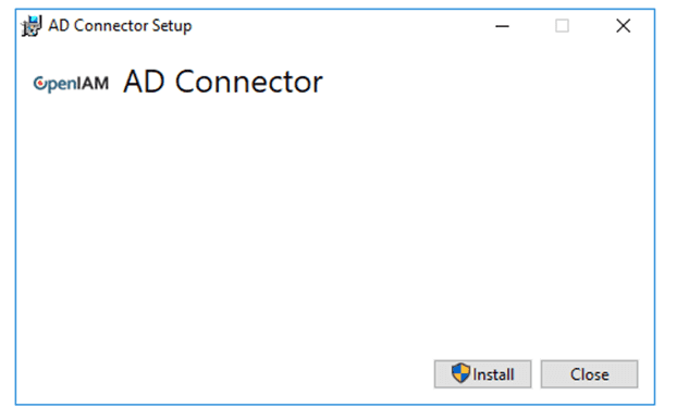

The screenshot below demonstrates the initial connector installation window.
Initial PowerShell connector installation window
When you press Install, the installer will check for the SQL CE 4.0 SP1 dependency. If the dependency is not found during installation, then the installer will install SQL CE 4.0 SP1. If it is present, then the installer will skip this step and proceed with the installation.

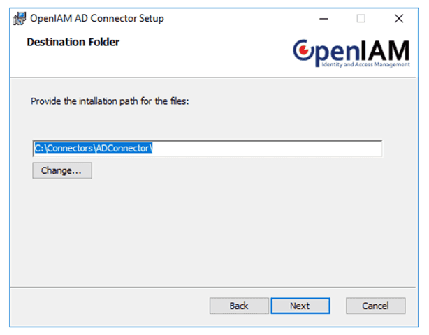

PowerShell connector destination folder selection
During the installation step above, you will be asked to provide the connector installation location. By default it is C:\Connectors\ConnectorName. However, you may want to override it.

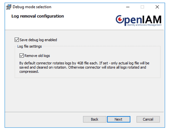

PowerShell connector log configuration screen
You will be asked to configure log settings. If you are installing the connector for the first time you may want to set debug mode on to be able to track what is happening on the connector side when you run requests from OpenIAM.
If debug mode is disabled only information and error messages will appear in logs. Normally it will be just one record per request indicating that the request was processed. So if it is not running in debug mode the connector does not consume much disk space. However, in debug mode the log records amount significantly grows.
If you select the Remove old logs option, the connector will automatically delete rotated log records.

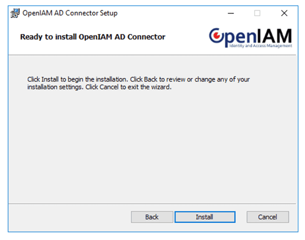

After having done the above you can confirm your installation by pressing Install. This will finalize your connector installation.

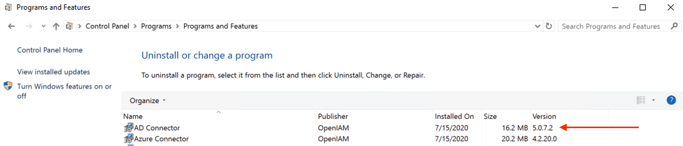

To check the connector version you should go to Control panel -> Uninstall a program. You will see the connector version at the same line where you see the connector as shown in the image below.
Checking PowerShell connector version

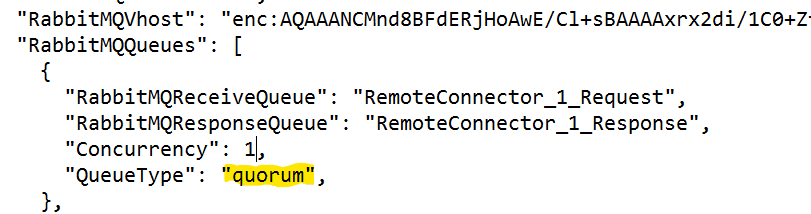

RabbitMQ QueueType
Starting from version 4.2.1.9? OpenIAM uses 'quorum' QueueType for RabbitMQ communication that involves communication with connectors.
.NET/PS connectors use this value by default starting from 5.31.0.0 version and higher. However, this parameter was made configurable on a connector side to retain backward compatibility, so if anyone would need to use any .NET/PS connector of 5.31.0.0 version of higher with any OpenIAM version below 4.2.1.9, it is possible to open Connector.config inside connector folder and edit QueueType parameter by changing quorum type to classic.
QueueType parameter
Troubleshooting: checking that connector QueueType parameter inside Connector.config matches the one that exists on RabbitMQ side.
