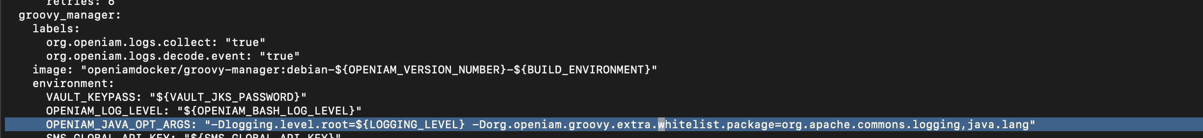

Due to security reasons, the java.io package is not whitelisted for imports (you cannot directly instantiate classes from this package in Groovy). To resolve this, add the following property...
-Dorg.openiam.groovy.extra.whitelist.package=java.io
... to the configuration files for Groovy Manager and ESB as follows.
For Docker, modify the following.
_openiam-docker-compose/3.2/services/docker-compose.yaml_
For RPM, modify the following.
/etc/systemd/system/openiam-groovy.service/etc/systemd/system/openiam-esb.service
For example, for RPM:
ExecStart=/usr/local/openiam/services/start.sh groovy-manager "-Xmx512m -Djdk.tls.client.protocols=TLSv1.2-Dorg.openiam.groovy.extra.whitelist.package=java.io"
