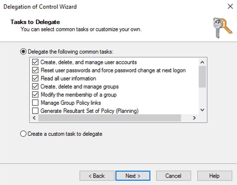

As an example, you can use Delegation control to give your service account permissions for a given OU. To do this you can select your OU inside ADUC (Active Directory Users and Computers) by right clicking and picking the Delegation control wizard like shown below.

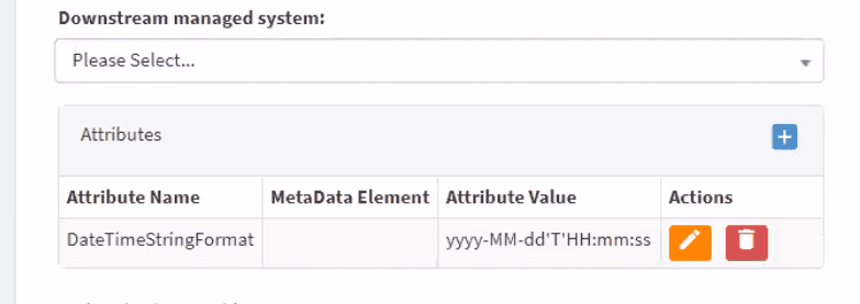

Incremental sync of users or groups
When you run incremental sync, OpenIAM relies on the time of last user/group modification in AD. Each user or group in AD has a property that is updated each time the object is modified. In the PowerShell connector you can use 'Mdified' property to address that value.
When you run synchronization, you can use the following query to get objects that are modified later than a certain date:
Get-AdGroup -Filter "Modified -gt '$((Get-Date '?').ToUniversalTime())'"
In this example OpenIAM will replace '?' with a real value during runtime and send a modified string to the connector.
Additionally, OpenIAM should send information about the time format that it should receive from connector. We need this because OpenIAM and the connector run on different platforms and need agrement about how to treat DateTime strings. The format should be sent in request metadata and the parameter name should be 'DateTimeStringFormat'. You can use following format:
The above setting could be changed in the configuration of your Managed System.

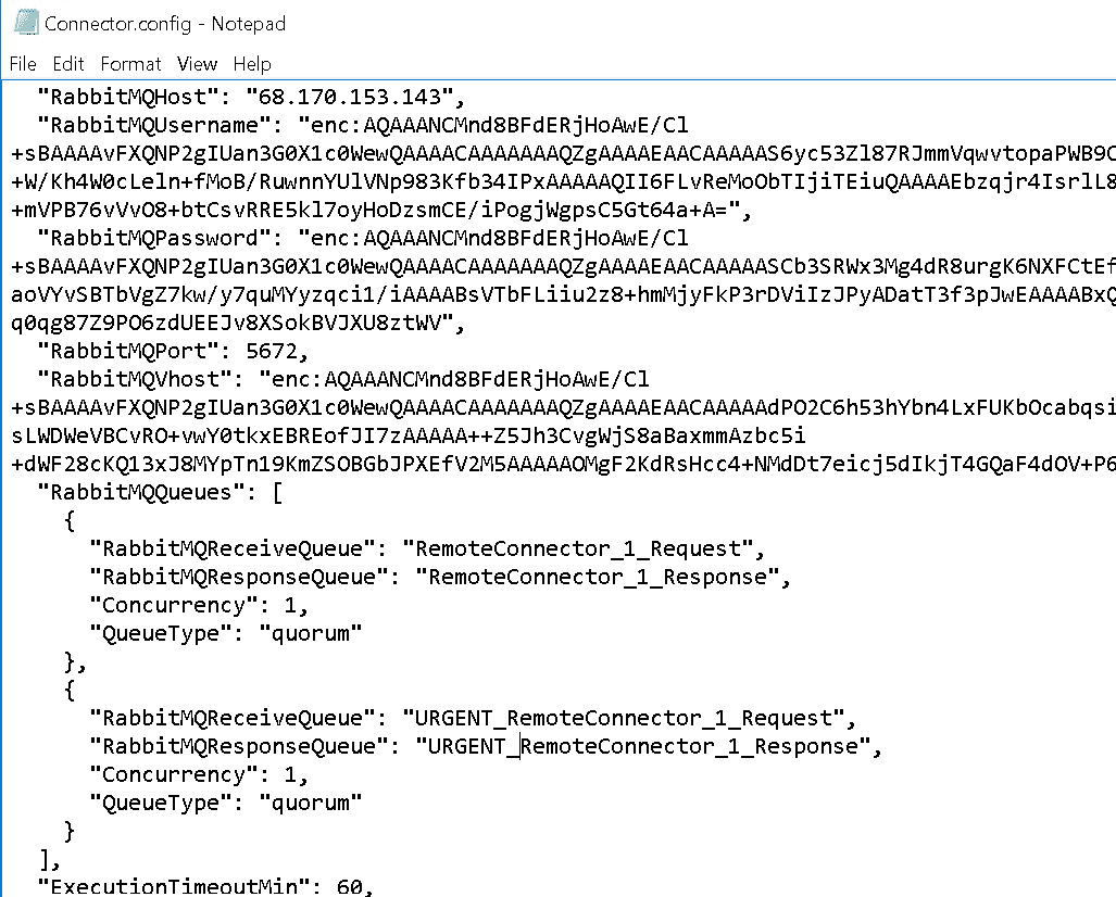

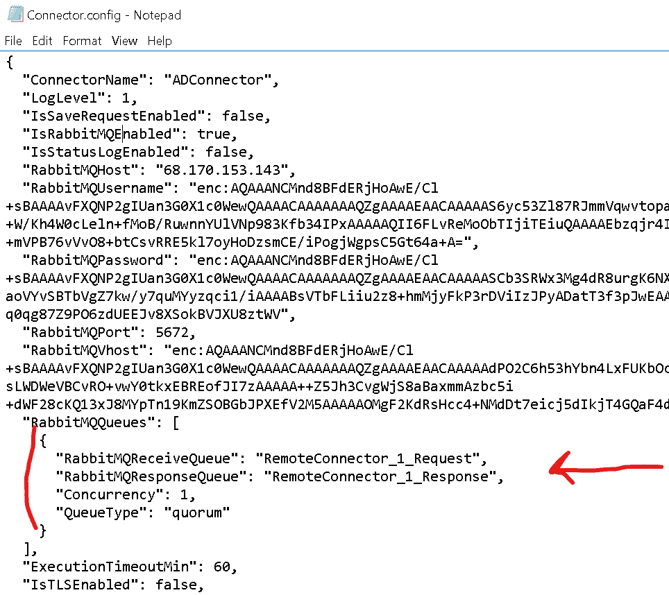

Urgent queues
A connector is responsible for transferring data between systems, between AD and OpenIAM in this case. If some messages require immediate processing, an urgent queue can be implemented to prioritize them over regular traffic. To add connection, follow the steps below.
- Open
Connector.configfile inside the connector folder on Windows machine and add a new record to"RabbbitMQQueues"array, as shown below.
It is possible just to duplicate that record but append 'URGENT_' to *ReceiveQueue and *ResponseQueue properties. So, configuration that supports urgent queues would look like one below.
concurrency values could be changed as needed for normal and the urgent queue separately.
