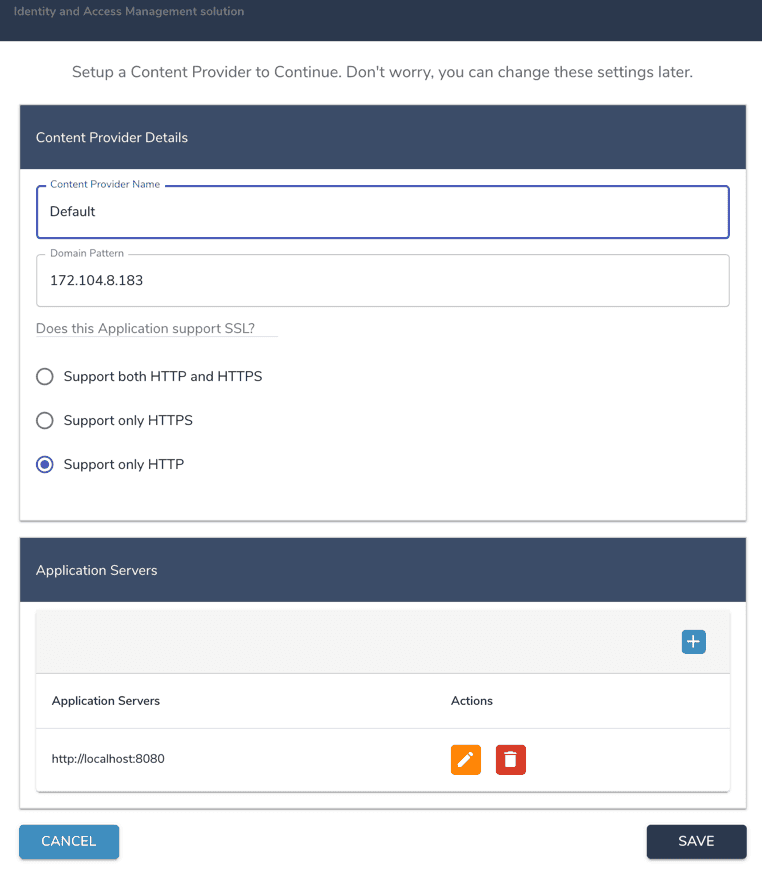

Use the following credentials for the first time login:
OpenIAM Login page .
After setting up the content provider, you will be taken to the challenge questions page. These questions will be used to reset your admin account in case you have locked yourself out. Please make a note of your answers.
After completing the above steps, you will be taken to the admin console landing page shown below. Give the system about 5 min to refresh the internal cache and then you can proceed to configure your solution.
