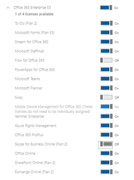

Working with license parameters
Connector is capable of setting any subset of licenses inside the global plan. For example:
Connector can assign whole license pack (like E1, E3 etc.) and also supports partial licensing (for example, assigning E1 with some features disabled).
Handling license assignment - OpenIAM sends licenses information in 'Licenses'. This is multi-value attribute (like Groups), so one user could be assigned multiple licenses. License record format:
{"LicenseSku":"O365_BUSINESS_PREMIUM","DisabledFeatures":"YAMMER_ENTERPRISE,MYANALYTICS_P2,BPOS_S_TODO_1"}
In example above we will assign user O365_BUSINESS_PREMIUM license, however, YAMMER_ENTERPRISE, MYANALYTICS_P2 and BPOS_S_TODO_1 services would be disabled for this user.
