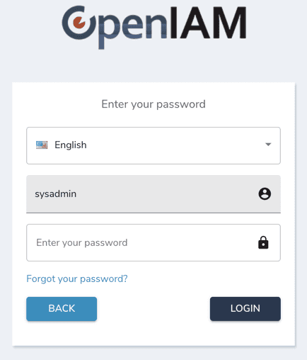

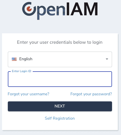

The final validation of our deployment is to be able to login to the OpenIAM web applications. To do this, you must first find the IP address of our VM. Next open your browser (preferably Chrome or Firefox), and hit: http://[ip address of your installation ]/webconsole Use the following credentials for the first time login: Username: sysadmin Password: passwd00
Enter the username on the field shown below and click Next OpenIAM Login page .
The authentication process is spread over two screens. You will be asked to enter the password on the screen below. Change password

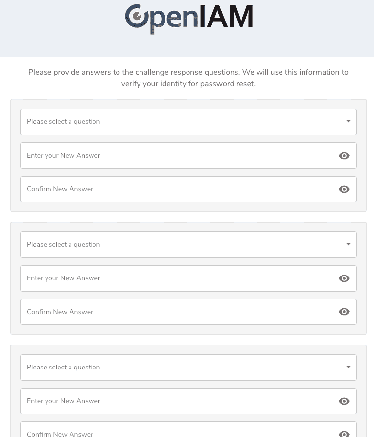

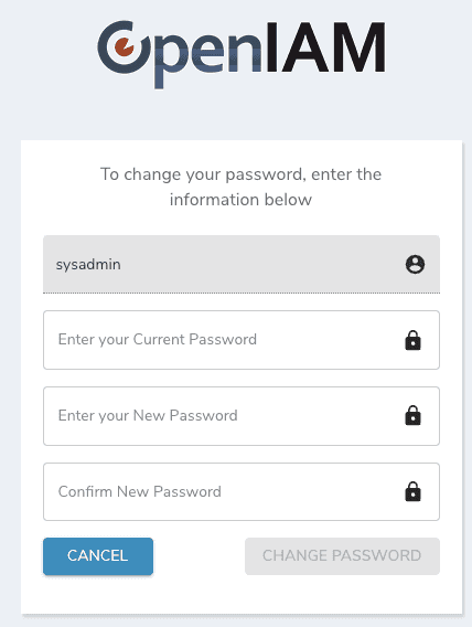

The next screen will force you to change the default password. As you enter your new password, you will see the password policy on the side. Your password must align with this policy. You will be able to change both the password and the policy later. Change password

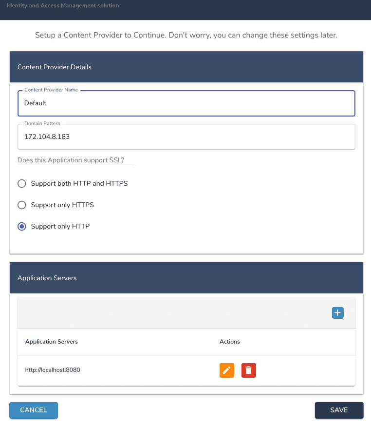

Define initial content provider After setting up the content provider, you will be taken to the challenge questions page. These questions will be used to reset your admin account in case you have locked yourself out. Please make a note of your answers.

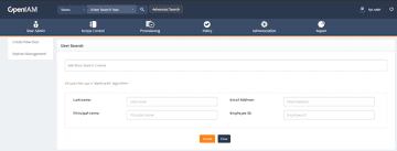

After completing the above steps, you will be taken to the admin console landing page shown below. Give the system about 5 min to refresh the internal cache and then you can proceed to configure your solution. Webconsole landing page

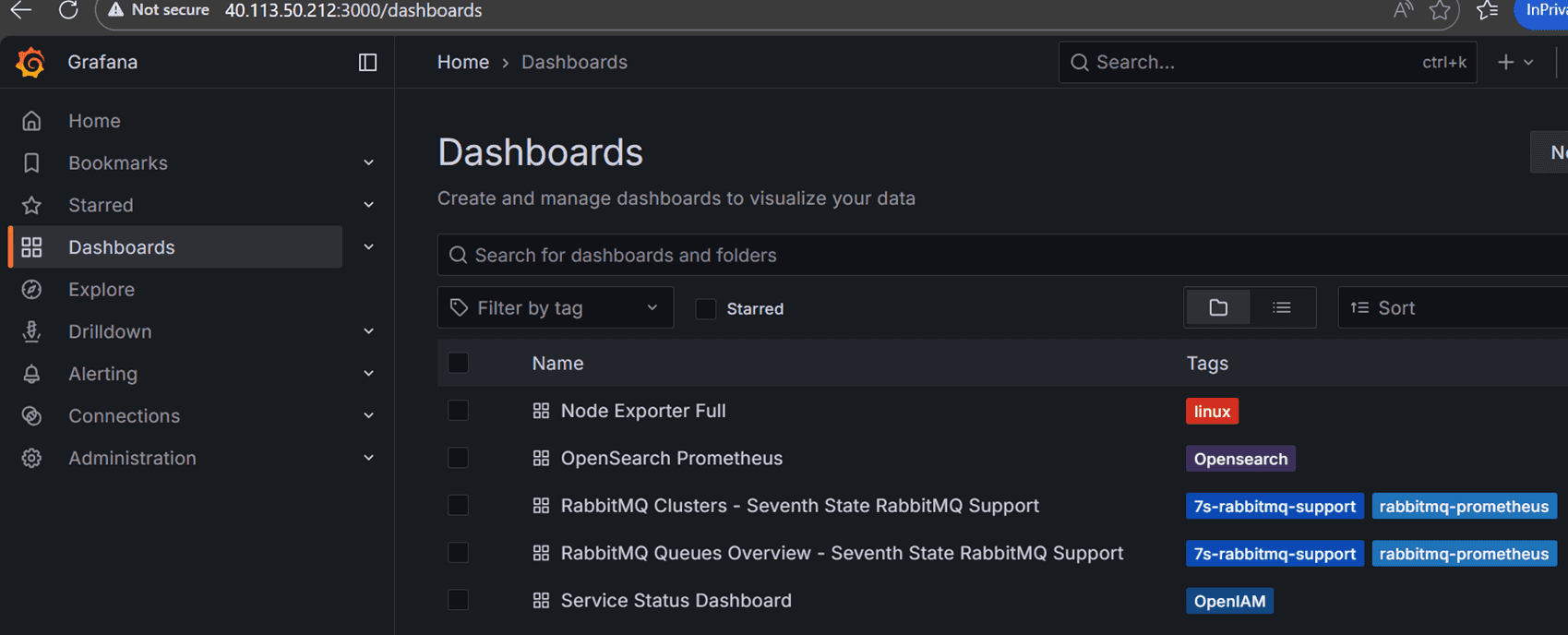

For Grafana access from outside using public IP
For Grafana access, default user will be admin and password will be admin.
http://<Ip of VM>:3000
Grafana dashboard

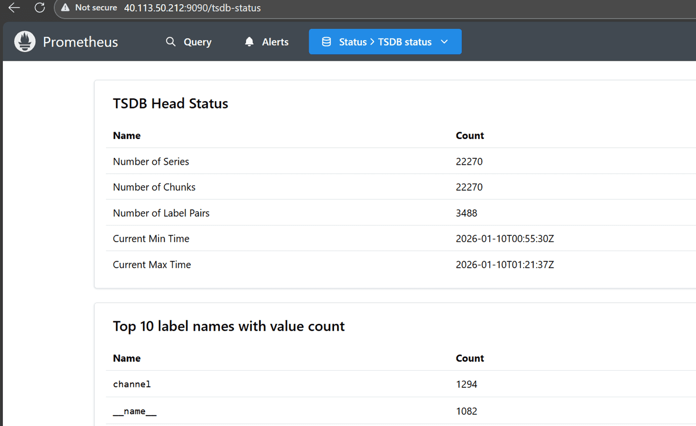

Try to access using the http://<Ip of VM>:9090 URL. Prometheus

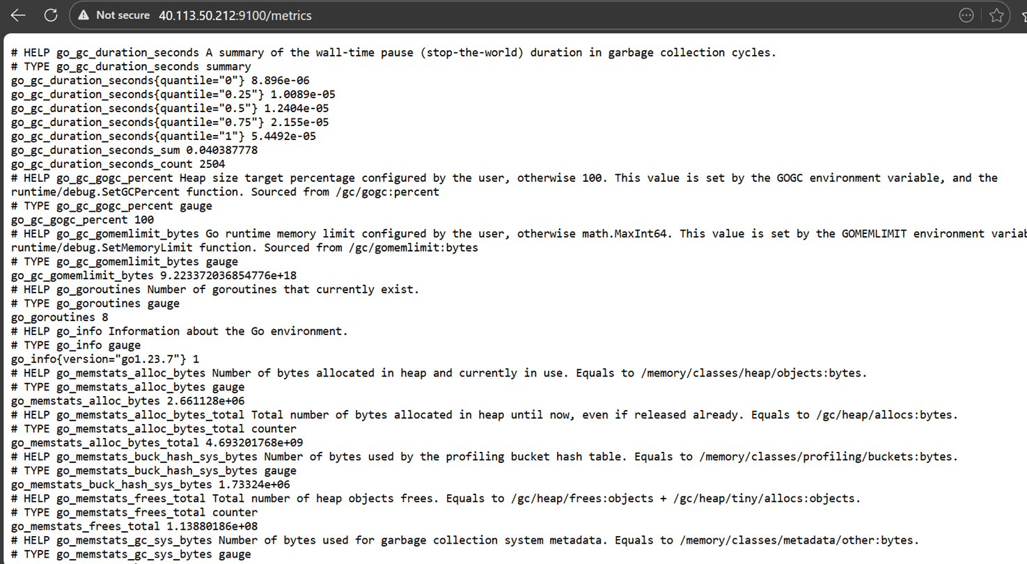

For node exporter metrics access
Use the http://<Ip of VM>:9100/metrics URL for the access. Node exporter access
